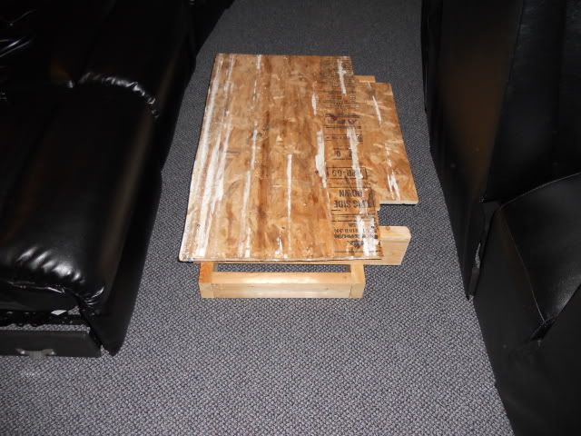

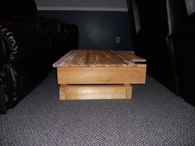

Great minds think alike. Here is what I did yesterday when Mrs RTROSE was home to be my Guinea pig. I'm glad I did the trial and error as I would have build the riser way too short. I was going with a 6" riser but I actually need a 10" riser.
My "test" riser.
Mrs. RTROSE was very concerned about my construction technique regarding the temp riser. To prove she would be safe I scaled the chair and riser combo, it creaked and groaned under the immense weight, bowed slightly but held its own. After being convinced she would not perish in a fall from the great height of 9 1/2" she became a willing participant to the riser height experiment.

Oh great more math. I hate math. I have to be very careful to how high I go with the riser as my ceiling is only 7' 9" Even if 11" was ideal I don't know if I could go that high. 10" is going to be my max I believe. Plus do to excellent planning on my part the projector will be hanging down in the "walk way" of the riser. I could possibly move the projector back, but don't want to do that unless it is absolutely necessary.
Putting the plywood on the bottom to spread the load is a great idea, I had thought about putting plastic or landscape fabric on the underside to help protect the carpet but doing the plywood would serve two purposes. I will just have to steal that idea for sure.
I had already planned on doing some type of acoustical treatments to the room, but as you point out with a rather large opening on the right side of the theater I'm fighting an uphill battle, and that opening is one of the main reasons why I did not go full bore on trying to do any sound isolation.

The link I provided actually does most of the math for you, but you will have to do some minor volume calculations. But there are probably bigger fish to fry with tweaking your theater setup.
I would not, under any circumstance, use 2x4s as supporting joists. They are just too weak. If you like the idea of plywood on the bottom of the riser and staying within 10" of height, then I would propose using a base layer of 3/4" plywood, use only 2x8s for the perimeter and joists, then cap with 2 layers of 3/4" plywood. This will get you to 9 3/4" on top of your carpet height. Fill the riser completely with R25 batt insulation. Simple, easy, strong and will give you a great foundation for your seating. The one additional suggestion I would mention is to definitely build and attach a step 1/2 the height of your riser at both entry points to the elevated seating.

That sounds fine, but an observation: the 2x8s were going to be useful to allow all the joist cavities to connect (since they wouldn't touch the floor below them), for acoustic purposes. If you're not going to open the sides to allow bass energy in, the only advantages are cost and weight. However, you'll still need joist hangers that you wouldn't need if they were all full depth. Of course, be also careful that everything is screwed with long enough screws and thoroughly so that nothing squeaks or shifts - I personally think long screws are totally adequate for your purposes, but some around here (you've probably noticed) have taken to using Green Glue or roofing felt between riser deck layers.

Thanks for your input. I'm clear on the joist hangers and adequate screws. I had planned on using construction adhesive as well as screws to eliminate the possibilities of squeaks and creeks. I just don't know if it will be helpful or not. If I were to open it up to accept sub frequencies what size holes are we talking "in theory"?

Well even if she is not convinced I know what I'm doing, she is convinced YOU GUYS do.
Another point, if I am going 2 x 10 all the way around and as supports is there any real reason now to sheet the bottom in ply or OSB? My thought would be "no". Still open for suggestions.
RTROSE
post #1558 of 2037
If you have a lumber liquidators nearby, they sell stair nosings pretty cheap. The last time I bought some, they were quite a bit cheaper than either big blue or big orange.
They also have a lot of other flooring related odds and sods that you can't get from the big box stores.
post #1559 of 2037
As for decking the bottom of the riser I dont think there is any reason that would be necessary. The 2 that I have built did not have decking on the bottom. I assume it's personal preference. As for building it out of 2x10's I dont see any reason you need to also use 2x10s as cross bracing?! To save cost and to remove some weight from this monster I dont see why you couldnt go with 2x8s, 2x6s or even 2x4s hung from joist hangers?! My first riser was 2x6s with 2x4 cross bracing done this way and it was more than sturdy especially if you go with 2 layers of 3/4" decking on top. If you are concerned that it wont be strong enough to hold those chairs plus your weight then just move your cross bracing closer together, maybe go 12" centers or 10" if you are really nervous. I would not go 2x10s everywhere as those babies get pricey and heavy. Just my honest opinion.
And as far as your wife thinking "we know what we are doing" that may be a problem because my wife thinks that "you know what you are doing". I suppose we have them all fooled huh?!?! Life is 40% know how and 60%BS anyway. If you can sell them on your thoughts then you MUST be correct! Right?!
post #1560 of 2037
Having the bottom will distribute the weight so if the riser was removed, there wouldn't be the heavy lines of the joists imprinted into the carpet/padding - just a larger and generally flat area that can easily be fluffed up.
Your call.
