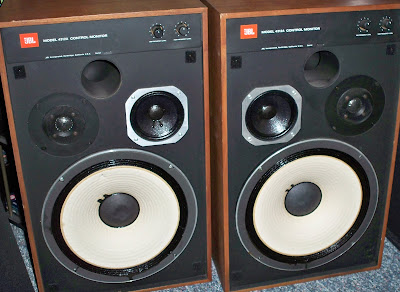

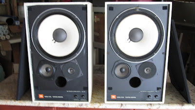

Thanks guys, I have a weird blood disorder, doctor says my chances of getting hit by a bus is worse. LOL...but my feet, lower legs are numb-peripheral nueropothy-so I can't feel the Gas or Brake pedals...."oh yea..it sucks"
Here are pictures if I can do this correctly...
(The 4312A's are not being sold-I couldn't do it!!!!)
(Sale pending on the L20T's)
What can I say...I like White Woofers....LOL
Off to watch football....
