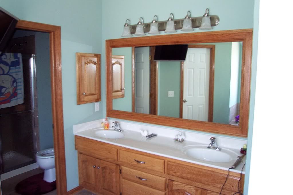

Here is a photo of the bathroom when we first moved in 11/1/2004. Everything was brand new. It didnt take long for the shower to turn to crap with those cheap doors
Is that a flat screen tv in there? Ritzy!

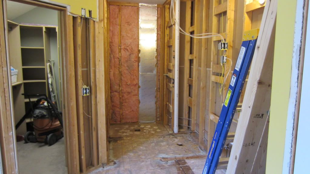

I went out this morning and got a replacement for my broken camera

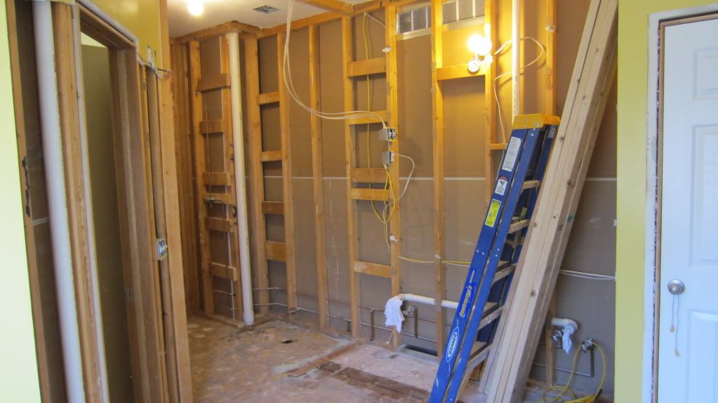

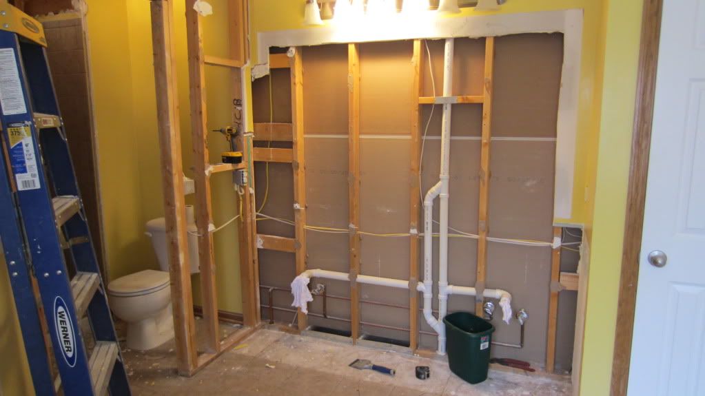

Here are a few photo's of where I'm at

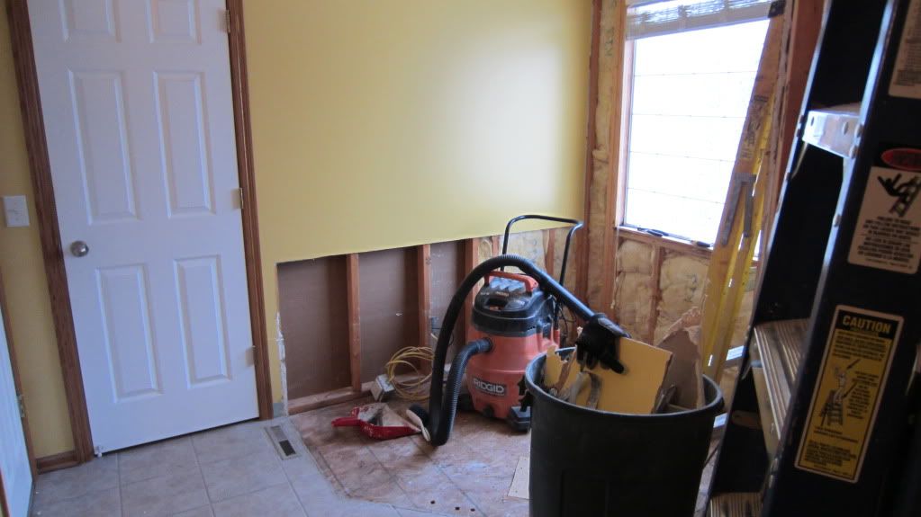

The toilet will be relocated to where my shop vac is sitting and the room that it is being moved from will become one large shower bigger then my new basement shower this project has to be done first before I can finish up the basement build as I'm having plumbing moved around so thats whats holding up finishing the drywall in the basement.

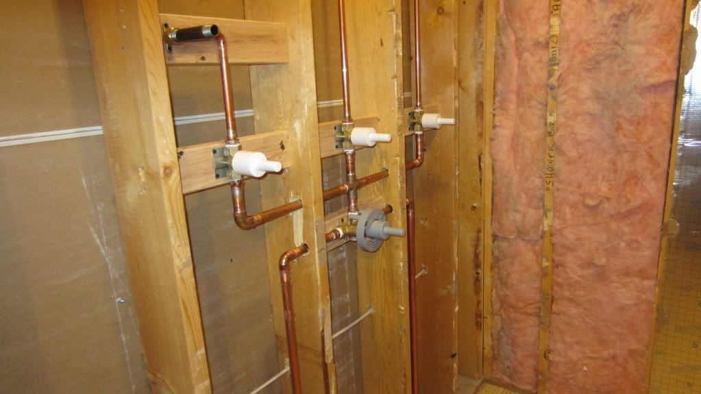

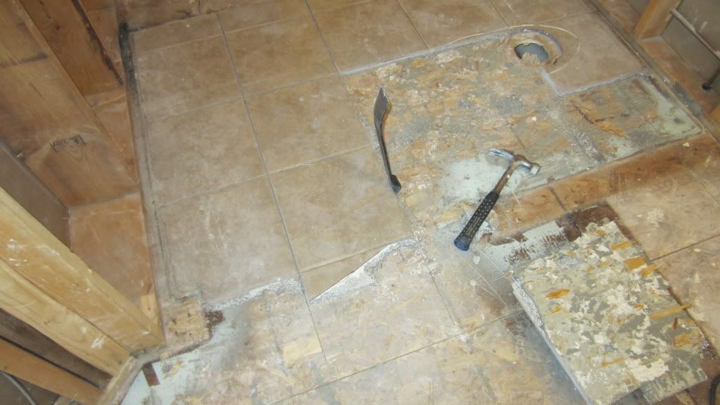

Well its been a pretty busy week got everything tore out almost all the framing done on the shower. Plumber was here today and just about finish but ran out of time they will be back on Monday.

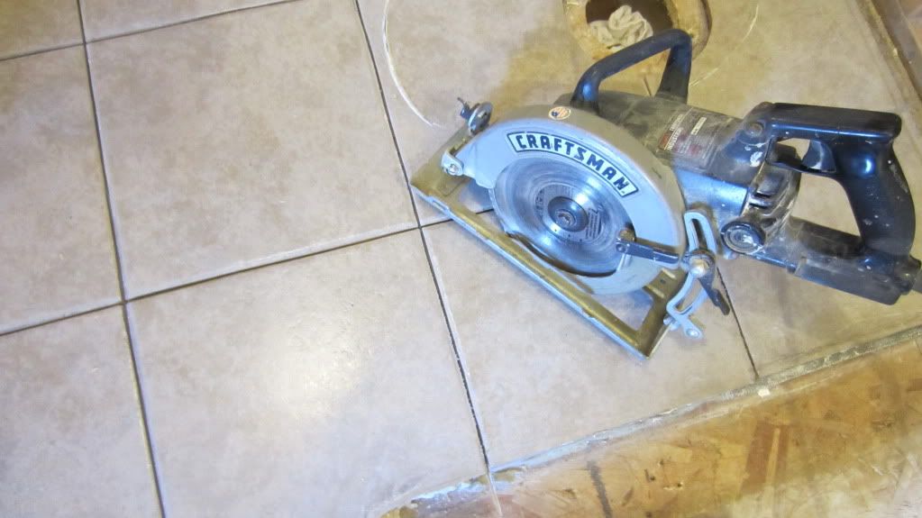

I had a pretty easy time at getting the tile and backerboard up. I ran my skill saw down the grout line with a concrete blade. I used my shop vac to suck the dust as I cut worked pretty slick.
This weekend I'm going to install all my electrical can lights and new bath fan possibly the new double hung window. Tile came in yesterday. Once the plumbers are finished my floor guy can get in to pour the shower pan. I decided to hire out some of this to get it done quickly.

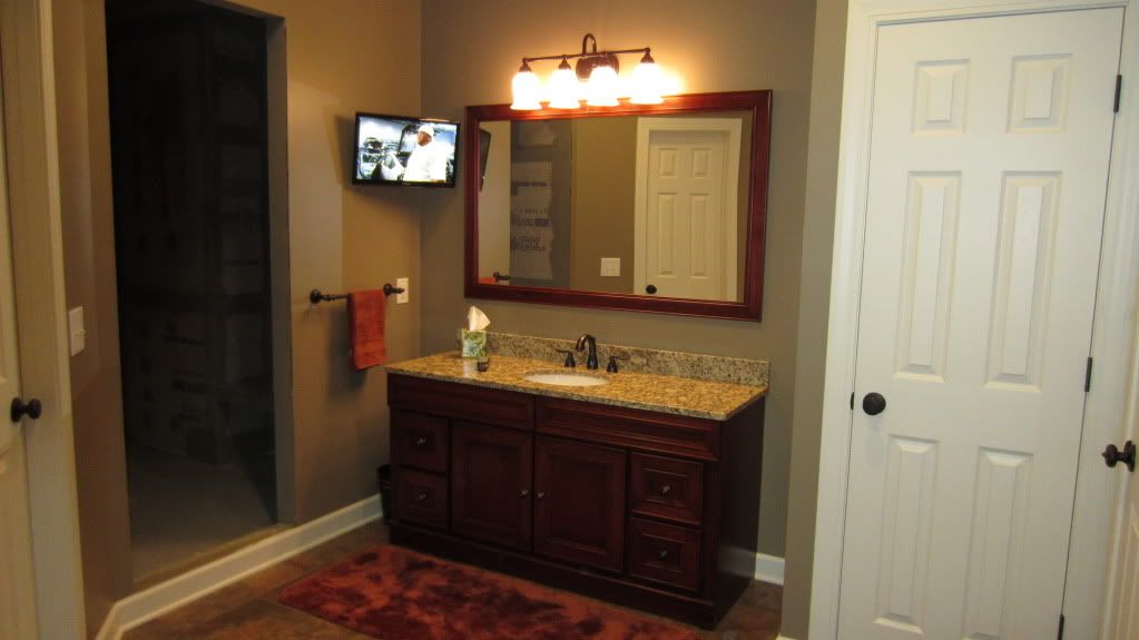

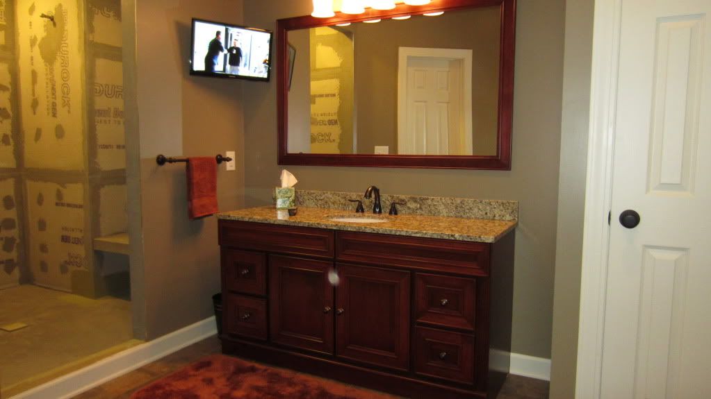

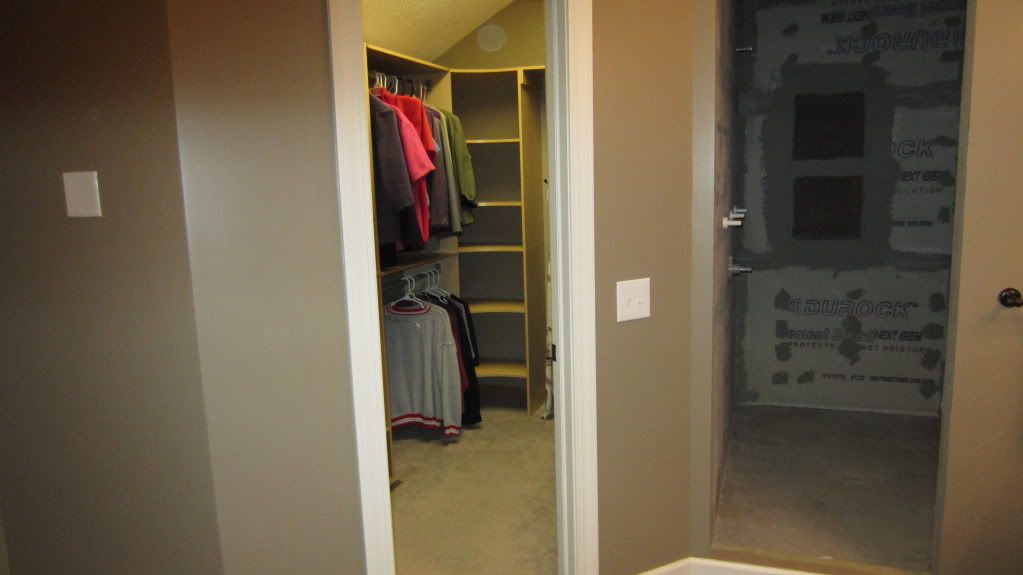

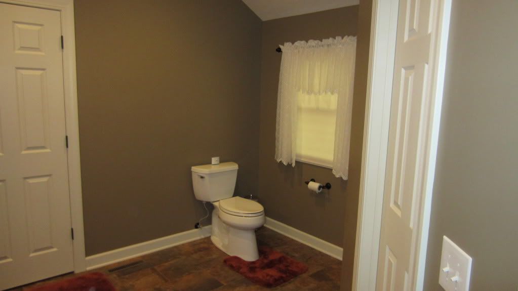

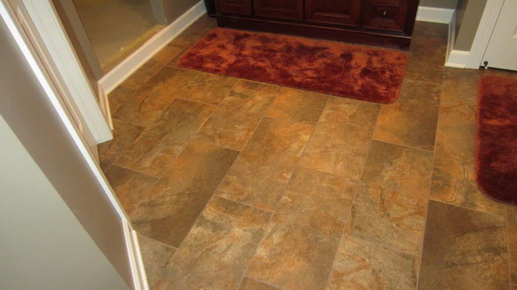

Well its been a little over 4 weeks since my last update and I have finished the main part of the master bath. my pictures make the tile look allot more orange then they really are there more of a rust color. I'm now starting on the shower tile I will post some pics as I go. I really can't wait to finish it and get back down in the basement.
