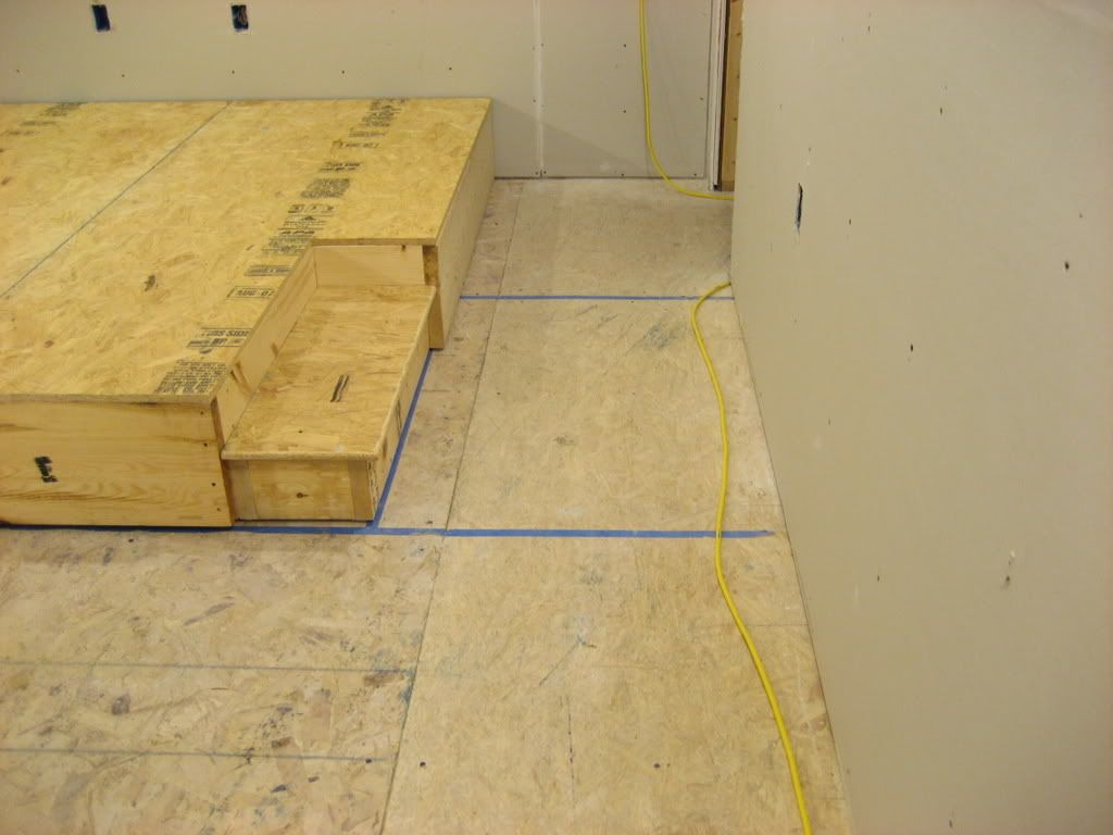

Well I put the first layer of decking down and put a few screws to hold it in place to see if I liked the way my step felt and I hate it. I changed the way I was going to do it because I did not think it would seem right having to step up right after entering the door. Where you see the blue tape is where I was originally going to have the step. I do believe I am going to change it back to the first plan
my design has changed so many times it isn't funny anymore

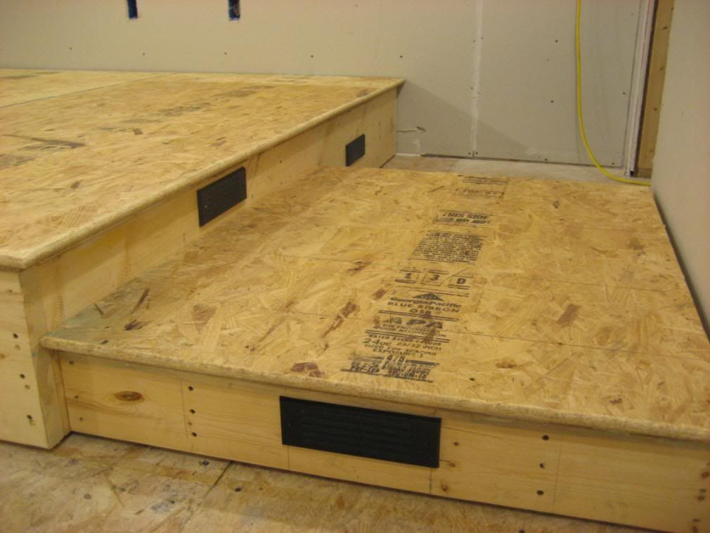

Here is the new design I like it allot better. I also took 6" off that side of the riser to make the step wider its 33".5 x 48"
Now I am waiting for my step lighting to arrive and I can stuff it and get it done

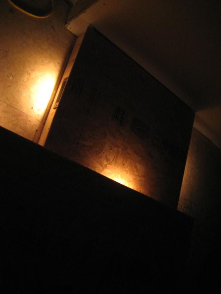

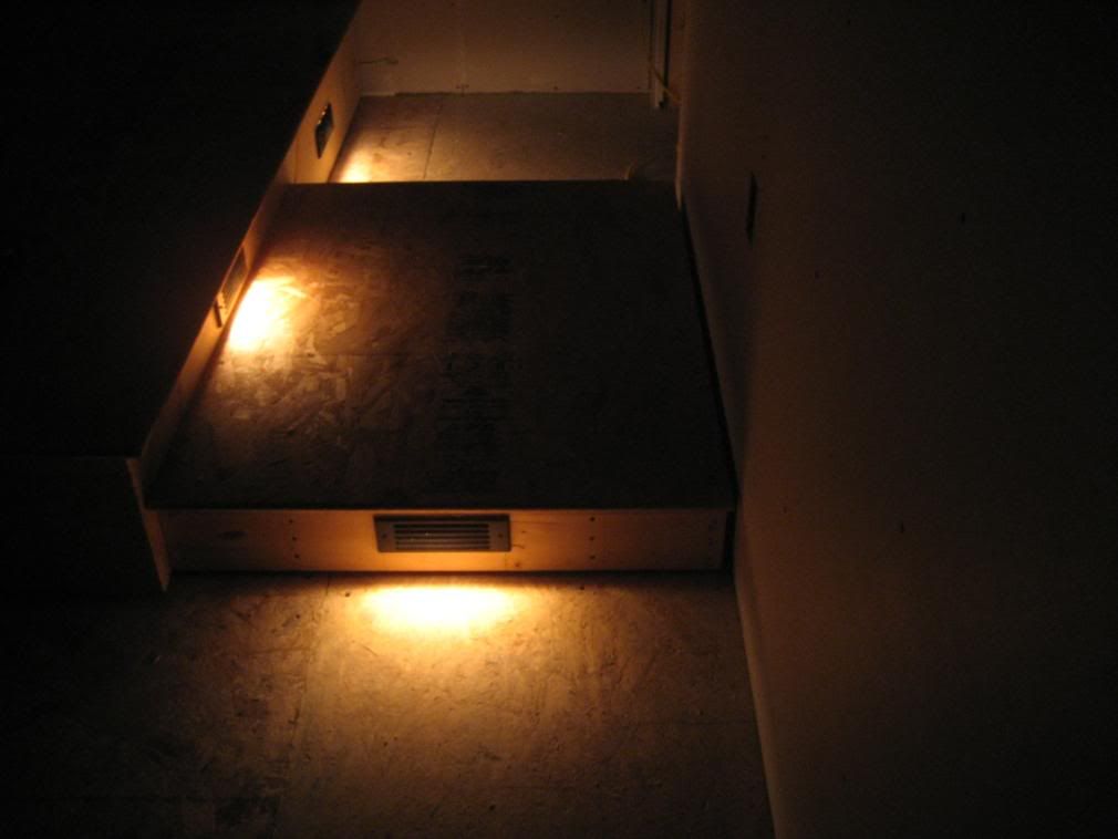

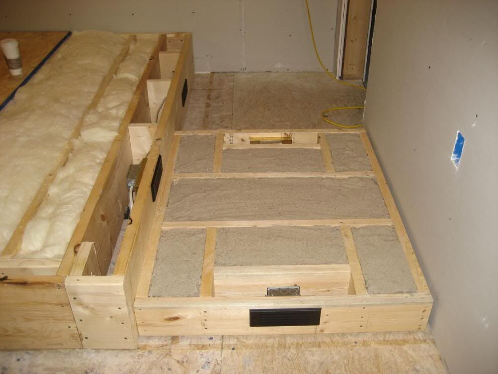

Well its been raining here for the last few days so I have had some free time this week to do a bit of work on the room. Today I finished up the riser step lighting filled the step with sand and put the second layer of OSB on
I also ordered the carpet that will be installed November 13 this will give me a kick in the azz to get moving toward the finale treatments

Nice use of the lights. Maybe I should add more like that. Do those dim too?

Yes they will dim just need a dimmer switch. They have 25w incandescent clear bulbs in there. Here are the ones I just installed http://www.ccl-light.com/docs/outdoo...b-hl/120v.html
