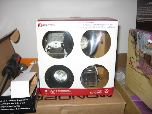

I was considering the bulbs you got because they are SO COOL!
My cans take the GU10 two prong bulbs as well. They also sell the MR16 two prong and E27 screw in.
E27
MR 16
GU10
I found the correct base on ebay:
item number 200175175656
And I also found a website that sells the whole product line.
http://www.wiedamark.com/index.asp?P...S&Category=826
But... It says the GU10 model may not fit all cans. The LED bulbs are longer than the regular counterparts. But I think the cans I picked up are similar to yours... I think I may still have to measure to see it they will fit.
So I'm crossing my fingers
Can you just wire the lights together... or do you need the controller box they are selling. Just double checking that they will they work on dimmer ( I think you mentioned that earlier) or will I need to configure my switches for regular on/off?
Your space is looking great!
-Cam

The cans you have are the same as the ones I used so they do fit with no problems. The bulbs are just a bit longer and there is quite a bit of play with the part that plugs into the bulb. you do not need the control box what you need is one master bulb and then run slaves to it.
The little wires coming out of the bulbs are not vary long so I just picked up some wire from radio shack and soldered some longer pieces on to reach the master and then put some shrink wrap over the splice. Since these bulb really give off no heat I ran the control wire up through one of the many holes in the top of the can
