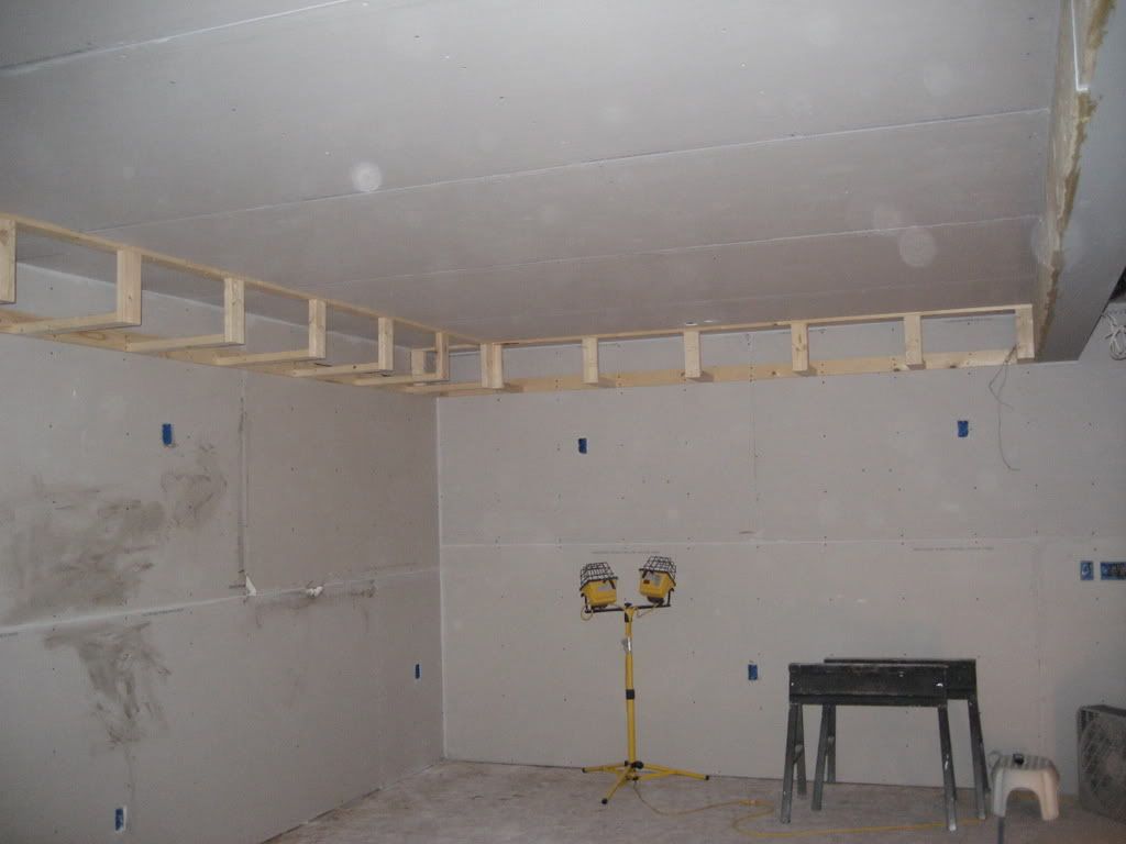

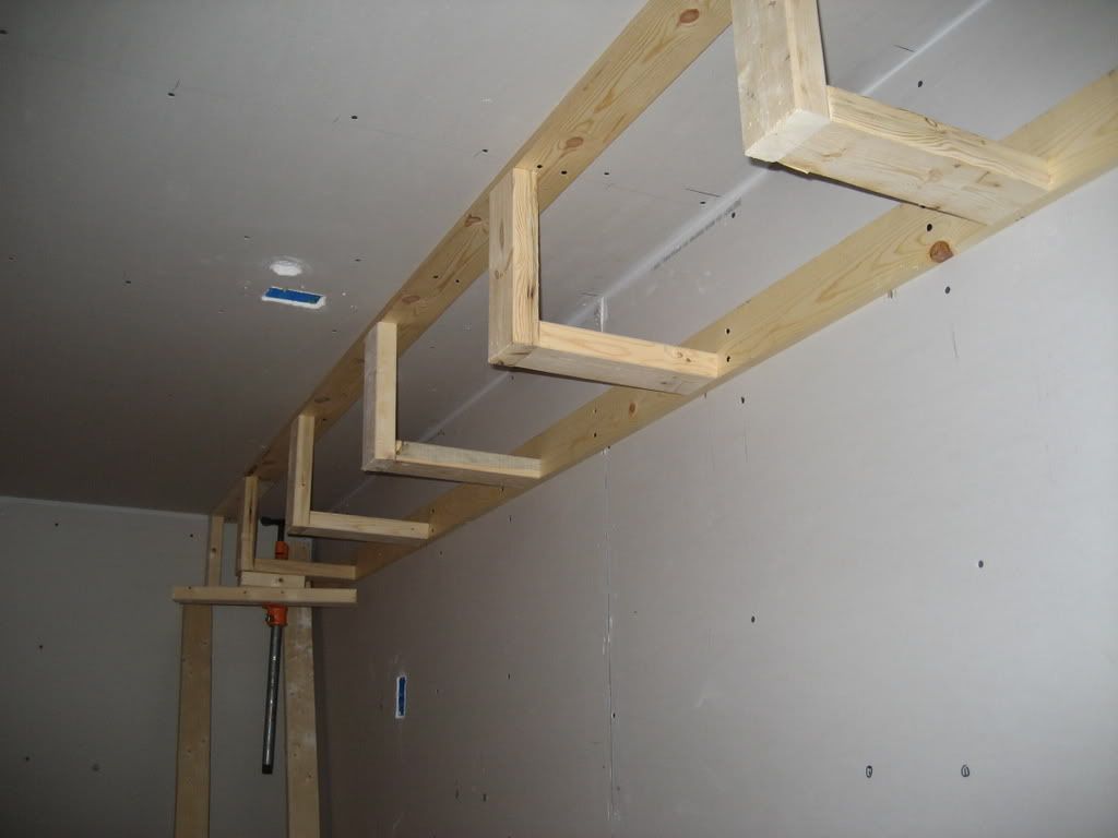

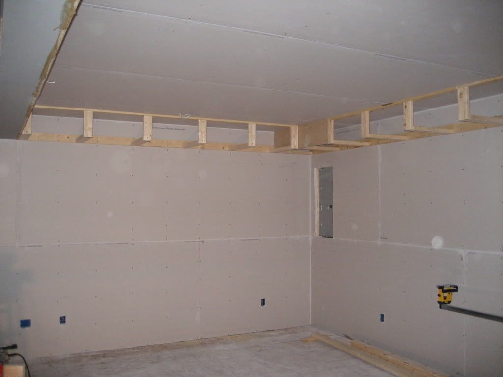

I worked about half day Sunday and a bit tonight. I finished up the soffet framing. I thought a long time on how to go about this and this is what I came up with. I wanted to make it as easy as possible since I do not have a helper. They look pretty flimsy but I assure you I could do pull ups from them I am going to be using 5/8's OSB on the sides and 3/4 on the bottoms I have not decided if I'm going to sheetrock the bottoms or threat with linacoustic and gom. The sides for sure will be sheet rocked
What are everyones thoughts on insulation in the soffets. I plans on using can lights that are non IC rated. Do you think it needs to be stuffed? Or can I get by with stuffing the areas where there are no cans.
framing built on floor first
Then lifted and screwed into place
Rear wall
Front wall
I think I am going to leave the soffet behind the screen wall open and fill it full of some sort of cotton batting for a bass trap

Looking good W00lly. I would stuff them with insulation everywhere including the "cans area"
