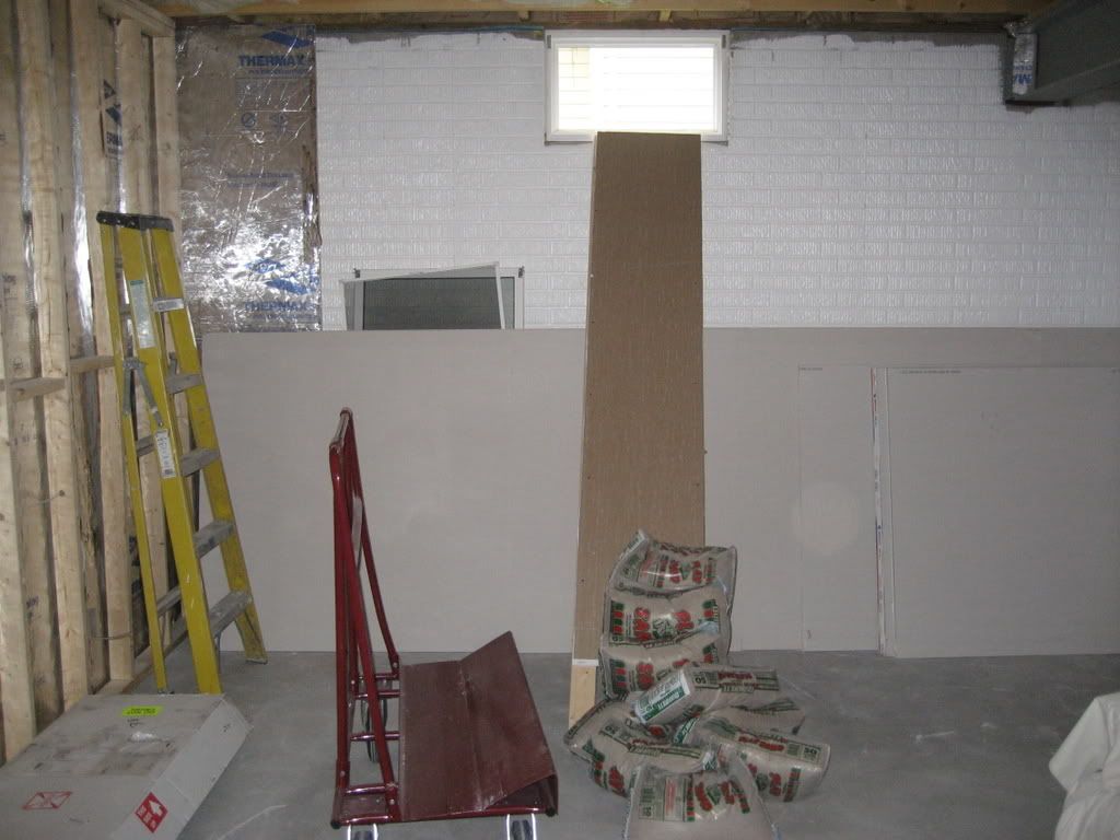

I got 50 bags of sand down in the HT the one side I got done took 27 bags I carried those down one at a time that was way to much work so I got a little more creative cuz my back was not liking that. I used my mower to wheel it to the basment window slide them down a ramp and then wheeled them into the HT with my drywall cart. I should have done that with all of them

Well I finally finished the stage. It took 60 bags of sand to fill it all I need to do now is put GG in between the 2 layers of OSB and screw it all down. Next is the riser I am also going to order my linacoustic this week.
