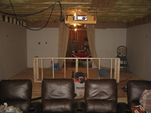

Big, I framed up the main wall of the bar just now (10' long). I'm planning on having a 12" leg on either end on one side, and a 6" leg on both ends of the front side. There will also be one 6" leg in the middle of one side (I got this from one of your photos). All of the bottom plates will be screwed down to the riser. Do you think this gives enough stability to the bar? Seems like it will be shakey to me. Maybe once the sheetrock is on it will "tighten" it up? Any thoughts? I can draw a plan if that wasn't clear.

It was going to be a two level, but now is one level. Good idea for the brackets in the middle, I'll do that.
The plans back on post#66 were showing a lower level bar on the front side of the wall to serve the middle row of swivel chairs. We have since changed the middle row to a couch and decided to do away with that part of the bar. We are now planning small coffee tables in front of the couch. It is probably time I update the floorplan.
post #201 of 1806
You should plan at least a 12 inch overhang at the ends if it is curved (small at the ends)
My bar top is 18 inches overall at the ends 25 at the middle.
Also you might want to think about using plywood on at least one side of the base (you can put drywall over if you want) that will give a little more rigidity to the frame support.

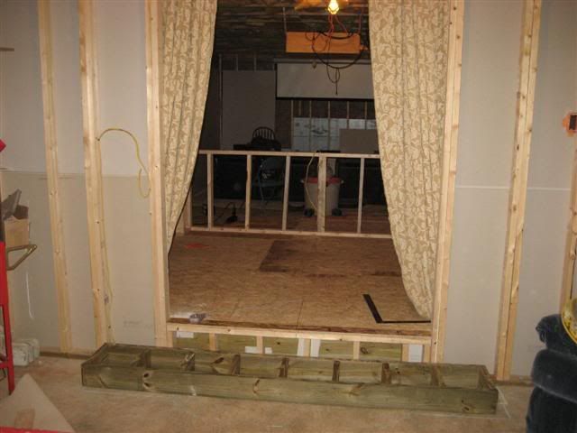

Here's a few photos so you can see what I've done today.
It's framed 10' long and 15" in depth. By the time I do overhang, the top should be 10'6" wide, 18" deep on ends, and 24" deep in the middle. So, I think I've framed right into the figures you suggest. It feels pretty steady, but I may still need to put the little short walls on the front side as well.
The isle on either side measures 43.5" now, so after the wall treatment takes an inch and the bar top takes another 3", I should be at about 39.5" for the finished isle. It feels generous at 43.5", so that should work out fine.
In the last photo you can also see the step I framed to the entrance. It looks to simple to me without the radius, so I guess I'll do that after all. I'd like to match the radius on the entry step to the radius on the bar top. I hope it works that way. Oh, same radius on the front stage too.
You've put so much work into this project I almost hate to criticize that step up design...but I got a big mouth.
Putting a step up right at the threshold isn't a very wise idea...in fact I am not certain it is code legal. It will be very dangerous for those leaving the theater and might not look down for that step down.
Given your constraint of not wanting to extend too much into the game room I think I would do some surgery on the riser and take a bite out of the riser right inside the theater entrance (half moon maybe) have one level equal to your step outside the theater then another up to the level of the riser but do it inside the theater and put step lights on the vertical portion of the step.
Your design also prevents the use of two way swing door that you said you wanted.

Big, I need a big mouth around, no worries. I came upstairs halfway through "Atonement", and read your post. You had my mind racing through the rest of the movie. I'm trying to figure how I'm not going to have to chop into the riser.
As for code, I'm not certain what it is either, but I do have the same situation in three other locations in the house that all passed code (basement door to steps, garage door to steps, and front door to porch).
I do understand that it may be unsafe regardless of code. At the very least, I'll be sure it is well lit, but I may brainstorm another option. I could come out into the gameroom if it comes to that. It would only be an issue for long shots in ping pong. And, I can always put my opponent on that side.
post #206 of 1806
I'm a little slow but it just dawned on me why you commented that the double swing door would be dangerous.
I've been walking in and out of all our doors in the house. In the ones that open to a step, the door swing is always away from the step. That makes sense to me now. Pulling the door away, causes you to take a step back and look first. If it would swing out into the step, you could push your way through in one motion and take a step before you looked.
I'm thinking that my solution will be lighting and an in-swing door.

I got the step done this morning.
And my helper today...
I'm happy with how it came out.
