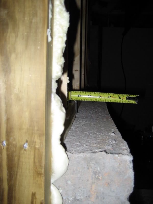

Okay, I can't go any further until I decide how to handle the insulation and screenwall.
Here you can see that it is a stairstepping concrete wall, roughly half of which is typical stud construction above grade (for that matter, half of the concrete is above grade too).
The issue I can't resolve is that the stud wall portion is not flush with the concrete face. It is 4" behind the face of concrete.
Based on other threads, I am thinking I will first insulate the existing upper stud wall with fiberglass batts. Then, build another wall that is 4" thick on top of the concrete wall so that I end up with a flush wall (half stud and half concrete). Then, fill the new 4" thick stud portion with more fiberglass batts. Then cover the whole face of wall with rigid 1" foam insulation. Lastly, build a new stud wall from floor to ceiling and fill that with fiberglass batts (with the paper either pulled off or perforated).
In the end, I end up with 3.5"+3.5"+1" rigid foam + 3.5", for a total of an 11.5" thick insulated wall.
Is this making sense? Does it sound appropriate?

I think you can bypass this section of studding.
Unless I'm mistaken, code allows (please double check because I'm not sure) for you to just build the stud wall that will wind up being your new interior wall. You will still want to completely fill the cavity with insulation though.

Dan, I see what you're saying, but isn't that section of wall necessary to give support for the rigid foam? it does seem like its overbuilt just for supporting the rigid foam.
So, I'll pack the existing stud wall with fiberglass batts that are 8" thick (out to flush with the face of concrete). Then, put the 1" rigid foam and then my stud wall.
The top half of the rigid foam board would only be supported by the fiberglass batts on one side and the new stud wall on the inside.
I'm soliciting ideas here

I am not sure about code, but this is what seems to make sense to me. I think I would just cut and fit the foam to the existing studs above the concrete. Then cut and fit rigid foam onto the cement portion. Then build the new stud wall 1" off the rigid foam that is on concrete portion. Then just insulate the new stud wall. An air gap will not hurt you. Just make sure you have only one craft face on the most internal wall.

So, I am overthinking this then.
One vote for filling the cavity, one for not. I think filling it makes me more comfortable. I can't think of a problem with filling it?
I think I'm going to follow Gonzo's suggestions but will fill the entire cavity with batting.

There is no problem with filling the cavity, it will just increase the R value. I have found the theory that the PJ hanging slows progress is not true in my case. We used to watch movies at night on a smaller TV, now we watch them in the theater. The only change is the location
post #114 of 1808
I think Gonzo and I are saying the same thing. I filled all of the cavities in my walls and one of them is right at 10". Like Gonzo, I don't think a 1" space is going to hurt anything, I just felt better filling the entire cavity.

Question: Should I use rigid foam board over the top of the concrete wall? There is about a 4" wide section along the top of the wall that is exposed.
