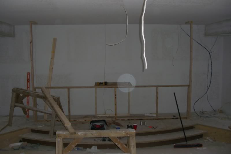

I am in fickle mode with my front speaker placement. Should I put them wider behind the GOM false front or....behind the AT screen and clser together.
The screen width is 170'diag.
I am using Triad platinum for LCR.
Thoughts?
