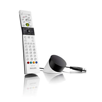

Originally Posted by Merfsiu View Post
I just got a XPS 420 that came with this remote:
Can someone point me to some info on it? and would the reciever work with the premium remote?
Without the Green Button: (See below for : With Green Button & PDF / Tech Specs):
Link: http://translate.google.com/translat...hl=en&ie=UTF-8
and of course.. www.Engadget.com
Link: http://www.engadget.com/2008/12/26/a...te-for-eee-bo/
www.neowin.net (via: Christopher Vendiemio - comment on http://www.engadget.com/2008/12/26/a...bo/1#c16306094)
Philips Website:
PDF:
http://www.p4c.philips.com/files/s/s...10_pss_eng.pdf
Overview Tech specs 4-in-1 remote to control your PC, TV, STB and AMP
4-in-1 multimedia remote is one remote that can replace the different remotes supplied with your TV, STB. AMP and your Media Centre PC. The remote control has IR codes for most brands of these devices incorporated. The manual of the remote lists all the codes. When installing the remote, simply look up the code for your device & brand and enter it into the remote.
Extensive infrared code database for most devices and brands
A universal IR code database refers to a library of infrared codes built in to a particular remote. This feature allows a remote to control your equipment without needing to learn individual signals. Select the correct infrared code sets in the database for the devices you want to control to enable control of virtually every audio/video system element on the market today - regardless of model or brand.
Navigate your music files using your TV/monitor
Easy media navigation refers to a remote that enables you to navigate through the content of your media files on your Media Centre PC, as well as control of other audio/video devices. The infrared (IR) dongle supplied with the remote is connected to your Media Centre PC. Via this dongle, the remote can control your Media Centre PC, browse through files, select a file and play it on your equipment of choice.
This should help.
~b3nz0n8
