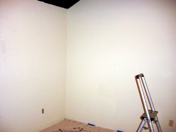

This is the room as it looked when I started work while painting the ceiling black (Lowes Valspar: (flat) Dark Kettle Black). The biggest challenge here was that the ceiling is covered with a "popcorn" texture and it took four coats to finally get it all covered. In the end, if I had to do it again I'd probably just spend the extra day removing the popcorn and re-texturing the ceiling before paining it. Ah well, live and learn.
As you can see on the floor, it was raining little, black pieces of wet popcorn texture down on me the entire time I was painting. I looked like I had been sprayed in tar after it was all over
