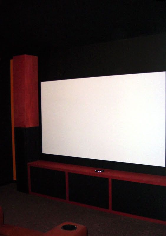

Minor update.
I received some movie posters as gifts this past Christmas, and while they have been hanging since Dec. 28th, these are the first pictures I have taken of them.
Please excuse the Flash. I'll try to get some cleaner pictured in natural light later this week.
I've also added some brushed bronze cover plates to the outlets which you can see in Picture #3.

Managed to get a little more done over the past weekend.
Finally took out the "temporary" surround speakers and mounted the ones which were bought for the room months ago...
And took a little bit of time to sit down and appreciate them with a TrueHD soundtrack...

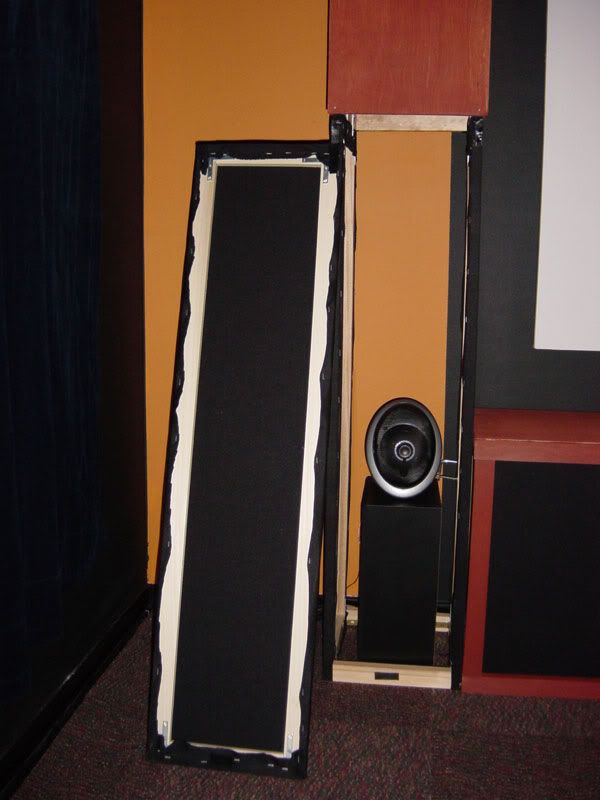

Our goal was to create a theater which could potentially be turned back into a bedroom simply by removing the equipment and repainting. So in-wall speakers didn't work for us either. However, we didn't want the speakers to be a distraction from the screenwall.
Since the Mirage speakers I'm using are omni-directional, I wanted something which would hide their placement in the room but would be transparent to the transmission of sound in all directions. That was why I designed the pillars this way.
Unfortunately I didn't take any pictures while I was building them however, they are basically just made of a framework of 1x3's with quarter-inch paneling stained and cut to fit the top sections and with speaker cloth stapled to the sides on the bottom half.

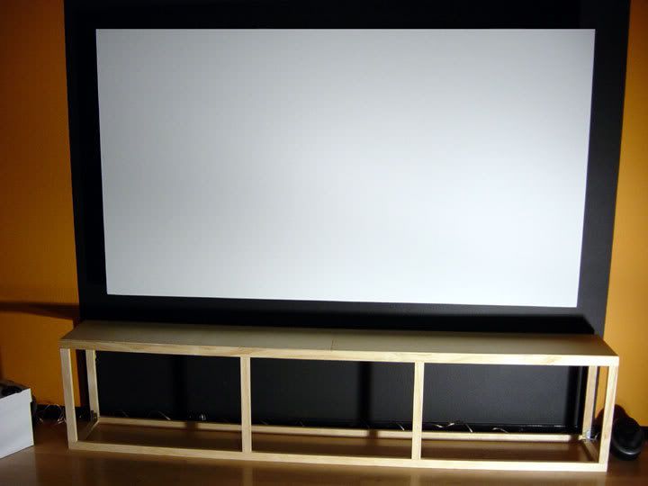

The basic construction of the frames is fairly similar to that of the center cabinet, just longer and narrower. Here is a picture of the center cabinet while it was being built to give an idea what I am talking about.
There are removable grills made for the bottom (where the speakers) are that are a simple wooden frame with a cloth cover which are attached with velcro tabs.
The pillars are then secured to the center cabinet with clamps allowing for easy removal if needed.
Not the most elegant bit of carpentry to be sure, but since they were basically built by a guy who has never used power tools or made anything out of wood before this project, I'm happy with them.
I made all of the pieces much larger than was required for the very small Mirage Omnisat speakers so that I would have room to potentially install larger, full sized speakers at some future date. Not that I don't love the Omnisats but I figured that if I was going to build custom speaker enclosures that I might as well plan ahead.

Actually, the front of that piece doesn't open, I left the back of the unit open to allow access instead.
Technically, I could have built an open frame and a removable front cover for it in the same manner as the side units, however, the center piece was my first attempt at carpentry and I didn't think of the removable grill concept until after I started working on the side pieces.
If I had to do it over again, I would simply build the rectangular frame and make the front grill a separate piece, but I doubt that I will be "remodeling" that cabinet any time soon.
