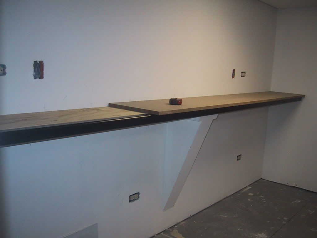

Time for a photo update,
Spent part of the weekend finishing the drink ledge in my rec room.
When I framed this room; I installed a 1/4" thick x 2" sq. steel tube across the back of the room to be used as a bar/drink ledge. Attached along the inside length of the tube is 1/4" x 1" angle for supporting the counter top material.
I needed to add the upper layer of 3/4' base material - this will ultimately be the substrate upon which the Black granite tile will be "installed":
I then needed to flush out the front surface of the steel tube to have an attachment point for the oak face. This was done by ripping some nice straight 2x2s to the correct size. These 2x2s are both glued to the steel tube with construction adhesive and screwed in place from above:
Clamped Screwed and Glued:
Ready for Oak:
And a test fit with the tiles and the "rough-cut" oak pieces:
Gluing and nailing the oak into place:
Ready to secure the remaining Oak and "trimming", (then wood filler, router and belt sander action):
My Thanks to Hawkeye Josh!! many of these details are borrowed from his build.
