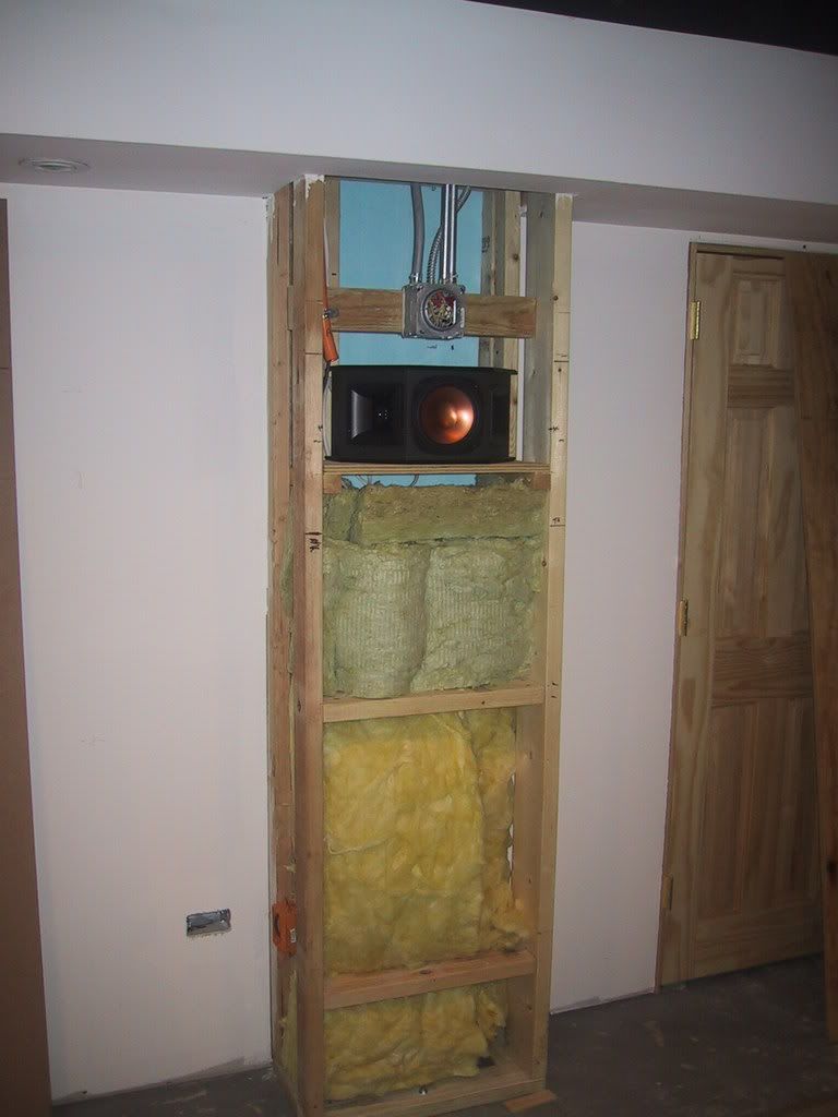

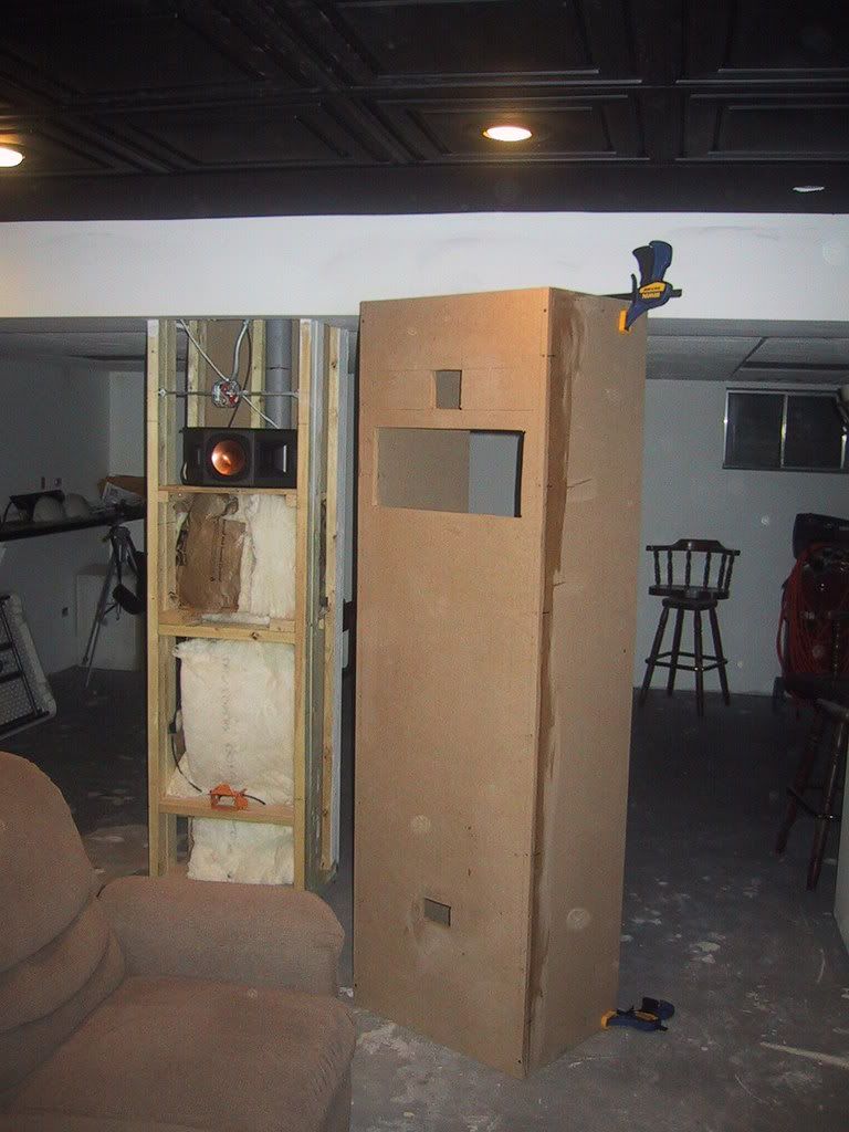

So I finally got back down there and started my column enclosures.
The left side column cover is almost finished. Took (stole) some tips from Queen DVDs build (thanks Queen). I decided to finish my columns with 3/4 " MDF, and will wrap these in GOM.
The opening at the top is for my sconce light
And the Right hand column still needs to be done, (I packed these full of leftover insulation)
Also a question:
I will be covering these with GOM (after I round the front edges with a router). Am undecided if I should just paint these flat black and cover with GOM directly, or perhaps I should wrap them in batting before covering with GOM..??

Nice work on the columns Cuz! That was fast. I too was worried about whether the columns would need to be painted or not. My HT guy says that my fabric will cover them fine so I left them as is. However, it is worth noting that he didn't think it was necessary to paint the false wall frames black but indeed I see through the GOM in the pictures. But for movie watching it's completely fine. Somehow though I think it will be less of an issue with the columns. I don't know if I would pick the wrap in batting before covering since I'm assuming that the batting is white and your GOM choice for the columns is black? That would bleed right through. I'd vote for the flat black paint and then wrap in GOM for the safest route. Or you could temporarily wrap one without stapling but have someone hold tight and then snap a photo and see if the MDF shows through or not.
post #102 of 1594
Queen,
I'll do a little testing to make sure - but will likely skip the batting and go with GOM over a flat black painted surface.

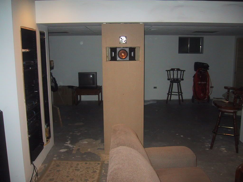

Question for you: How are the corners of the columns going to affect the angled horns on your speakers? From the pics, it looks like the speaker is set back into the columns, with the horns partially pointed at the corner 2x4's.
I would think you would want a gap in the edge of the columns to allow for this. Meaning the opening would wrap around to the side a little.

Also; A good eye on the surround placement and possible interference with the horns.
Believe it or not; it is close > but I do have line of sight from the edge of the horns to all seating areas. However; those column shrouds are coming down one more time for some additional preparations. At that time - I will be opening up the horizontal axis of the opening by an additional 1" on each side.
