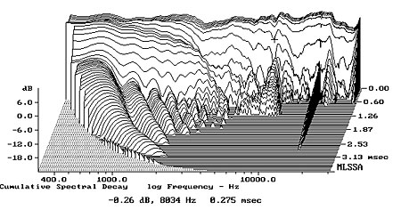

I just picked up my first all metal driver speaker-set (Monitor Audio GS's) and I do have to say that they are certainly some of the cleanest sounding speakers I have heard, though I'm not totally convinced that is solely due to the driver material. I was under the impression that the clean sound came from their fast decay time.
MA GS10 cumulative spectral decay plot:

Actually, that decay time isn't nearly as good as it looks. See that treble peak? That's up about 12dB or so over the rest of the sound. That pushes the decay spectrum down by 12dB over a very accurate speaker. That's one of the things about graphs, you have to know how to interpret them properly. In the case of a Stereophile spectral decay plot, the more erratic the FR, the better the speaker looks!
But, the clean sound you get from Monitor Audio is, indeed, because of their metal drivers. In theory, the more rigid the driver, the more resolution it will have, with less added harshness *as long as* you excise the ringing that will inevitably hover not too far above the crossover frequency. Steep, and relatively low, crossovers are critical for proper use of metal drivers.

I respectfully disagree. That treble peak is at 27KHz. The last time I had my hearing checked, I was struggling to hear 16KHz. Besides, there is no music up there, and even a human with perfect hearing is not going to hear a 27KHz tone even if it is a 20dB peak.
With all due respect, I think it is you that doesn't know how to read a CSD plot. The CSD plot has very little to do with FR, yet you reference FR a couple of times in your response to me. While a nasty resonance will manifest its self as a peak or dip in the FR, that's not the point of the graph. It is meant to show the persistence of sound over time and you read it from back to front, not side to side like an FR graph. Other than the resonance at 27KHz in the MA GS10, look at how the sound "stops" almost immediately after the input signal all throughout the treble and even into the midrange. I challenge you to find a cleaner CSD plot than the MA GS line.

Here is the MA GS10 again for visual reference:
There's really not much for me to comment on here. The results within the audible band speak for themselves.

The GS10's CSD measurement looks excellent.

You *seriously* don't get it? Seriously? Because the treble peak in the Monitors is in the measurable range whereas the B&W/NHT aren't, that peak causes the computer to drop the graph "below the water" by a good 5dB. That means you're actually seeing more of the resonance in the picture with the others than the Monitor. The B&W/NHT graphs are flatter, so the image of the resonances isn't pushed down as much. Do you get it yet?

John...you need to look at the time scale to the right, not the dB scale to the left.
Decay is a measurement of time......the time it takes for resonance to dissipate or stop. The GS10 does that faster than any of the other of the graphed speakers.

Well, that makes two of you that can't read a graph. Wrong dimension of three dimensions.
We don't know if the MAs stop faster because there's much less data that can be seen in the graph. About 5dB worth.

You are making the assumption that there is data below -12dB. You can also make the assumption that there is no relevent data below that point and that is why they do not show it. Judging by the slopes, I would say the later.
