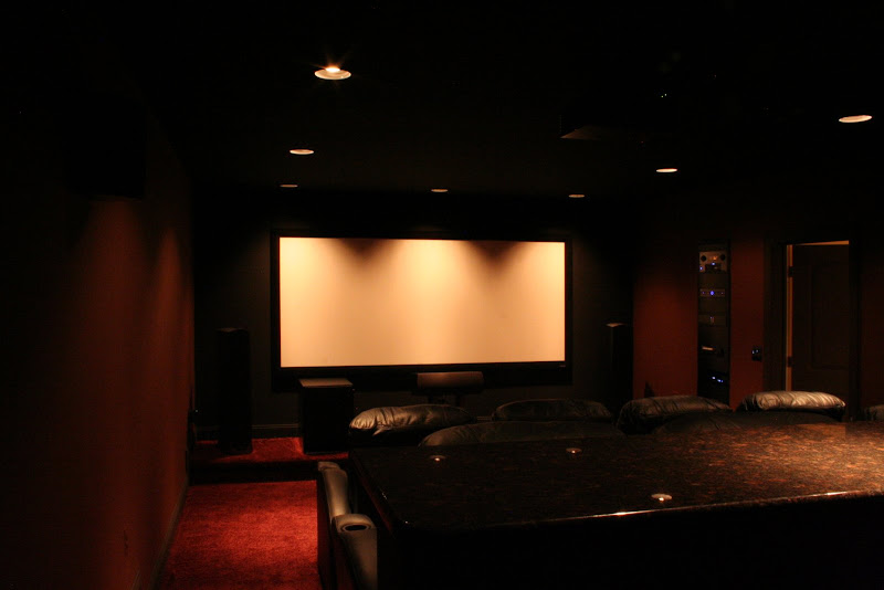

Latest update: this past weekend I had the good fortune of enlisting BigMouthinDC to assist with the projector and screen. Was great to have some HT-trained eyes on hand to see what I’m trying to accomplish. My thanks to Bigs for his assistance; he certainly has a penchant for detail!
Some pics of our handywork:
I’m really impressed by the image that the Panasonic PT-AE3000 throws, especially with Blu Ray content. The Carada screen (128”; 2:35:1 aspect) was fairly easy to assemble and mount - Bigs had a great laser level that aided the install.
Once we mounted and turned on the projector, we noticed I was coming up a bit short on the sides when I fully zoomed out for 2:35:1 content. After checking the throw ratio of the panny, I needed to drop back about 8 inches, however, my builder dropped the ball on installing blocking here. Reluctantly decided to get a narrow strip of plywood and bolt it between the trusses – was a bit concerned about this due to aesthetics – but once I painted to match the black ceiling and hung the projector and mounting hardware – was hardly noticeable. Very pleased overall.
Got a lot of the remaining equipment over the last few weeks as the WAF appropriations bill got passed! Latest equipment inventory:
Paradigm Studios 100 towers (L & R)
Paradigm Studios CC590 w/ J-18c speaker stand
AV123 MFW-15 subwoofer
Atlantic Technology 4200e Surrounds
Pioneer Elite SC-07
Directv HR21
Belkin PureAV PF21
Xbox 360 Elite
Sony Blu Ray (BDP-S550)
Panasonic PT-AE3000
Carada Criterion Brilliant White 128" Screen (2:35:1)
Berkline Chairs (13175)
Just ordered bar stools for the drybar, hopefully in by next week. Still need to do some audio/video calibration and other odds and ends, just glad the room is up and running!
