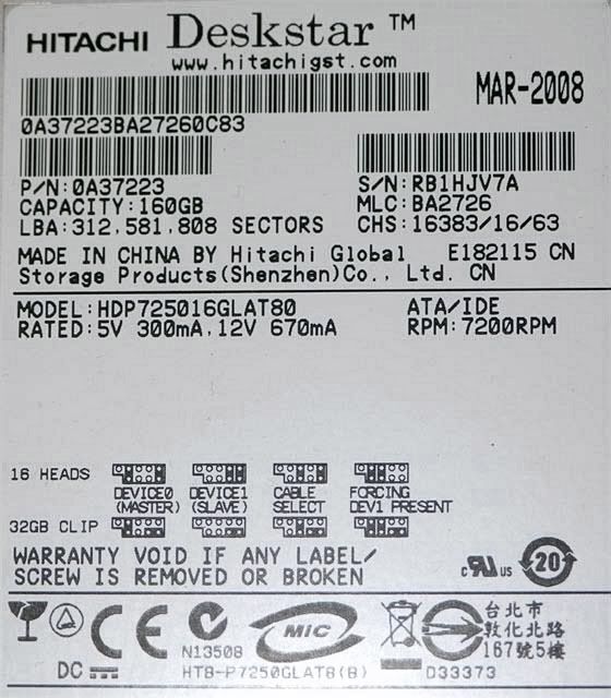

Below are comparison pics of the 3575 insides taken by Dartman and the H2160 insides taken by hugemoth. Only differences I can readily see are the HDD and the USB PCB in front of the HDD in the 3575 pic, missing in the H2160 (no USB port).
Philips 3575H
Magnavox 2160
Magnavox 2160 HDD
