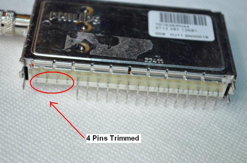

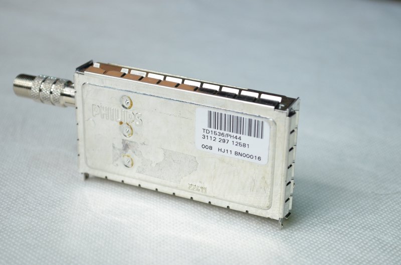

If that unit is a 2160 (A), here is the main AV assembly board. It includes the tuner and the DTV module which are the components you are having trouble with. All of the other parts you don't need to replace are modular and will plug in to this board. If your friend is inclined to help you, this can be installed easily.
The price may not be to your liking, but in my opinion would be better than trying to use another device to tune what you want to record.
You may be able to contact Funai and see if they have a better deal on it. If your Maggie is a 2160 non A model, the part # will be different.

Did you ever check to see if the center core or piece of it from your bad/separated coax might have stuck in the coax connector? That would be quite a drag on the signal.
post #20516 of 23781
Originally Posted by kbbl View Post
Well now the tuner has gotten worse, I seldom can get a useable signal, so I've concluded that the tuner is shot. So now I have a unity, basically, without a tuner.
If that's the case, you can write a line to user rkg22 to scan the possibility to replace the damaged tuner with something like this:
http://www.ebay.com/itm/PHILIPS-TD15...-/320864183790
