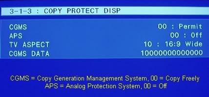

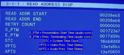

SKIP 456 - Test Modes and Copy-Protection Info

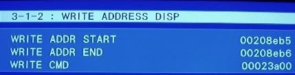

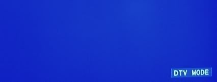

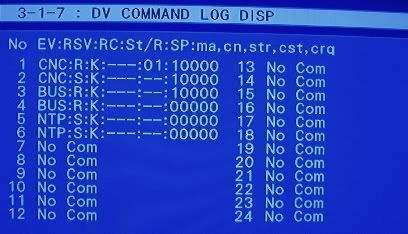

Warning: This procedure's TEST Mode can cause loss of channel tuning, timer rec programs, and all recorded titles, but that can be avoided... if you're either very careful, or just lucky! This SKIP procedure can be a bitch!!!
If using this SKIP code, you should first be on a digital channel. This will start you in the DTV Mode screen, which is safe. Once the menu is open, arrow RIGHT to screens 3-1-1, 3-1-2, 3-1-3, 3-1-4, 3-1-7, which are shown below.
Exit only by turning the machine OFF.
DO NOT USE LEFT ARROW ON 1st SCREEN. If you arrow LEFT on first screen, you won't be able to turn the machine off. You'll only be able to escape by unplugging from power. However, if you do unplug, your channel memory and all recorded titles will be lost! DON'T ARROW LEFT on 1st screen of DTV Mode.
All screens shown below are for DTV Mode cuz I was on a DTV channel at the time.
Screen 3-1-3 CopyProtDisp and "00 : Permit" or "00 : Off" notations indicate that the HDD will code things it records that have NO CGMS restrictions themselves as "Copy Freely." However, stuff coming from an external source that DOES have CGMS Copy-Protection bits embedded in them will carry their original CGMS coding, as follows:
Copy-Once: One generation/copy may be made. External items CAN be copied or recorded to the HDD but can't then be dubbed to a DVD. These titles will have a slashed circle indicating the no-copy status.
CopyNever: No generations/copies may be made. External items CAN'T be copied or recorded to the HDD or DVD ever (without a "filter" between this DVDR and an external source).
CopyNoMore: One generation of copies has already been made; no further copying is allowed. This only applies to those DVDRs that can copy to DVD-RAM or CPRM-compliant DVD-RW discs in Video mode, not the Philips-std +VR mode of this DVDR.
You can read more about CGMS-A (Analog) and CGMS-D (Digital, or the "Broadcast Flag") in this Wiki article.
You can also read an interesting article here on CGMS-A vs. CGMS-D and how networks can "confuse" them (they wouldn't lie, would they?).
Go back to page list. ...... Go to main list of help files.

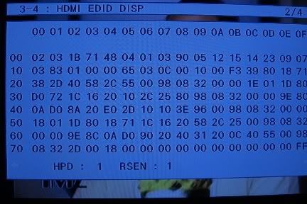

SKIP 789 - HDMI EDID DISP
"Extended Display Identification Data" per Wiki here.
Purpose is to describe the HDTV/display audio and video characteristics to the DVDR, incl. size, pixel mapping, audio capabilities, etc. thru the HDMI connection so DVDR and TV are digitally in sync.
Exit with BACK/RETURN button.
Safe to use. 4 pp, lots of numbers. Menu searches for HDMI connection and attached TV/display. With HDMI connected, shows numbers that are "significant" but, with no HDMI (like to a 4:3 TV), all numbers are double-zeros.
First two pages from my Vizio HDTV/3575 HDMI connection shown below, rest have "00" only.

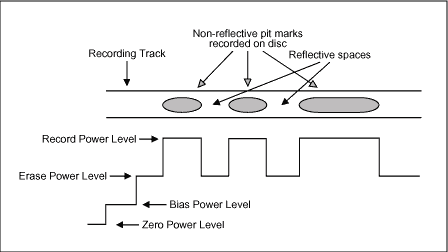

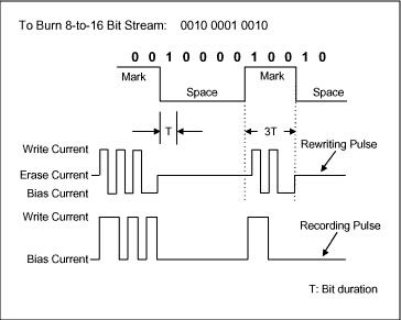

SKIP 321 - Checking Laser Diode (DVD Burner) Usage
For checking laser diode (LD) operating times for DVD-WR (write), DVD-RD (read) and CD (hours:min.). Safe to use anytime. Exit with BACK/RETURN button.
For HDD POWER ON time, use SKIP 079, Step 1.
Some info from this Maxim article helps explain our DVD-WR and DVD-RD times/stats. The article includes two interesting charts reproduced here: Fig. 1 showing LD Power Levels and Fig. 2 showing a Typical LD Pulse Profile. (Note: "Rewriting Pulse" and "Recording Pulse" in Fig. 2 are pointing at the lines, not the pulse points.)
Fig. 1 - LD Power Levels
Fig. 2 - Typical LD Pulse Profile
Our DVDR lasers are "pulsed" to produce the recorded data marks (pits) in circular tracks on a DVD. Instead of maintaining the highest Record power level during recording, it pulses between recording and "bias" power repeatedly in a "multi-pulse train" throughout the mark-creation process.
Bias is both the Standby AND the DVD-RD power level. DVD-RD time starts as soon as a disc is loaded, even if it's never played.
This "pulsing read-write" or "bias-record" power profile explains why our Skip 321 procedure shows both DVD-WR and DVD-RD times when recording or dubbing to a DVD, where we might expect there to be only DVD-WR time. Of course, just playing DVDs adds only to the DVD-RD time, where it's done at the bias power level.
As an option, some disc manufacturers include the variables needed to modify a DVDR's stored write strategies to best accommodate that disc. That info is in the lead-in area of their discs.
Some DVDR-stored or optional on-disc write strategies call for very short "cooling" pulses, which reduce LD power to the bias level, further adding to the DVD-RD stats.
