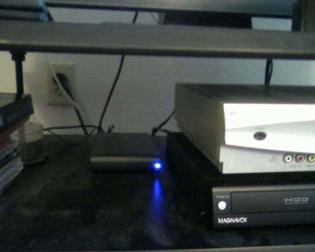

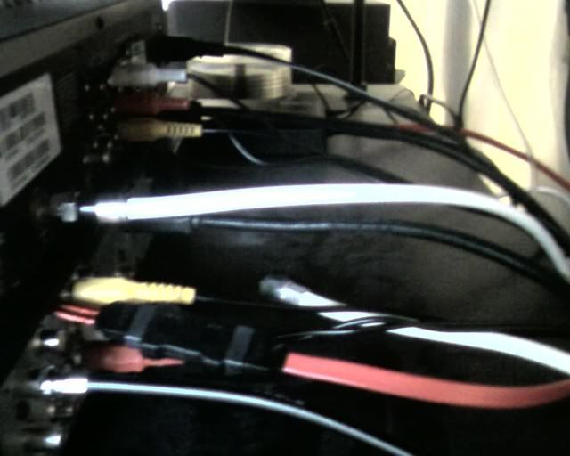

woohoo! A V.Skip 079 and its working!
My setup for an eSATA 2160A rig
Parts:
based on auskck's:
The Standard Recommended HDD lists apply - http://www.avsforum.com/avs-vb/showp...39#HDDTableIII
FYI, since I'm using eSATA, the power requirements don't matter. Any 7200rpm drive should work. But you may definitely be "on your own".
For the cables, I bought both available lengths, to assure I had all options covered. This is a personal design choice I believe. All cables connect inside the case, or they connect out of the case.
I am only implementing a single eSATA drive today. In the future I may switch to a toaster or multi-case.

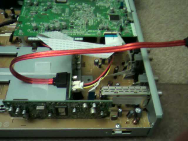

2160A eSATA HDD Modification:
  1. Power off and unplug. Let sit for at least 10 min. to drain all residual/Standby power.
  2. Remove the top cover of the 2160A - ~ 8 screws
  3. Touch case to discharge any static electricity before you touch inside components.
  4. Note - I recommended verifying that you do not easily trigger static electricity when moving around (as is common in the winter) before deciding to proceed. Increasing the humidity (to ~40%) is the appropriate way to decrease this effect/risk.
  5. Carefully detach the delicate data cable from the top of the hard drive were it is held down by double sided tape. I used a large safety pin to get leverage and perform careful lifting. Razors may work better. (danger! danger!)
  6. Unclamp and disconnect the delicate data cable by flipping down the tiny plastic flap covering the cable in front. (go see the pics for this)
  7. Unscrew HDD mounting bracket - 3 screws.
  8. NOTE: Get ready here. I found myself holding multiple pieces in the air to avoid ANY risk of shock/damage. If you KNOW better, then do as you please.
  9. Carefully lift the drive (with bracket) avoiding all the circuitry on both sides. (think Operation)
  10. Remove the tape on the HDD bottom holding the SATA adapter to the HDD. Salvage if possible (for reuse)
  11. Unplug the SATA adapter from the HDD. Pull straight out by both sides.
  12. Remove old HDD from the HDD bracket - 4 screws.
  13. Remove the ground contact from HDD - 1 screw.
  14. Store HDD elsewhere.
  15. Reinstall HDD mounting bracket - 3 screws.
  16. Attach the SATA adapter to the HDD mounting bracket in the same location/position as originally. Use the tape once holding it to the HDD.
  17. Carefully plug the the delicate cable into the SATA adapter. I strongly encourage securing the SATA adapter before doing this!
  18. Plug the M/F SATA Cable into the SATA adapter's SATA connector.
  19. Choose to test out the change or to Hack the Case.

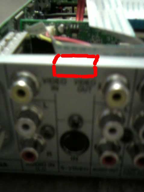

Hacking the case
  1. Note - Wear safety equipment. Safety glasses and work gloves are recommended. All cut surfaces become very sharp!
  2. Practice using the tool with a piece of paper inserted between the nibbler blade (punch) and its case. Notice the shape of the cut piece, the gaps from tools edges to blade, and the technique.
  3. Start with the first four items (1-4) on "2160A eSATA HDD Modification" above.
  4. Mark the boundaries of the cuts you want with a pencil. (http://i940.photobucket.com/albums/a...00907271-1.jpg) Make sure that this space is sufficient for your SATA cable plus the lip of the case top. Make sure that the backside of your marked area is fullyexposed and doesn't have any internal parts covering it.
  5. Invert (upside down) the nibbler tool and placing its blade underneath the case hangover, use slow firm pressure with both hands to cut the leftmost portion of the case hangover you wish to cut. Don't lose track of the gaps from the side edges of the nibbler to its blade (a few mm). The waste should not fall into the case due to inversion. Carefully remove the tool from over the case and extract the waste from tool (if needed).
  6. Review your cut (it should be rectangular to the case edge) and cut any corrections needed (such as "more left").
  7. Move nibbler to right and line up rightmost edge of nibbler blade to your pencil mark. Cut.
  8. Repeat the cuts moving further "into the case overhang" (from left to right recommended for righties) until the case overhang has the entire section cleared you desire.
  9. Once the case overhang has been completely cut as desired, you will use the tool from outside the case, in a "typical fashion", to cut "down" the backside of the case. Make sure you have penciled the area to be cut.
  10. Repeat cuts on backside of case until complete. (http://i940.photobucket.com/albums/a...nibbled1-1.jpg)
  11. Verify that SATA cable can fit through hole with case cover on. (http://i940.photobucket.com/albums/a...aldesign-1.jpg)
  12. File the edges if you desire. Not sure what to use for this but the edges are sharp!
  13. Someone may desire to install rubber grommets to protect the cable. This is a good idea, but you may need to further widen the hole to facilitate this. I have NOT done this but will consider it in the future.

My ghetto config
Next big question is if there is any staging that needs to occur to swap drives?
Or is it simply plug and pray?
FYI, since I'm using eSata, the power requirements don't matter. I just found a cheap 7200RPM SATA drive (SAMSUNG Spinpoint F3 HD502HJ http://www.newegg.com/Product/Produc...82E16822152181) and used that.
@ wajo - Thanks! There isn't a true full slot, there is a tiny lip in the "best section" (straight back from the "official location" IMHO) and will require dremeling in order to assure that pressure doesn't slowly slice your cable open! (or bend it horribly)
Way to go again... on your way to a HDD Farm!
To become a "HDD Farmer" requires only formatting other drives. Auskck takes his FIVE drives back and forth from LR to Bdrm, a 3575 and 3576.
One thing no one has PROVEN yet is whether you can interchange HDDs between a 3575/3576 and a 2160 (or even 2080). Theoretically a slam dunk but that wasn't enough for WMD in Iraq!
For people doing an external config., I wonder if the "cleanest" way to create an opening for the cable, one that produces no fine metal particles, is to make two small cuts (with tin snips?) along the top edge and fold that section down (with pliers?)... that'd create an opening AND provide a smooth surface (bottom surface anyway) for the cable to exit?
Important Note: Scotty, please use one post... the one above would be great, leave the WOOHOO!... when you have time, to describe your project like the other Pioneers and keep everything in that post by Editing as you make changes, etc. That way, I can add you to the Pioneers list and link to a single post for info other can use.
post #7695 of 23750
Originally Posted by scottypa View Post
I've just received the necessary cables and connectors, but failed to notice that some dremeling is necessary for an optimal config. The case cover can be half on (for dust protection but angles off on the side where the cable exits. Not too bad for a temp rig, but if you have dust issues like I do, it ain't no good!
Hopefully I can borrow someones tools soon.
I had minimal trouble with moving everything inside, although a more consolidated guide is needed for this process IMHO - especially the case hackery!
I've removed the old drive from inside, and will test it externally after I try a empty eSata drive (just in case of sparks or JICOS )
I'm minutes away from trying an eSata drive. Thanks for the inspiration auskck and other adventurers!
Did you take pictures? 2160A is a little different so it'd be really useful if you haven't put the case back together yet. I was asking (way back) about how to close the case, too, cause I'm not that handy with, nor do I have special drills, tools, and the like, but I'm pretty good at plug & play! This sounds pretty straightforward.

Let us know how you create an opening after you've done it (whether you used wajo's suggestion).
