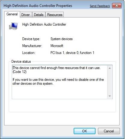

Based on recomendations I went with the ASUS 4550 and really like the picture quality. I have been trying to get the HDMI audio woorking with no luck. I think I am having the same problem as BigWorm above. I think I know what the problem is, but have no idea how to fix it. I should say that I am running Windows 7 beta.
When I try and install the RealTek HDMI audio driver (after the video card driver and Realtek drivers and several reboots....) I get a message that says "No Driver that supports the driver package was found" or something very similar. The installation just stops.

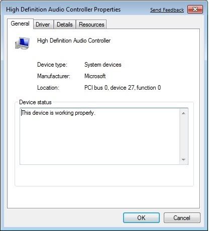

I went to Device Manager and found what I think is the cause. I see a yellow sign on the "High Definition Audio Controller" properties of PCI Bus 1, device 0, function 1. I assume this is the ATI's audio controller? Not sure what resources I could free up or disable to make this work. Here is a screen shot:
Below this entry is another High Defintion Audio Controller that appeares to be working normally. I assume this is the onboard audio - here is a screen shot:
I have tried disableing the onboard audio and rebooted serveral times. I have tried the auto and enabled options with no luck. Does anyone have any ideas? I am not sure how to free up enough resources to make this work. If anyone has any ideas please let me know. It is important to me to get this working to get audio to my TV. I am not interested in 5.1 just 2 channel over HDMI.

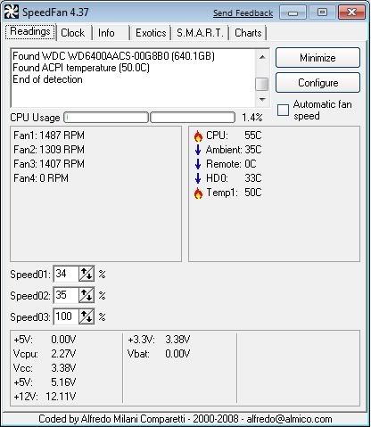

Also - It seems that based on may posts about temperature, that my box is running very warm. Anywhere between 55-57C under normal conditions - no heavy load like transcoding or the like. I have re applied the Arctric Silver to make sure I have a secure fit, but I get similar results. The side fan is pulling in and the top fan is blow out as many have recommended. Mine was like this when I got it. Anyone think this is too warm? Speedfan Shot:
Thanks again for everyones hard work. Let me know if you have any ideas on these problems. Thanks

I have exactly the same audio issue. Same error, same duplicate HD audio device, same pounding my head against the wall. One is the device for the on board audio, the other is for the one on the EAH4550. I have:
1. Disabled and re-enabled everything that can be in the BIOS.
2. Physically removed both tuner cards and the SATA card I put in for the LG drive.
3. Tried waving worry beads, chicken feathers, and a crucifix over it.
I have tried this with XP MCE, and with Windows 7 Beta that I'm trying out (detailed review on this to follow).
Nothing works. We now have two data points, though. I'm about to think that this motherboard just isn't capable of supporting that audio controller, which means we may have reached the limit of what the mobo is capable of.
Has anyone with a z560-series machine tried the EAH4550? With a different mobo, you may have different results.

Any ideas on CPU temp? Is yours run that hot?
Cheers

Is this the message you guys get during the installation of the Realtek ATI HDMI driver?
The picture from this post. His mb is MSI RS480M2 Radeon Xpress 200 chipset Socket 939 mb. He also tried to install driver manually (this post and subsequent few posts) with no luck. If so, it looks like this is common to a couple of older mbs. I don't know a fix. Maybe changing mb is the only fix?
BTW the HDMI audio driver built in Windows works for only stereo LPCM.

@ renethx and emerlin,
Unfortunately, that didn't help. The HD Audio Device Controller still shows the Code 12 error, even with the Realtek drivers. The ATI HDMI Audio Device that's supposed to be there, isn't. I'm guessing that this is because the HD Audio Device Controller is its dependency device, and until that can start properly, the ATI device won't show up.
So, I'm stuck. Like eMerlin, I've tried everything I can think of to get that device to not have a resource conflict, but because the Microsoft driver troubleshooting is, shall we say, a bit slipshod, I can't even really tell what it's in conflict with.
TrueHD and DTS-HD are not required, but they would be exceptionally helpful. I'm just beginning to think we've reached the limit of this mobo's capability. Anyone at all have any flashes of wisdom?
