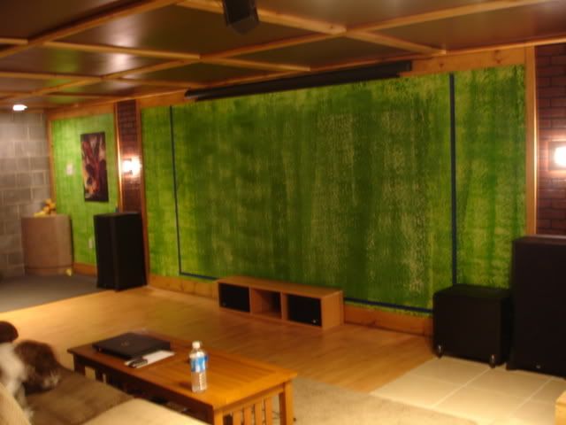

I can't really see your seating very well, but I'm guessing you will probably want to turn your L & R speakers in so they're directed more towards the seating.
post #12 of 44
Off topic a little, I'd consider getting some kind of sound treatment on that concrete wall, which will help you more than any center channel decision.
How big is that screen going to be? It looks like it's going to be huge!
post #13 of 44
oh i didn't know that wall will have much impact on the sound, i was planing on grafiti that wall. It is lead to the stair way so i can't put any stud and built drywall there. and i couldn't afford those sound accoustic panel either.
the screen is 147 inches in full mode, here is the picture of it in 2:35:1
post #14 of 44
I like the setup, I wish I had the room to do a screen that big. That's what I get for finishing my basement before considering a home theater.
The wall might not be a problem, I just know that generally speaking concrete can sometimes have adverse affects on the sound, maybe others can chime in on whether or not they notice a difference in similar situations.
