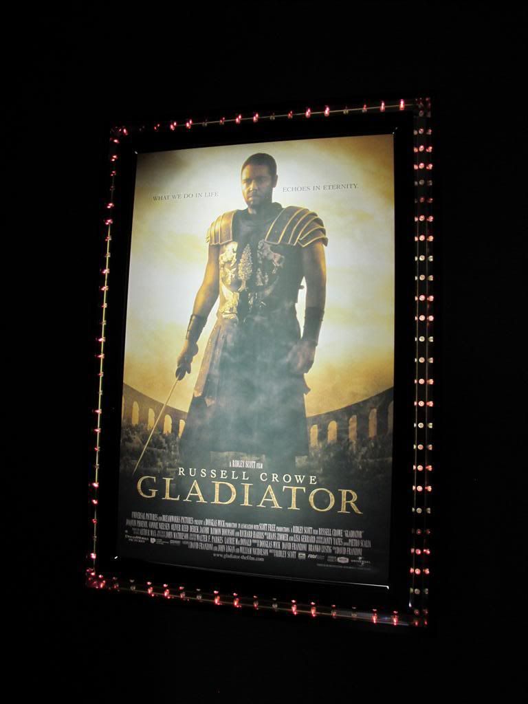

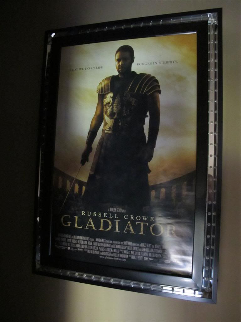

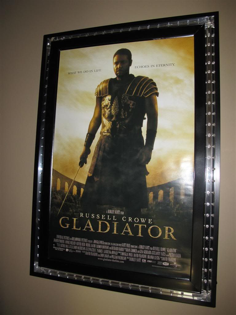

I realized that I had not posted photos of my BassIndustries Lighted Poster box refurbish. I finished this box a month or so ago, and purchased a cheap poster of Gladiator to get it up on the wall with some semblance of being done. I mounted it on the stairway down into the basement. You go 12 steps down, then there's a landing. The stairway turns 180 degrees and continues for 12 more steps.
Here are some photos:
In the end, the refurbishment cost about $130 including a new flourescent fixture with bulbs, new chase lights, and paint! I saw one of these on the web for over $1600!
It looks really good. I will be looking for a couple of double sided posters for the frame...that should make the poster really pop!

Poster setup looks very good. You say it is refurbished, I assumed you picked this up used ?
Wishing you and yours a Merry Xmas and a great New Year!
post #1511 of 1628
Merry Christmas to you and your's as well!
I picked it up on firesale when a local video store was goin gout of business. I think I paid $35 for the unit (I purchased two). It was in rough shape. I cannibalized aprts from two to make one working unit. I disassembled it, sanded and painted it, replaced the flourescent light and bulbs, as well as rewire it and add a switch to the outside (so I sould easily turn it on and off without opening it). After new chase lights, the unit was as good as new!
