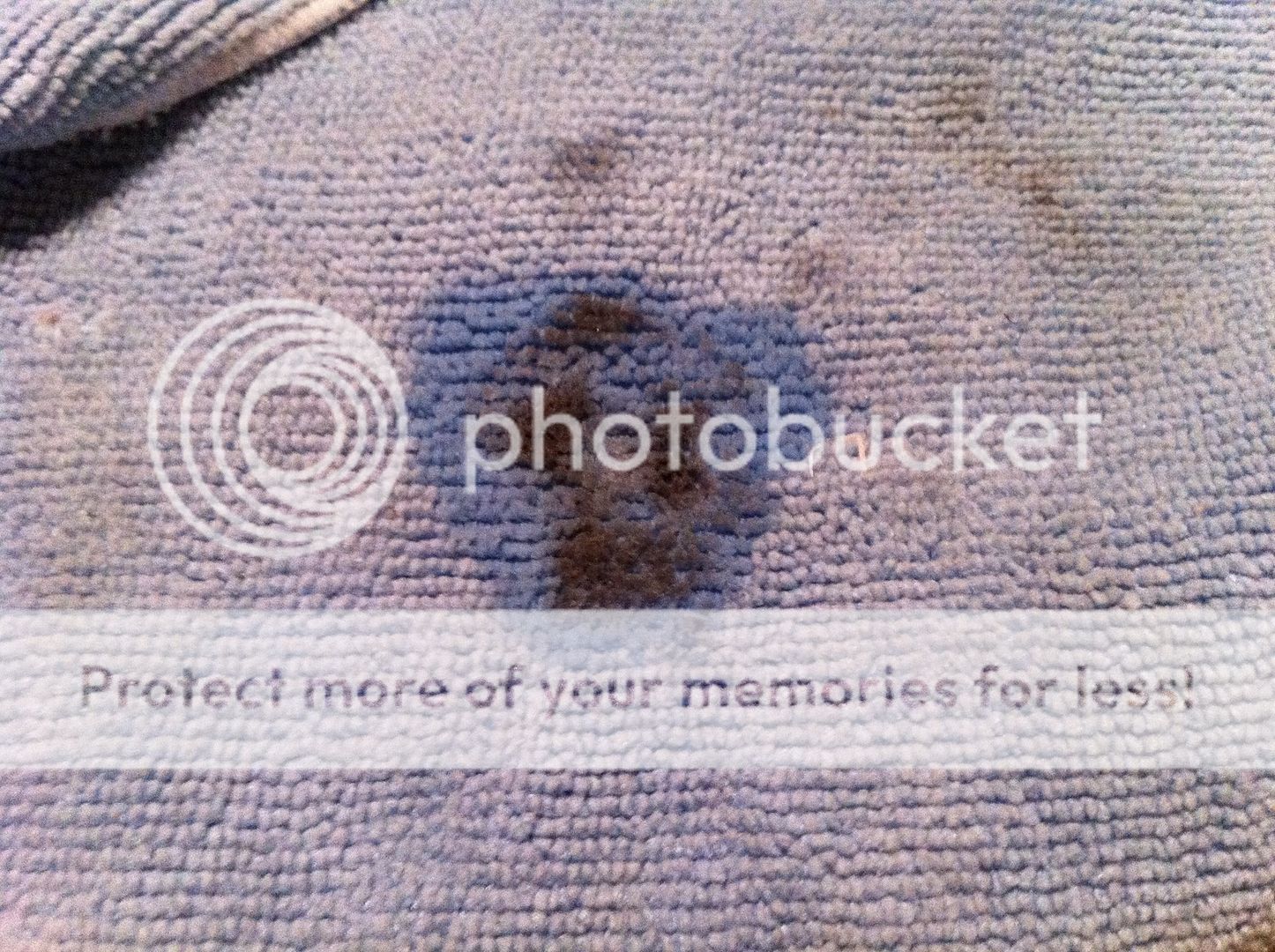

Take advantage of this opportunity to CLEAN YOUR PRISM! If you look straight in the opening where you're about to shove your lamp, you will see the glass prism. Take Isopropyl alcohol wipes, or use a microfiber wet with isopropyl alcohol, and clean the prism. Then wipe down with a clean microfiber or lens cleaner. I didn't think mine looked too bad until I saw what was on the cloth
Photobucket
Step 9:
Once the prism has dried, reinstall the lamp using the 2 mounting screws, then screw on the lamp door.
