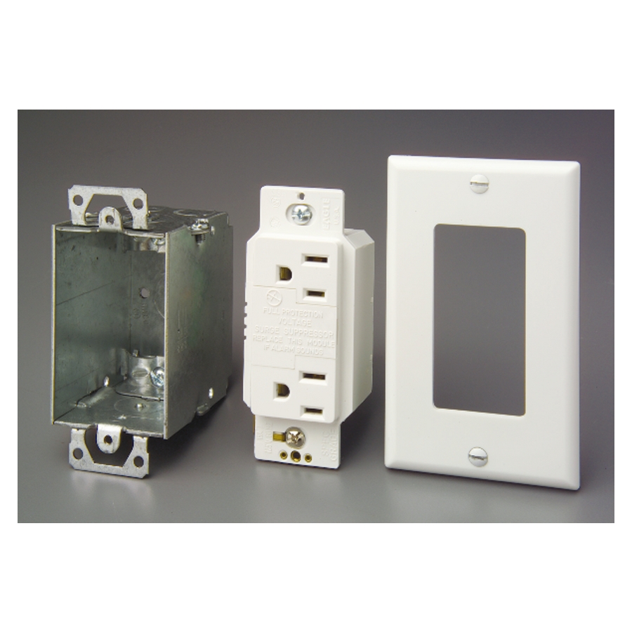

There's a new option from Midlite if you want more color choices and single-gang installation. It's about on par with the PowerBridge in pricing, maybe a bit more expensive depending on your configuration. UL listed and no modification required.
Décor Recessed Receptacle and Power Inlet Kit
Kit:
Separates:
I went with 2 black inlets and a single black recessed outlet for my setup.
Both the inlets will go in my equipment room, with 1 inlet wired to 2 standard outlets behind my screen wall for the subs and the other inlet wired to the black recessed outlet at the projector location.
I also bought one of these in black for the low voltage projector wiring:
Though, I'm thinking maybe I should have gotten one of these:
Oh well...
I got mine from MCM. They're just starting to stock these, so they were back-ordered for a few weeks, but I finally got everything today. They seem really well built. I can post pics if people are interested.
-John
