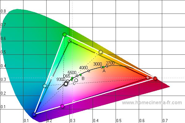

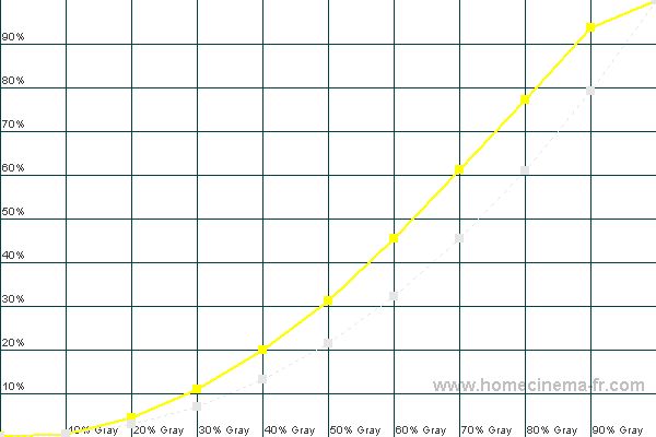

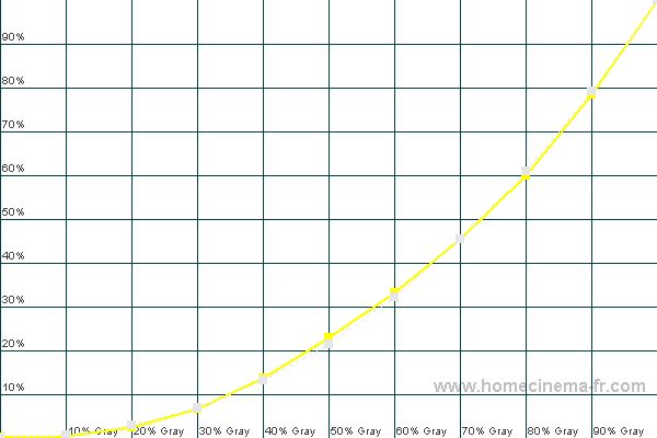

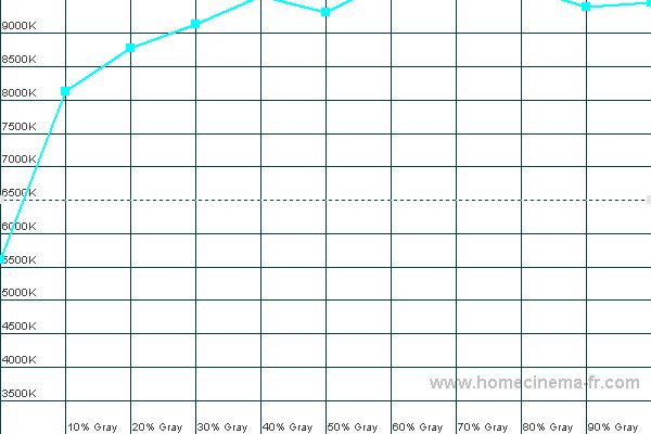

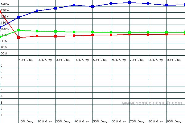

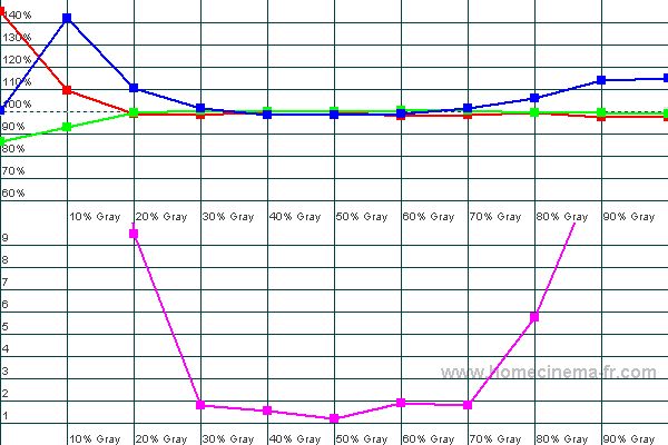

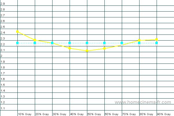

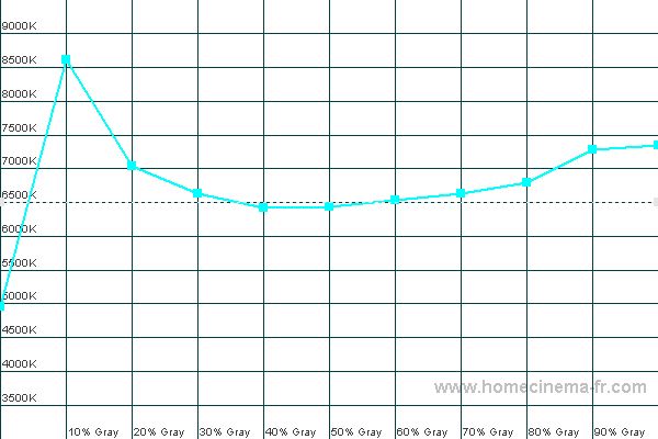

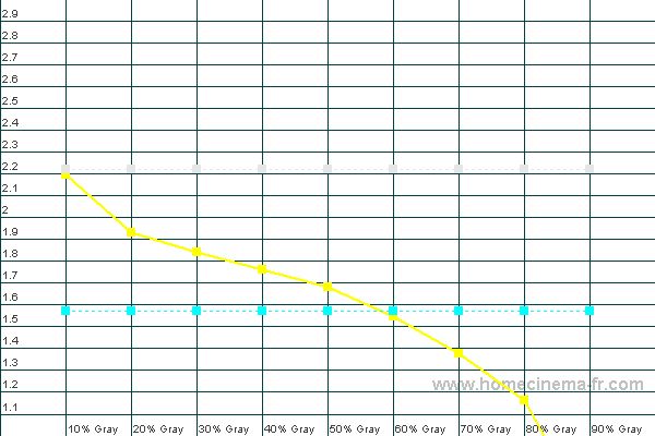

I was able to spend only about 45 minutes working on someone's TH-50PZ750U with my EyeOne Display LT colorimeter and HCFR. I'm heading back soon to do some more tweaking, but in that short time I was able to improve the picture quite a bit. Grayscale is nearly flat from 20 IRE to 80 IRE, but you'll see I can improve it a bit more. One problem I noticed (and also read about) was that when I made adjustments in the service menu's white balance controls, I would get different readings after getting out of the service menu than when I was in the service menu. So for now I made a combination of changes in the service menu and user menu white balance controls.
RGB Levels before:
RGB Levels After:
Color Temp Before:
Color Temp After:
Gamma Before:
Gamma After:
Luminance Before:
Luminance After:
CIE Diagram Before:
CIE Diagram After:
After I get back and finish the calibration, I'll post my results.
-Carl
