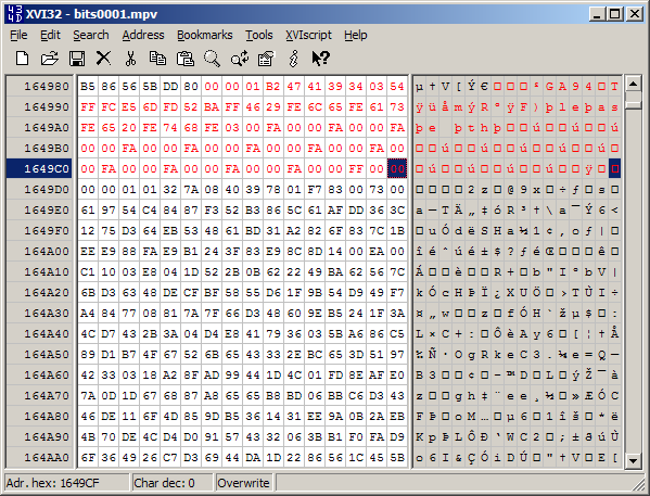

post #56 of 226
Originally Posted by dmulvany View Post
I've heard references to EIA-708B captions; perhaps those are the specific captions that are advanced, while the EIA-608 captions are supposed to be included along with the EIA-708B captions to form the entire EIA-708 standard? I'm having trouble finding clear information about this.
The ATSC specification is available here:
http://www.atsc.org/standards/a_53-P...-w-Amend-1.pdf
See section 6.2.3
The EIA-708B specification isn't public. However, I can show you how it works with a bitstream example.
I've highlighted the caption data in red. Here's the breakdown.
00 00 01 B2 = user_data_start_code
47 41 39 34 = ATSC_identifier ("GA94" in ascii for Grand Alliance 1994)
03 = user_data_type_code (0x03 = cc_data)
54 = 01010100 = process_cc_data_flag = 1, additional_data_flag = 0, cc_count = 0x14 or 20 decimal
FF = reserved
FC = NTSC line 21 field 1 (EIA-608)
E5 6D = two characters of cc_data (the letters "em" in the CC1 service)
FD = NTSC line 21 field 2 (EIA-608)
52 BA = two characters of cc_data (some other service, possibly XDS)
FF = DTVCC packet header
46 29 = two bytes of DTVCC (EIA-708)
FE = DTVCC packet data
6C 65 = two bytes of DTVCC (EIA-708)
61 73 = two bytes of DTVCC (EIA-708)
65 20 = two bytes of DTVCC (EIA-708)
74 68 = two bytes of DTVCC (EIA-708)
03 00 = two bytes of DTVCC (EIA-708)
FA = cc_valid = FALSE
00 00 = filler
The FA 00 00 sequence is repeated 11 more times to fill out the cc_count of 20.
FF = marker_bits (end of user_data)
00 00 = stuffing to align the bitstream
Ron
