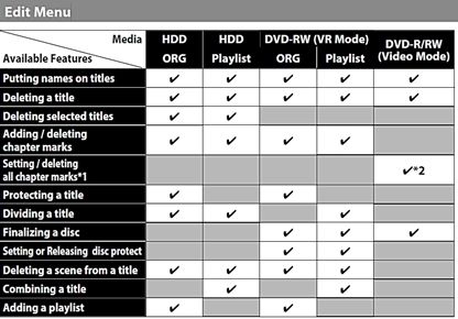

Magnavox 9th-Gen and Last Std Def HDD/DVD Recorder, MDR557H/F7, Single Analog/Digital Tuner
When logged in, all links herein will work if your User CP > Edit Options > Number of Posts to Show per Page is set to 30, the default... should not affect Guests and others who don't log in. Since editing old Huddler HTML pages with this site's new VB SW breaks formatting, internal links and tables, the operating differences between this new 557 model and previous models will not be detailed to the extent I would like.
There are some IMPORTANT differences between this new 557 and previous models:
  1. Video/VR-Modes (+VR gone) - Records in standard Video and VR modes like Pioneer, Panasonic, Sony, etc., not +VR Std like other 8 generations. NOTE: This means it will not recognize UNFINALIZED DVDs from previous generations... it will recognize all FINALIZED DVDs.
  2. Multiple Playlists - Create multiple playlists (virtual copies of original titles) on HDD or VR-mode DVD-RW discs using new "Add To Playlist" option in Title Menu (see menu pic below). Make edits on virtual copies if you want to keep originals intact. Assemble playlists for playback or dubbing. Switch Title Menu between originals and playlists with Title > Disc Menu button. Deleting an original title deletes all playlists in which it appears.
  3. Editing menu - adds Combine Titles option for HDD and VR-mode DVD-RW. Places combined titles in virtual Playlists, keeping originals intact. If any of the original titles are deleted, their virtual, combined Playlist titles are also deleted.
  4. HDD menu - adds a "Delete All Playlists" option.
  5. Disc Edit menu - adds new option for VR-mode discs: "Format" and "Delete All Playlists " options.
  6. DVD-RW disc initialization - adds option for Video or VR Modes... Video mode for "DVD Player Compatibility mode" or VR mode for "Editing possibility mode."
  7. Recording menu - new option added for Aspect Ratio (Video mode): Auto, 4:3 or 16:9. "TV Aspect" setting still in Video menu so new combo might now allow a 4:3 TV to letterbox 16:9 shows with the TV's aspect setting?
  8. New rec modes - 1, 2, 4, 6, 8 hours.
  9. +R/+RW DVDs - contrary to manual, THE 557 DOES RECORD TO AND PLAY BACK DVD+R AND DVD+RW, even though they're not listed as either Playable or Unplayable in the manual. See one user report here.
  10. Gone - EMPTY SPACE or EMPTY TITLE ON DVDs! DVD Title List now looks exactly like HDD Title List... 6 index pics per page, representing 6 real titles. Manual doesn't even mention "Empty" anything like 53x manual does (in many places)
  11. Gone - Index pic edit options.
  12. Gone - Scene Delete on Video-mode DVDs (still OK on HDD and VR-mode DVDs).
  13. Gone - Make Recordings Compatible and Make Edits Compatible.
  14. Gone - DVD-RW Erase option (replaced by Format option).
  15. Gone - DVD-RW Unfinalize option.
  16. Gone - Some erroneous entries.
New "Add To Playlist" Option in Title Menu. Create Playlist Copy of ANY Original Title.
In Title menu, switch between display of Original or Playlist titles with the DISC MENU button.

First off I just want to say thanks for the incredible wealth of information here. As for this new Magnavox 557 I'm glad Funai is continuing to produce these machines. I took a look at the new manual and noticed a few things though.
The new Aspect Ratio setting is something I've had on my Toshiba DR430. It sets the WS bit so that the widescreen recorded disc will play properly on 4:3 TV sets and 16:9 sets without manually setting the TV to Wide to stretch it to the proper ratio. It's a nice feature to have but it only works on DVD-R/-RW media and not DVD+R/+RW. Leaving the setting on Auto will automatically set the bit if the player is fed a widescreen signal and won't if it's fed a 4:3 signal.
I found a couple of things that might be troubling if I'm reading the manual correctly though. On page 42 it lists the available recording options as 1, 2, 4, 6, and 8 hr instead of the previously available 1, 2, 2.5, 3, 4, and 6 hr options. Also on page 41 it lists DVD-R/-RW as the only recordable discs compatible with the unit. There's no mention of DVD+R/+RW discs making me think they dropped support for it. Just to double check I looked at the manual for the previous 53x model and it lists both + and - media as compatible.
TreeVideo likes this.
PhilMag manuals have had many errors, omissions and misleads over the past 8 generations of these DVDRs, so I hope these "odd" changes are the same in the 9th-gen model.
It's suspicious that DVD+R/RW, which Philips helped invent, is not mentioned anywhere in the manual, even in the Playable and Unplayable Discs sections.
I also don't know why they'd take a step backwards to their old rec modes (DVR640 et al)... don't they know it screws up a bunch of my tables. :D
Here's hoping the same manual writer who did the other 8 gens did this one too!
I was reading through the new section on combining titles in the manual for this new 557 model. I noticed on the previous page about dividing titles it says once a title has been split, it can't be joined back together. That's sort of a contradiction if you can now combine titles. It's probably something left in from the old manual that they forgot to update. Of course it's not likely it would ever matter anyway.
Thanks for finding yet another error... it actually gives me hope on the other things! :)
