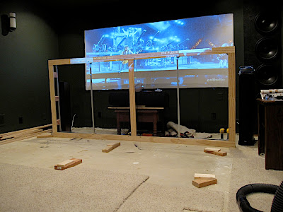

My build thread 130" DIY Curved Screen with structural extruded aluminum metal framing documented my issue with humidity induced warpage from post#70 Jan-2010.

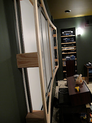

I tried countermeasure Jan-2011 by sealing the wood/lamiante, but did not work.
Now, this summer I'd like to "fix" the warpage/bow by going to some painted/cloth screen.
(it's a slight issue, but I want it gone)
I will salvage this metal/wood curved frame (and it's border and masking) via router the laminate away.
The metal/wood hybrid curved frame will still slightly "move" during humidity months of June-September here in Michigan, but with cloth under slight tension I'm hoping that will not be an issue.
So, MM/tiddler/others;
I'm open to your experience, advice, guidance.
My timeline for this is planning/discussion June, and possible over July 4 big (4) day weekend to do the actual work.
Summary of my thinking:
I'll take a router to the DW laminate as seen here, remove it,
And have this frame as basis for attaching whatever painted/cloth screen is best for my Sony VW60 in light controlled environment.
Will start from this:
