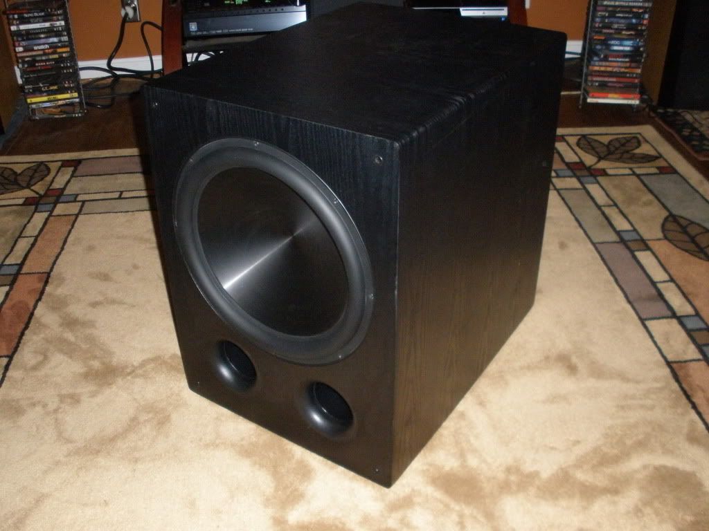

About 3 months ago Brian from Rythmik Audio was gracious enough to send me this sub to test. This is the same exact unit from the Audioholics test earlier this year. It is a dual ported subwoofer with a 15" driver and a 600w rated amplifier that employs Rythmik's signature direct servo feedback (Visit Rythmik Audio for more information on this.). It is the largest and most powerful vented sub in Rythmik's lineup and comes in at $1199 plus shipping. The sub has a black oak finish and is quite chunky weighing in at 120lbs shipped and to be honest it felt like a little more than that. I had to pick it up to load it in and out of vehicles single handedly more than a couple of times and it is a bear for one guy. The dimensions of this sub are 18"(W) x 24" (H )x 24"(D) - (26" D with grille and heatsink). I don't consider that excessive or even large for a subwoofer but I am probably a little skewed on that subject. The 2 ports are flared and of 3.5" diameter and they extend deeply into the cabinet. The driver is a quality piece sporting a black anodized aluminum cone, a rubber surround, a 12 spoke cast basket, and a generously sized motor with double stacked ferrite magnets, aluminum shorting rings and a lightweight 4 layer 3" voice coil. The enclosure is heavy and inert with adequate bracing. The amplifier also appears to be a quality piece. Overall a good bill of parts to make some quality bass.
Now... Normally I would put this information on Data-Bass and not create a thread like this but the update and overhaul of the site is taking longer than anticipated and Brian has been patiently waiting while we sit on the results for the last couple of months, so I figured it more fair to go ahead and just put the information out there and get it added to Data-Bass later.
A few notes about the tests...
1.) All output tests are conducted outdoors in a large field with the nearest boundaries and large objects at-least 60ft away if not more and the microphone at a distance of 2 meters from the closest edge of the subwoofer unless noted as otherwise.
2.) CEA-2010 results are at 2 meters and have 3db subtracted to approximate rms levels. To compare with peak values add 3db. To compare with 1 meter results add 6 db. To compare with a 1 meter peak result add 9db.
3.) All measurements and data presented have either no smoothing or minimal smoothing applied. (1/48, or 1/24th octave if any at all.) This will not result in pretty flat graphs like you are used to seeing. It will show more detail.
4.) The sub was tried in both the upright position and laying on it's side. Laying on it's side gave marginally better results so all tests were conducted with the sub in that orientation.
5.) The arsonist had oddly shaped feet...

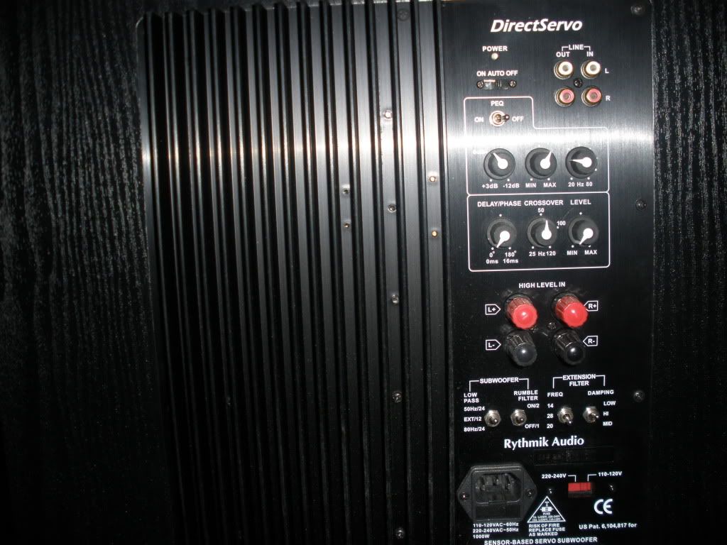

I took a full set of measurements for this sub in both 1 port and 2 port open modes. These are the results for 1 port open operation. Applying the supplied foam plug to one port results in a very low tuning and seems to be near to 14hz or so. The foam plug was inserted into the top most port with the subwoofer laying on it's side. The settings on the amplifier were set as follows for all of the 1port testing.
Power set to the "On" position which defeats the limiter.
PEQ set to off
Delay/Phase set to 0
Crossover set to the maximum 120hz position
Level set to 12 o'clock
Low Pass set to EXT/12
Rumble Filter set to Off/1
Extension filter FREQ set to 14
Extension filter damping set to LOW
Here are some measurements showing the effects of the various amplifier settings on the subwoofers response.
Effect of crossover settings
Effect of low pass filter switch
Effect of damping settings
Effect of extension settings
Effect of various PEQ settings
As you can see there is quite a wide range of adjustments that can be made to the response of this subwoofer and that is not even counting changing from 1 to 2 ports open.

To sum this whole thing up. This is a good sub. It is competently engineered, looks good, the components are of high quality and it really doesn't have any major holes in it's game. It has very deep extension especially in 1 port mode and has the output headroom to back it up. The distortion performance is pretty good up until the sub is overdriven. You can see in the distortion charts how it suddenly gets out of control and the cause of this is the driver simply being asked for too much excursion. Note the jump in 3rd harmonic distortion the driver is probably somewhere past 2" peak to peak excursions at that point and there could be some amplifier clipping involved at that point too. Everything has a limit and the driver used in the Rythmik is actually quite robust. The sub overloads gracefully and the sound changes enough to let you know that you've reached the limit. It appears that the amp and the driver give out at about the same time. If the input is reduced 2 or 3 db the sub goes back to it's normal quite good sound character. Some companies prefer to severely limit, and protect their subs to keep them from ever making any objectionable noises at all but that is difficult to pull off without also throwing away some potential headroom and dynamic tracking ability. I prefer the approach used here better. The sub performs quite well in either mode but I think that it is slightly better in 2 ports open mode. If you like to listen very loudly or have a large room to fill up I would recommend 2 port mode. If you have a more bass friendly room and or don't always listen at house party reference levels then 1 port mode is probably a better choice.
The sub performed flawlessly the entire time I had it and never shutdown or exhibited any unexpected quirks or issues. The 3 minor quibbles that I have with it are...
1.) No xlr inputs on the plate amp. Brian says this is being remedied in the future. Most of Rythmik's amplifiers already have balance xlr connections.
2.) It does not have a true LFE input that bypasses the internal LPF of the amplifier. Brian says they are working on this as well.
3.) Port area. During high output near the port tuning in 1 port mode the subwoofer will overload the single port and some port noise was audible. You can also see this port compression in evidence in the power compression graphs. The big dip is the port overloading. Otherwise the power compression performance is top notch. In 2 port mode there is still port compression at high drive levels, but the whistling port noise was greatly reduced and wasn't apparent until the final 115db sweep level. Now to be frank there really isn't much that can be done about this since it is governed by physics. The larger you make your port area, the longer the port has to be to achieve the same tune in the available enclosure volume. Also larger longer ports are harder to fit in the cabinet and also decrease your airspace seen by the driver. This almost always results in a compromise of vent size, length,tune and cabinet volume. In this particular case the ports used are probably what would realistically fit in the enclosure and achieve the desired tune. Passive radiator's are an option to get a low tune inside a small cabinet but they have their problems too. They are another moving part and a cone to potentially damage, they are much more expensive than ports which would raise the cost of the subwoofer, and it would no longer be a simple affair to have multiple tunings by inserting a plug.
