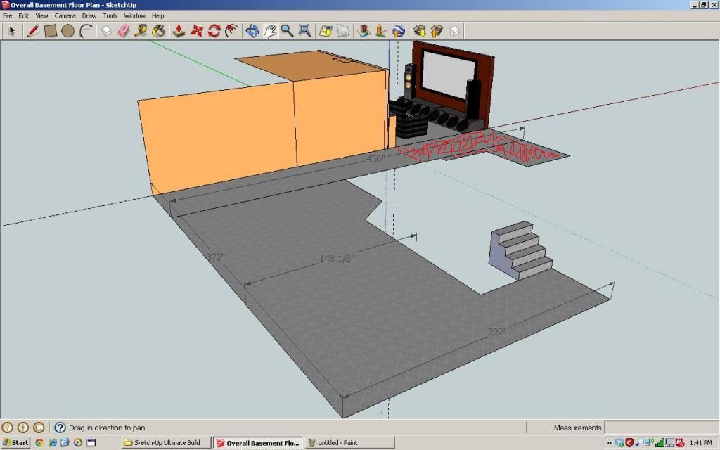

Ok guys…
I took a video of my basement space this morning for some perspective. Sorry for the horrible PQ. Cheap phone video. If you guys get a chance, can you verify that the links in the video work. They won't work for me here at my day job.
I didn’t bust out the tape measure, but I’m confident that my hall connecting to my theater is roughly 7ft wide. That said, I’ve layed out a few options for space calculations as follows:
Option 1
If I count the red portion in this sketch (in addition to my dedicated space) it will add on another 1,092ft^3 bringing the calculated space from 1,512ft^3 up to 2,604ft^3:
Option 2
If I extended it out to the end of the hall, as depicted in this photo, it will add an additional 560ft^3. Bringing the total calculated space from 2,604ft^3 to 3,164ft^3:
Option 3
Again, if I include the total basement, it brings me in the neighborhood of 6,900 – 7,000ft^3. The 6,904ft^3 I referenced in an earlier post was my best attempt at taking the measurements I identified in my basement layout sketch up, throwing them in an excel spreadsheet and guesimating with all of the unmeasured nooks and crannys. I’ll just stick with the 6,904ft^3 figure for now and if anyone would like for me to take the time to get more detailed, I will do so…
To recap based on the info provided above. Here is my potential scores depending on who wants to draw their own conculsion on what area should/should not be counted:
(HT Space) 1,512ft^3 = [email protected]
(Option 1) 2,604ft^3 = [email protected]
(Option 2) 3,164ft^3 = [email protected]
(Option 3) 6,904ft^3 = [email protected]
What say you all? Feel free to use whatever calculation/score you prefer Dom.

So, I was thinking about the calculator last night... Partly because I love spreadsheets and partly because I'm a fan of standardization.
Since the concept of this thread is "ULF" score... What if an individual was to fill in the spreadsheet in it's entirety and post their results, yet you use a set standard (say 16Hz) as the bench mark to be included in the above consolidated list?
I'll give you a few examples of what I am thinking...
Example 1:
SVS PB-13 Ultra x 2, 3000ft^3 Space
Scores:
N/[email protected]
[email protected]
[email protected]
[email protected]
[email protected]
[email protected]
Example 2:
LMS-Ultra x 2, 3000ft^3 Space
Scores:
[email protected]
[email protected]
[email protected]
[email protected]
[email protected]
[email protected]
Here is where I think it get’s interesting from a “ULF” score stand point. Let’s say we arbitrairly remove the 10Hz score from the LMS-U. Looks what it does to the numbers:
Scores:
N/[email protected]
[email protected]
[email protected]
[email protected]
[email protected]
[email protected]
Note, that by removing the 10Hz response it increases the numbers across the board. May not seem fair to individuals lacking response down super low, but do you think it's applicalbe to the "ULF" topic at hand? Just thinking out loud I guess...something else to consider.
SupaKats likes this.
popalock is offline
post #47 of 5119 Old 08-29-2013, 06:44 AM
MKtheater's Avatar
Location: New Hartford, NY
Posts: 18,300
Mentioned: 134 Post(s)
Quoted: 2307 Post(s)
Liked: 2241
Yes pop, you have a point, if we HP our systems so the 10hz and below is filtered out it would give us much more headroom above.
I knew you had walls in there, I would option 3 and not the whole basement as that long hallway will divide the rooms, although option 2 might not be that different.
