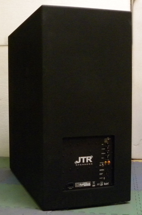

These have been on JTR's website for a while. Thought it was time they deserved their own thread in anticipation of a great value for an extreemily high performance subwoofer from a reputable builder.
At $1,999 for dual DSP optimized 18" drivers and a 1400 watt amplifier it's a monster of a deal!
Over 110 Db @ 16 Hz
Over 115 Db @ 20 Hz
Over 118 Db @ 25 Hz
Over 125 Db @ 32 Hz - 80 Hz
Here's the info from Jeff's website:
The Captivator 218HT is a bass reflex subwoofer with two 18″ drivers that is for applications needing tremendous output.
  • Two 18″ subwoofer drivers
    Bass Reflex Design tuned to 18hz
    Heavily braced cabinet
    Huge slot port for minimal turbulence and compression
    Completely front firing for versatility
    Built in 1400 watt RMS, DSP optimised, class D amplifier
    RCA and XLR inputs
    12 volt trigger and auto turn on
    120V and 240V compatible
    Magnetically attached grill
The 1400 watts amplifier is equipped with a full digital sound processor that has been optimised to the smoothest frequencey response and highest possible output with minimal distortions.
Frequency: +/-1db (half space) 22-150hz (tuned to 17z)
Sensitivity: 100db, 1 watt, 1.41 volt, 2 ohm
Amplification: 1400 watts RMS (Dual ICE Power 700ASC modules)
Connectors: XLR and RCA
Dimensions: 40.5″ x 19.75″ x 40″ (HxWxD)
Weight (shipping): 215 lbs.
Exterior Finish: Matte Black Paint (custom finishes available)
Construction: 18mm, 13ply, void free, Baltic Birch (Several times stronger and more expensive than MDF)
Warranty: 5 year Manufacturer defect (amplifier 2 years)
MRSP (each): $3998
Manufacture Direct: $1999

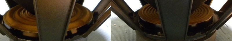

The Eminence 18" basket only has clearance for 24mm of inward travel so other manufactures are simply using a linear, 7.25" o.d. spider to limit travel. We have negotiated modifications to increase the inward clearance to 30mm which allows us to use a better, progressive, 8" o.d. spider. The suspension is capable 28mm of travel and the coil to back plate clearance is 31mm (bottomless).
The 8" progressive spider is on the left and the 7.25" linear is on the right:
There maybe some that look at this driver and think that it's just a pro driver however it really is a hybrid that is around 10db more efficient than a typical home theater subwoofer driver and has just the right amount of excursion for it's intended purpose.
