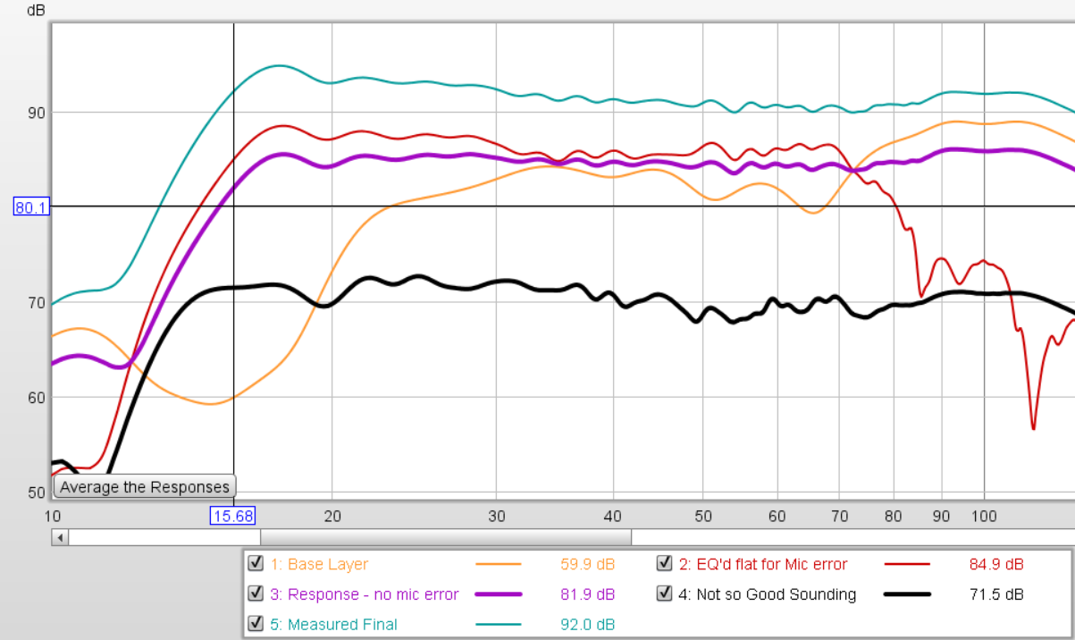

Here are the two subwoofers individually measured with no crossover:
The red line is the one in the corner. The blue is in the midwall position where I want to upgrade to the Monolith 15.
Using the Audioholic specs the Monolith 15 has on average 10.6 db more output from 30-125 hertz. And we see from the above graph that the corner placement gives about 10 db more output over most of the bass range hence my hope to pair these disparate subwoofers in the same room.
What I'm going to next is to try to simulate how the Monolith 15 will work the corner boosted PB12. I am going to turn up the current midwall PB12 by 10.5 db and see if I can get them to blend well. This will work well down to about 20 hz where the gap between the two subwoofer models is only 9.9 db by the audioholic specs, but by 16 and 12 Hz well I can add 4.6 db at 16 hz to the final graph perhaps. No spec for pb12-nsd at 12.5 hertz, but on its own in theory the combo probably good for 99 db maximum output out standing in a field. My hope is that at that low frequency the Monolith will get 10 db of boost, but REW room simulation won't go that low so I'm not sure. With that boost, the combo would get close 110 db at 12.5 hz and I'll have to see if I can find a tool that might forecast the room boost. Right now from 23 hertz and up my dual PB12 setup gets 112 db maximum continuous output at the listening position, so my hope is to some how massage the two and take my 3 db down point to 16 hertz or maybe even 12.5 if the room has huge boost down that low.
May the force be with me and I'll update with some more graphics today as I progress with the test.

Well if I didn't have a minidsp and bought this sub this is what I show would be the result without massaging phase or doing anything:
We have the simulated new sub (the PB12 boosted 10.6 db) midwall as that red line with those peaks at 50 and 95 hertz standing above all. The corner sub is the cobalt blue and is same measurement from the post above. The fatter aquamarine line is the two PB12's averaged. And finally the thick black line is the simulated Monolith summed with the corner PB12.
Right away we see the aquamarine line is much smoother than the the Monolith/SVS in room combo which makes a strong, strong case for the typical wisdom to have identical model subwoofers or at least ones with the same output. We also see that from 20 to 30 Hz we net about 3 db more output combined and if one imagines smoothing the response to average 92 db well maybe a three db down point of 20 Hz. So again without minidsp this upgrade is getting a thumbs down because its not getting me more output than just going to PB2000 Pro (worth 3-4 db) and in theory dual PB2000 Pros would get my 3db down point 2 hz lower.
Might as well check the subsonic benefit at this point too so at 16 hz the combined output of the PB12s stands at 74 db versus lets say 89 db for the hoped smoothed line, so -15 db. The Monolith/PB12 combo is 82.6 versus the 92 db flat response and of course we must add 7.1 db by the specs as the real Monolith will average in that much higher so we have 89.7 db versus the baseline of 92 so well it does look like 16Hz 3 db down possible.
Now these averages aren't the actual response of the two subs combined and assume no phase issues, so up next for the first time I shall attempt to massage the phase on my subs to get them to play better than before and hopefully achieve a smoother response with nearly the same output.

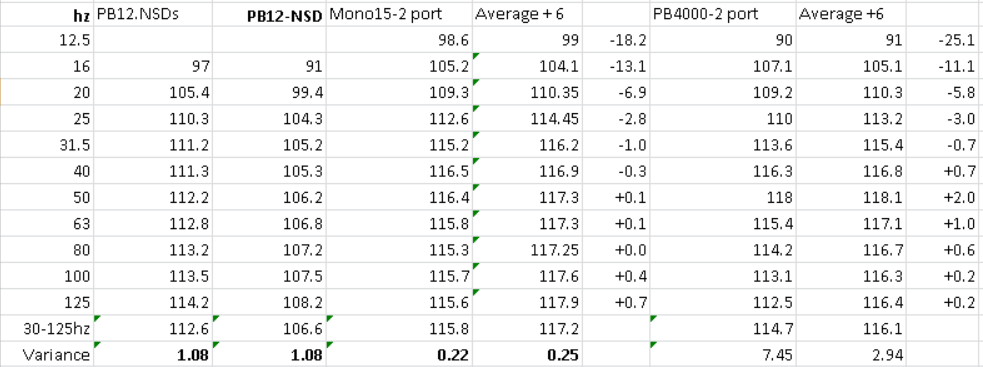

Before I mess with phase lets check the averaging specs for these subwoofers:
The theoretical of two PB12s is just the single PB12 +6. We have averages from 30-125 hz to get a feel for overall output level. And the variance of these over the same frequency range. The Average +6 is the average of the monolith and the single pb12 specs +6. The average +6 seems right in my mind, but that's not from the standard subwoofer playback. Certainly if you average two identical subwoofers it holds.
So from the above we see by the specs we are expecting the response to be -13 db for the combo at 16 hertz so its very nice that we have hopes of -3 db with the room boosting the Monolith 15 2 port mode as discussed in the post above. At 20 hz we expected -6.9 db down so the hoped for -3 db after smoothing is good. At 25 hz we show flat whereas the average responses show -2.8 db so another win.
Despite the rather raucous combined output this does look promising and boosting a bit at 20 hz and 16 of the Monolith is allowed since it still has good output at those frequencies, so perhaps a bit lower is possible. At 12.5 hz the PB12 in room average to 61.2 db. The measured mock combo stands at 69 db so nearly 8 db better. We don't have a 12.5 hz spec for the PB12 (measured too low versus ambient noise) so me just use a single Monolith 15's number which should be 18 db down and just a loss of 5 db from the 16 hz number. So -8 db down at 12.5 hz with some room for minidsp boosting and its possible the room could be helping that a touch more.

Well hopefully this images hosts for a while as I just got address from gmail I sent:
Dropbox is down right now so using this unreliable method of hosting.
Here is the 10.6 db boosted PB12 blended with the corner placed one and looks like 16 hz -3 db possible once you add the 7.1 db adjustment for the specs of PB12/Monolith 15 combo.
I'll now try to dig up measurement for the corner sub flattened and see if a single Monolith gets more extension. By the specs the PB12 only adds about 1.2 db of output to the Monolith, but that fails to take in the advantage of the corner which is worth probably 8-10 db, so probably gains 5 db at least over Monolith in middle wall. Monolith alone in corner would have 8-10 db advantage so 3-5 db more than this combo alone. But I don't need output and want extension so I'll dig up that measurement ... right now:
Oh daddy my sub combo has 13 db more output at 16 hz over the single Monolith simulated, but the single Monolith gets a bigger adjust than 7.1 db....... its gets 14.2 db, but that's still net about 6 db short of the combo so yes the combo gives more extension. I'll take it because that extension and about 5 db more output more than enough. 10 db more output is not what I want. 3 hz more extension and maybe more in my room will do. Hoping to net drop my 3 db down point from 21 to 14 Hertz.

In the 12.5hz range on your comparison numbers between the m15 and 4000, it would take 1.5 - 3 PB4000's to do what the m15 does by itself, and the m15 is hundreds cheaper.
I'm curious what a compression graph would show of your sub's (combined) current setup.
I think I've heard that below 15hz, for that bass to be impactful it has to be around 105db or better.
PB6000 can do 107 db at 16 Hz in extended mode and hoping my room boost gets that for me at the listening position. After getting attacked by that somewhat fatiguing juice bass at 15 Hz I'm not sure I'm reference material below 15 Hz and would welcome tactiles. This is all new to me and figuring out what I want. I've got plans to make some kind of Godzilla hover boss with sixteen 12 inch drivers. For now just ordered 4 and have amp that will given them 160 watts per channel each. That stupid boss platform is not just tactiles and might do 105 db or better down to 4 Hz. I'm not sure if I can take it so just starting with 4 drivers. If I go for 16 I think I run 8 per channel at 2 ohm load on inuke 12,000. If you believe the fairy tale specs thats 6000 watts per channel so over 700 per driver, but I think in reality it might cough out something like 2000 watts at 5 Hz.

I think you're doing too much. Keep this simple.
1- Place your subs where you want/feel gives you the best response.
2- start from scratch (remove all HPF, LPF, EQ, Room Correction such as Audyessey etc etc, set your Center channel crossover at max like 200hz, Sub distances to 0)
3- Gain match your subs first
4- then Phase match them (start both at 0 or however your subs have them labeled. In the Minidsp start adding delay to your nearest sub in increments of 1. Run a sweep in REW with Channel 3 (center wont play since its crossed high but both subs will) from say 10-100. Set delay to 2 and repeat sweep. Rinse and repeat until you've found the best FR you can get. it won't be pretty but get it as close to flat as it will go.
5- Run room correction
6- save that FR and post here.
7- use the EQ function in REW to drop the Peaks. Dont try to boost nulls in Minidsp.
8- post both FR in here.
As for BEQ on that movie in Amazon, most of the BEQ's are done for the discs. Chances are you might have used a BEQ that was not meant for the source you were using so it sounded horrible. Or it could be you have so many filters and EQ that it muddled the sound.
The advice i've always been given is the less EQ the better.
I'm not an expert but i've moved my subs to 3 different rooms in the last 2 years and have been able to get them working great in every room even tho they are 2 completely different subs.
Also you don't want your FR to be flat. Flat is the starting goal, but then you want to have about a 5-10db slope from say 15-80hz.
Here's an example of mine with 2 subs from 2 different companies with 2 different driver sizes, different power handling, different port tune, 1 far field and 1 near field behind my couch. No smoothing.

I forgot to say that graph is without any EQ at all in the minidsp. I gain/phase matched them the best i could then let Audy do its thing. In the past i have used about 7 filters in the minidsp on the output side to get similar results but now i go by the advice the less EQ the better, so even tho i could get it much flatter and cleaner, im very pleased with the sound and decided not to touch it.
Others advise to do the EQ before room correction (Audy) so you're feeding it the best FR from the start causing Audy to not have to do too much work. I tried that approach and it didn't work as well for me.
In the end you're going to have to sell that pb12nsd lol. I didnt listen either, i wish i had 2 of the same subs but lesson learned for next time. We are trying to save you from repeating many of our same mistakes lol.
Sorry for not coming back in this thread and looking for post, but I've been in hot pursuit. To start this post I want to agree with the sentiment to not do what I've done here even though I now feel I've found success. Thanks so much for your help and its very, very interesting to hear about different ways to skin the cat.
SVS Ted suggestest this just to add to the mix; get both subs flat in minidsp and then do the phase nob. I've done a variation of this where I just never touched the phase nobs and it came out quite well; perhaps the most musical settings I've done. I've also done throw both subs in (did not move from placement above) with no phase adjustment and just hit it with minidsp. And lately I've been doing adjust phase first and then adjust both subs. The SVS approach was rejected for this because I did not want the PB4000 running flat since its carrying the load for two subs from 14-20 Hz.
In my system their is no Auddyssey so minidsp is the only game in town. For those with preferrabley Auddsyey XT32 (and I parrot on Audyssey and can't spell it.), I would almost always recommend a minidsp even over the SVS app parametrics (which don't allow adjustment below 20 Hz). I've not done it, but I'd do episode 7, 26.1, and this from HomeTheaterGurus (I needed control because my bass layer does have some odd output below and above 80 Hz):
Then you can try all the methods discussed in the thread and probably get great results fast.
For my setup I do them manually which takes a ton of time and much to my chagrin the settings between these two subs have been like a house of cards so when I listen and try to tweak them in all the way sometimes just a change of 0.1 db or even Q of 0.1 can make a big difference; that is not normal. For this combo I've come to realize that I must just go for visual perfection with no tweaking which has worked great in the past. So again I don't recommend the sub combo done here specifically because of this reason. I've seen a lot of experts like AVRant poo poo this forum and say its nonsense that you can't run different subs together. They are right to some extent, but if you really want things perfect I'm not so sure this is great advice because I'm hearing important differences in the sound which I think primarily have to do with the bass perhaps below 25 Hz or so and getting it right.
So here is my final graph for now:
The totally flat graph is a manufactured guess to the actual response as I'm using a stock umik-1 that has not been calibrated by cross spectrum and may have significant bass errors. When I adjust bass below 40 Hz I use a low_shelf filter with settings like 10 Hz 0.3 db and 0.5 Q (current settings, but the db can varied a lot and the Q massaged a bit to make kind of a "house" curve for a microphone.) The red EQ'd response is what is going to the SVS subs and this is averaged with the Base Layer response (5.0.4 Atmos system). The rest of the system has no auddsey like calibration so minidsp is the only game for me.
The Measured Final is not exactly the final (just what I have now) and does not reflect my little mic/house curve adjustment of 0.3 db (that small adjustment probably indistinguishable on the graph).
The Black no so good sound is a reasonable looking graph like the Measured Final that left me wanting better sound. I did give it a huge adjustment/boost in the bass with the mic/house curve and it helped, but just overall even with a similar slope it left me wanting.
So right now I'm in some form of sonic ecstacy with the current settings so allow me to cork sniff what I'm hearing for the first time before getting back to the whether to's and why for's of the lowest bass.
1. The bass has really, really locked in. I've always gone for very flat and just assumed it was not absolutely necessary when I went for this sub combo. So I've had pretty darn flat before, but not like what I have now. This flat sound can be just a tad clinical as sometimes we like colorations like my "chocolate" sound with my PB12's when I went from 21 Hz 3db down to 19 Hz, but at the expense of a little 2 db bass bump. I'm sure other little errors in the bass can elicit other effects that are very pleasing. For now I'll just say that flatness (or perhaps I am doing a little house curve in the low bass) just is more revealing in a good way.
2. On one of my favorite reference tracks I ended up playing something like 20% lower volume. My guess is before with those colorations that I had to turn up the volume a bit to get all those hi-fi qualities to come out and this was at the expense of some harshness which I blamed on the soundtrack. For me at this stage this is a priceless quality as I go for more and more bass. I listen at reference volume or maybe even a touch beyond so backing off a bit in level is huge for me. I suspect this effect is perhaps also from having better extension which compared to my previous dual PB12-NSD which is granting a bit of a loudness effect versus less extended systems.
3. For my Atmos trackings with this uber flat response all the little details are just popping out. I certainly have noticed this affect with prior tunings and its a big driver in going for perfection (I'm saying its worth going for the flattest possible response, and then applying your house curve.)
4. Dialing the low end extension below 20 Hz just so also seems to really enhance the tactile feel to things. I'm not sure what this affect is but my little mic/house curve EQ that now stands at only 0.3 db really makes a difference. It seems silly when you've got massive BEQ settings swamping the same area, but nonetheless tuning that slam effect pays big dividends to my ears. You really want this tuned just so and once I have this adjusted for my graphs I never get benefit varying it from movie to movie so far. This last tuning I really tried to get my PEQing of the subs to come out with my preferred curve without this adjustment. This one you definitely tune by ear. And I'll add that because how we reproduce low frequencies impacts are perceptions of the highs, that this level of cork sniffing can really add to the natural perfect effect to the high frequencies so you're really dialing in both things and they appear to improve together.
This is all tricky stuff and if you look at the graphs the "bad" sounding black graph looks pretty darn flat. Why do they sound so different:
1. First the ear can easily hear pretty broad level changes so just 0.1 db shelfing up or down is easily audible.
2. From my tuning of the upper bass I'd say the main benefit from flattening is removing little peaks that inevitably are muddying your sound from the rest of your speakers. Getting rid of one little peak or tamping it down is a very subtle change and doubt it effects the bass character very much.
3. As you go lower in frequency every little dip and valley makes more of a difference. This does make sense as we see response graphs show these low frequencies as a greater percentage of the sound. For me this was most true below 25 Hz. I've spoke of the Chocolate sound of the little bass bump at 22-23 Hz. I suspect every little filling of a valley by 0.1 db is important in this range and this is responsible for much of the bass character of a system.
So right now I'm elated with the sound, but I still have work to do. Despite now having the PB4000 nominally get 9 db more requested from it I still am seeing limiter lights touch up on the big bass impact scenes on the PB12-NSD and not the PB4000. I do think I'm very close and may just leave it alone. I've got a couple big bass boosts on the PB12-NSD and one at 60 Hz I'm going to try to move over to the PB4000 which has more output in that range. Minidsp HD has 10 parametric type settings possible and what I've done is move three of those over to the SVS app to free up slots. I'm currently using 7 slots, but one will be taken up by my mic/house curve setting from the inputs (BEQ needs all those inputs free ). So I have two to spare and this will be my next trick to try to share the load. I also need to watch more bone crushing bass scenes as I've only tested this with explosion scenes at end of GI Joe Retaliation and that might be hitting upper bass a bit harder than the average BEQ heavy. If I have to leave it as is that is fine because the PB12-NSD is not under much duress now and its probably better to have it be the sacrificial lamb as in the long run hammering subs with BEQ does shorten their lifespan.
