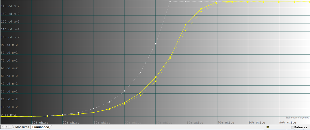

Originally Posted by viperlogic View Post
This is where I'm getting lost, especially in terms of Epson controls, so please bear with me, is the st.2084 curve the white dotted line in the luminance view? When doing a 11 or 21 grayscale sweep it produces a yellow solid line. What Epson controls should be used to "match" the yellow solid line to the white dotted line, contrast or gamma? When you say match do you actually mean match the shape of it not its actual points?
In ST.2084 calibration is absolute, so each code value maps to a specific luminance, e.g., code value 502 (50% stimulus) maps to 92.25 nits. This is the white dotted line in the HCFR luminance view (although currently HCFR uses code value 504 and 94.4 nits, due to the use of 8 bits).
If Epson gamma controls are being used then isnt that tone mapping and hence the two steps are the same thing of adjusting to ST.2084 and tone mapping?
No, as I mentioned in my previous post, ST.2084 is the first column in the spreadsheet and goes all the way to 10,000 nits, whereas the tone mapping curves are the ones in the second and third columns, For masters of 1000 nits and 4000 nits respectively.
If contrast is being used then at what should we set contrast to because for me with contrast at 50 up to level 642 flashes. If I want higher levels to flash then I have to reduce contrast eg contrast level 29 causes upto level 712 to flash.
Since the Epson 5040UB cannot hit the absolute curve with the gamma controls, I suggested boosting the Contrast control as an interim step to set the basis for calibrating the colours, even though that leads to pre-mature clipping (as long as clipping still occurs beyond code value 502). After that you would re-adjust the contrast to give you the proper clipping point.
Using Dominics steps (and contrast at 50 and near same gamma settings on Epson) as our max nits are nearly the same (141 vs 147), I get the following
At that time, I was only focusing on the EOTF and was not adjusting the colours. In hind sight, what I said was a step in the right direction but I would do it differently now, given what zoyd said regarding CMS calibration.
To hit the actual values of ST.2084 (not just the "shape"), I would now do the following:
  1. reduce the projected image size to about 50% in area (or 70% in width and height). This will allow us to bring the luminance to 92.2 nits at code value 502
  2. adjust the gamma controls to match ST.2084
  3. adjust the CMS to match to primary and secondary colours
  4. readjust the Gamma and Contrast controls to match the tone mapping curve (1000 or 4000 nits)
When everything is done, zoom the image back to the size of your choice (ideally fitting the screen). Essentially you will get a dimmer version of the proper calibration, with the correct colours and the "correct shape" of tone mapping (correct in "shape" but scaled down in absolute nits).
The end result will still look like the yellow line above, but hopefully won’t have the “terrible” cololours that you had last time.
Will have to check again as can't remember! Changed alot last night!
Okay. Because if you just start measuring colors without doing a 50-50 white pattern your colors will likely be crushed the way you are describing. I accidentally forgot once and had the same issue.
jwhn is offline

Originally Posted by jwhn View Post
Makes sense. Wouldn't you want to zoom back out and then do the tone mapping curve? Seems like you would need a different curve if you are zoomed in and getting higher luminance.
No, when I zoom in (or is it out? I'm referring to a smaller image) I used the 300 nits curve that zoyd calculated. When zooming back to the actual screen size I get ~150 nits.
It's the same as what I was doing before, but instead of scaling in HCFR, I'm now "scaling" the image size instead.
What your personal opinion of the outcome? While technically calibrated to the spec is it just too dark? Though in saying that, that's quite subjective to what everyone deems too dim.
When watch X-Men Apocalyse I didn't find the picture dim. That's not surprising given that I use 50 nits for SDR, compared with 100 nits "standard" for SDR.
However, some movies do look darker. That's a problem the JVC people also mentioned. Given that HDR "expects" 1000 nits peak, there's bound to be compromes when trying to do that with projectors. Unlike OLED TVs (for example), projectors cannot have localized high luminance.
Has anyone tried yet to calibrate using dynamic mode and high lamp, while get great peak brightness (I gain 100 nits for a peak of 248), are the colour so far off they can't be dialled in? I will try when I get a chance though I think I have more hours clocked on this PJ in calibration than actually viewing content!!!
Dynamic is greenish. You can cut down the Green Gain for a more neutral white, and still get higher luminance than Bright Cinema. I didn't check the colour gamut, however.
Dominic Chan is online now

With SDR, if I calibrate a projector perfectly on a small screen and then zoom out the image onto a larger screen, all the calibrations remain correct even though the overall luminance drops, i.e., the image gets dimmer but is still accurate (dE=0 for all measurements, whether we use dE w/ gamma or w/o gamma).
From what you said, this is no longer the case with HDR.
Correct, if 50% white doesn't measure 92 nits it is technically wrong.
Thanks for your patience educating people in this thread.
Question - I get your point here, but then doesn't it follow that if the display can't hit the absolute targets at higher luminance, say up to 1,000 or 4,000 nits, it is technically wrong also? Just trying to understand if there is something different about the 50% point. Does this affect colors more so than the higher points on the greyscale?
That’s the role of tone mapping - making the wrong right through the highlight roll off
Understood - just trying to understand if there is something magic about the 50% point. ; )
The luminance range up to 100 nits (sometimes called diffuse white) will still be the vast majority of levels that get exercised with HDR content, so if you can nail that range down, most of the content will have correct colors.
I just tested that and it seems to be the other round. Saturation sweep refuses to run when the grey scale white is absent, even if the primaries sweep is done.
No, it still uses the primaries sweep white if it's available. The mandatory grayscale run was added after BT.1886 because you need a black measurement to calculate targets and not everyone runs a black during the primaries sweep.
BTW, there's a minor quirk that I hope you can fix in future version. When running a series of sweeps (e.g., saturation sweeps of all primaries), the last column of each sweep is not updated prior to the start of the next sweep. I can add it to your editable spreadsheet.
ok
Perhaps this concept of “Absolute Luminance” hasn’t quite sunk in for me.
With SDR, if I calibrate a projector perfectly on a small screen and then zoom out the image onto a larger screen, all the calibrations remain correct even though the overall luminance drops, i.e., the image gets dimmer but is still accurate (dE=0 for all measurements, whether we use dE w/ gamma or w/o gamma.
I should add that the steps I suggested are formal steps to first meet the HDR requirement which is typically not a problem for flat panels up to 100 nits where there is no desire to then lower the diffuse white response. If in practice you end up at the same CMS settings by minimizing dE at lower contrast then of course you could skip the step of matching the PQ function at 50% = 92 nits. But I'm not completely sure what the target EOTF should be with diffuse white = 47 nits for example, is it just a scaled version of PQ?
edit: I will add a diffuse white target nits to HCFR that will rescale the targets.
