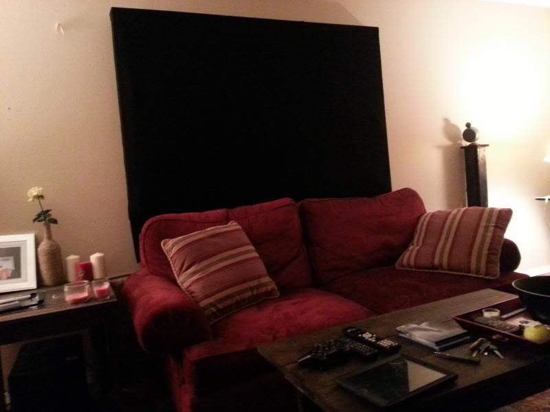

I received my first complaint a few weeks ago while watching star trek into darkness at near 0dBs on the receiver. cool.gif Not planning on moving for another year, so I'm making the best of it. Luckily, the material used was all free from work, even the screws!

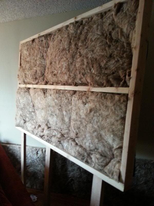

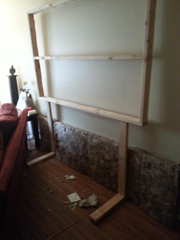

The wall it sits against is concrete, so I really don't want to drill into it, neither do the owners. Had to think up some kind of method on the fly, other than hanging a panel. For the moment, this is my first attempt. I used R13 fiberglass and some very thin breathable fabric. The complainer is on the opposite side of the room, so I'm hoping this will lesson the echos and reflections. So far it has elevated the sound quality on the couch a noticeable amount, even to the wife. Its a crawler underneath, so stopping bass from getting to his floor seems like a feat fraught with peril.
Still need to tighten the fabric up and smooth the insulation behind it. Cant beat free though.

The point is to help with reflections and echoes. The speakers face away from the individual that is complaining. So sound comes towards me than bounces back towards the wall of mr. Complainer. By no means does this sound proof anything. However it does elevate the perceived quality of my experience because less sound waves are bouncing around. I believe it has impacted mr. Complainer in the higher frequencies, he has yet to complain again at the same volumes. The improvement for him is probably marginal, the improvement for my ears is substantial. Well worth the cost if I had payed for it. Every little bit helps in multi unit structures..
