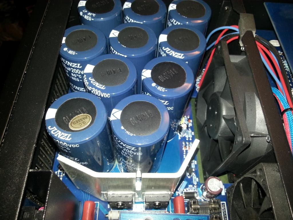

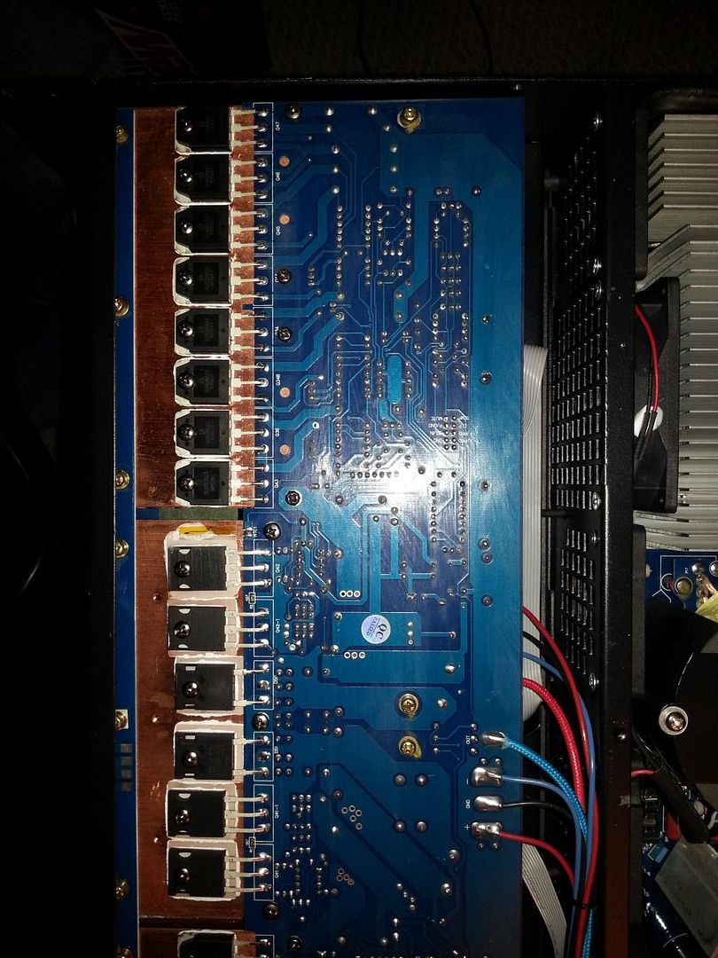

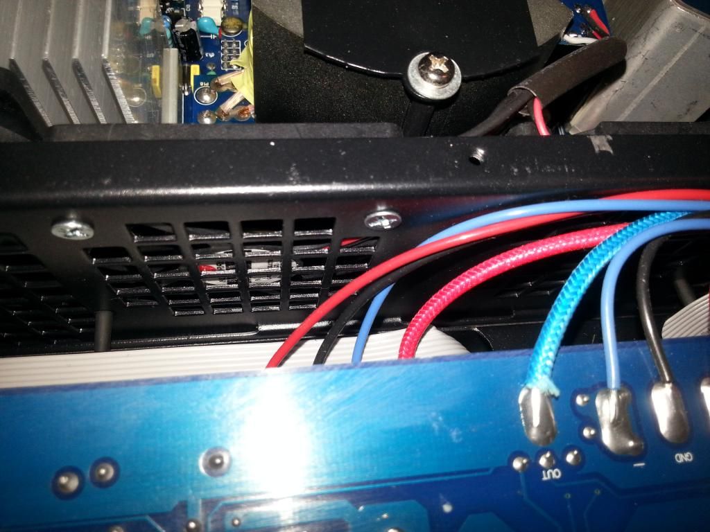

Here are top pics of the FB14k.
NOTE: 3 60MM fans and 2 80MM fans - only 2 screws on the top no bottom screws to get at and wires are obtained also at the top to solder. 5th to last pic is where the fans soldered on. Im not good at soldering so im going to slice the wires and solder them and shrink wrap. Plus the farthest 60MM fan wires dont reach anyhow. Im able to use a #2 Phillips that I got at menards thats bent 90 degrees with a flathead on the other side thats bent 90 degrees to get at the screws. I have bottom pics also
URL=http://s1161.photobucket.com/user/martinzidek/media/20150114_102910.jpg.html][/URL]URL=http://s1161.photobucket.com/user/martinzidek/media/20150114_102321.jpg.html][/URL]URL=http://s1161.photobucket.com/user/martinzidek/media/20150114_102315.jpg.html][/URL]URL=http://s1161.photobucket.com/user/martinzidek/media/20150114_102910_1.jpg.html][/URL]URL=http://s1161.photobucket.com/user/martinzidek/media/20150114_101921.jpg.html][/URL]URL=http://s1161.photobucket.com/user/martinzidek/media/20150114_102212.jpg.html][/URL]URL=http://s1161.photobucket.com/user/martinzidek/media/20150114_102212.jpg.html][/URL]URL=http://s1161.photobucket.com/user/martinzidek/media/20150114_101914.jpg.html][/URL]

post #4872 of 6831 Old 01-14-2015, 10:38 AM
dwaleke's Avatar
Location: Michigan
Posts: 2,642
Mentioned: 29 Post(s)
Quoted: 1412 Post(s)
Liked: 719
^^^ looks the same as my FP14k at quick glance.
Although there are only (2) 60mm fans and (2) 80mm fans. You say 3 but I think that's just a typo.

post #4873 of 6831 Old 01-14-2015, 10:41 AM
Join Date: Dec 2014
Location: Wisconsin
Posts: 273
Quoted: 130 Post(s)
No its 3. 1st and 2nd pic is going left to right.I should of did a panoramic picture.
Edit: It goes 80MM - 60MM - 60MM - 80MM - 60MM if you look carefully.
If other than the 5 fans instead of 4 with only top screws is the difference in the pics. No nead for the bottom or do you guys want pics of that and maybe a better front view of the amp?

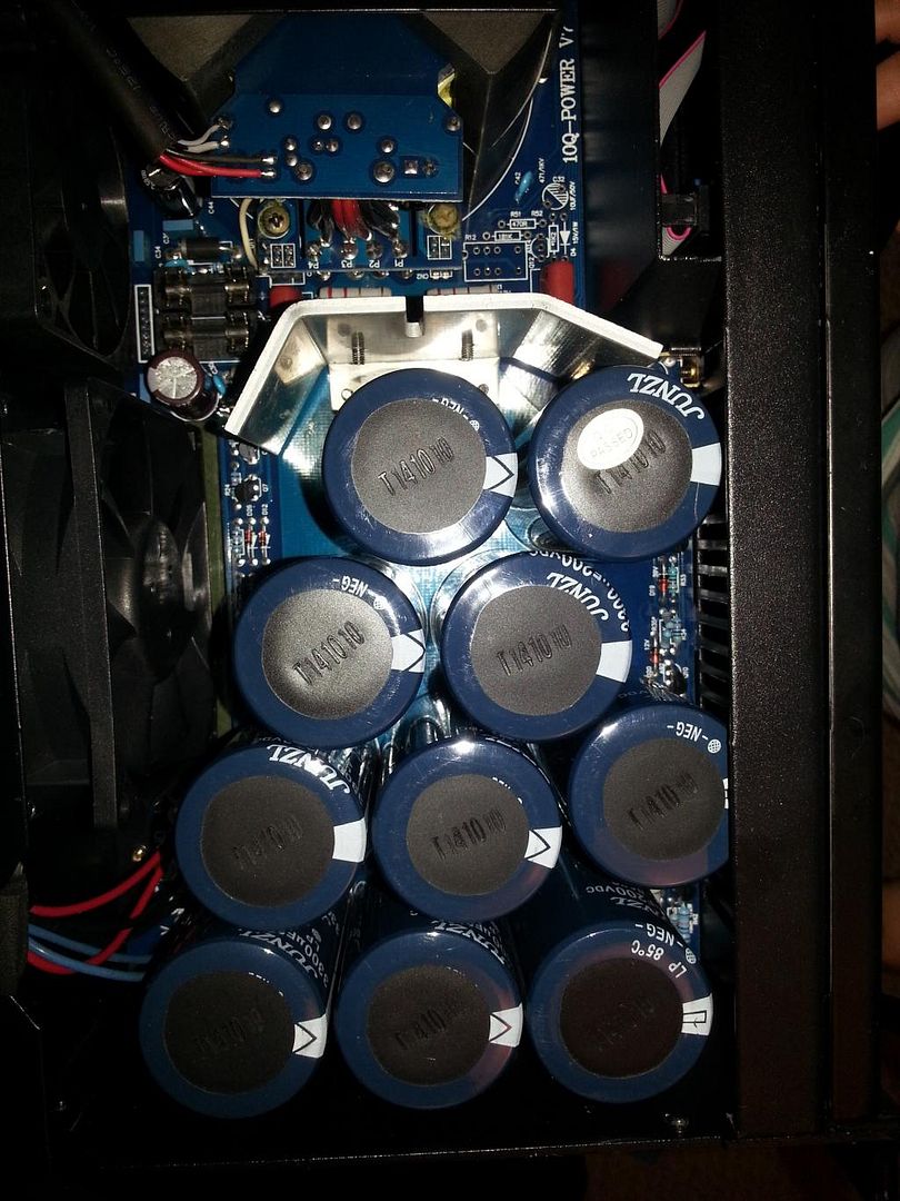

post #4874 of 6831 Old 01-14-2015, 03:00 PM
Join Date: Dec 2011
Posts: 369
Quoted: 141 Post(s)
Liked: 65
My fp14000 power board (the board towards the front) I think is a version 5 (says 10Q Power V5). Mine does not have the 60mm fan infront of the small aluminum heatsink on the far right side.
I have noticed that the far right side (towards the back in the output boards area) seems to run a bit warmer than the left side (center area of the amp stays coolest). So this may be a new helper fan?
Looks like they are still trying to improve on the design.
You can also see how the fan grates on the output side of the fans can restrict airflow.
cellarnoise is offline

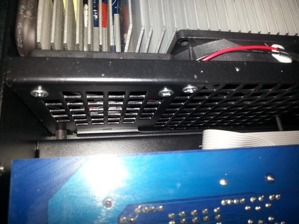

Has anyone had the fans on these crank up from the level they settle on after the start up? Mine always stay at one level even when I beat on them with the heaviest bass music I can stand. Though I rarely desire to be punished in this way. Most of the time they never go beyond the -4 lights. Only ulf movie stuff may hit higher on my setup and I don't think my house can handle much more. This sits about 1.5 feet above the floor in my basement that never gets above 68 F though. I like that it acts as a heater
I cut out the exhaust fan grates and I think it helped noise some and airflow more. Only took 20 minutes to cut with a air die grinder and then paint. The 60mm fans took more work as the cutout had to be a bit bigger than the grate area to not restrict the fans. Though ported I did not take the time to polish the airflow path (auto reference...). Will send photo soon. Phone won't let me attach...

You may want to check the voltage of at least the new 3rd 60 mm fan to make sure it is also a 24 volt fan. There has been some debate if the feeds to these fans have been 48 volts and the fans wired together for 24 volt operation. A solo 24 volt fan would need it's own circuit if this has been the case.

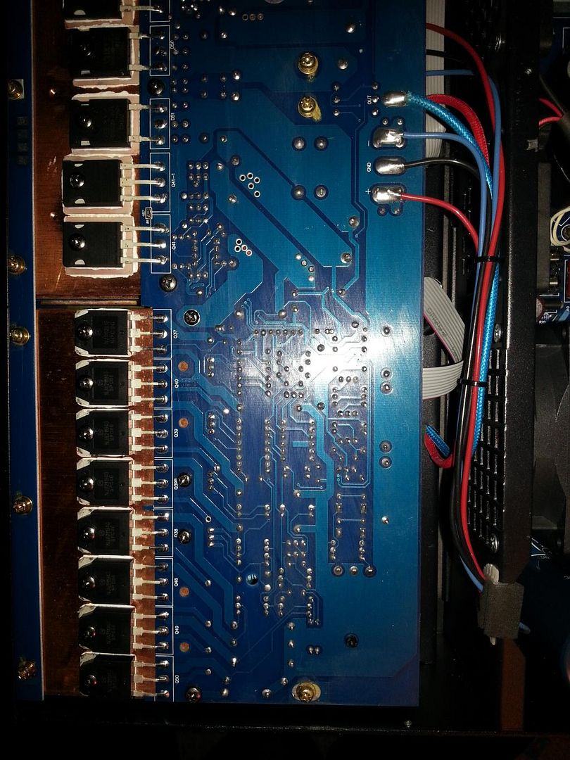

post #4883 of 6831 Old 01-17-2015, 08:01 AM
Join Date: Dec 2014
Location: Wisconsin
Posts: 273
Quoted: 130 Post(s)

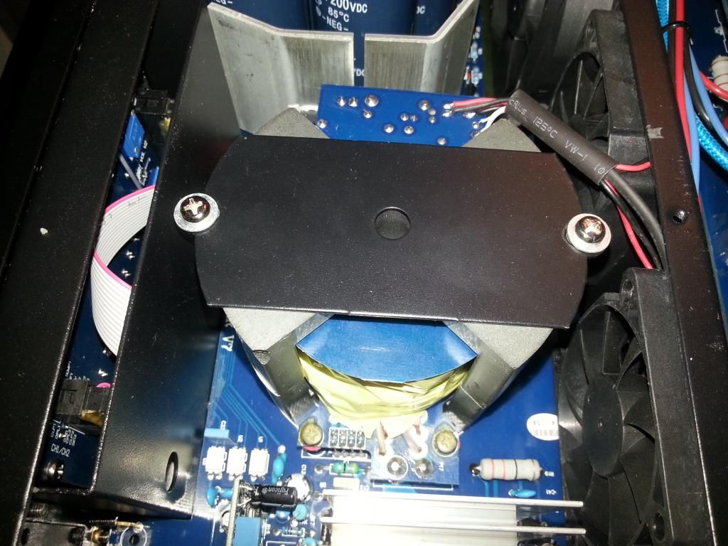

@notnyt I ended up just finishing up now with the fans and it's all quiet now!!!! Wasn't hard at all just took my time. Plugged in the amp with both top and bottom covers off before I put it all back to make sure all good.
But... When I went for the cover for the bottom I seem this. First time I noticed this. Which looks worse than what's actually pictured. I rubbed it and it's smooth.
I looked all over and seem nothing out of ordinary till I grabbed my phone and turned the light on and seen this.
Looks like it gassed? Haven't used the amp yet. No speaker wire yet and the terminals not on the box yet till i get the wire and solder it on. Thoughts?
MagnumMafia05 is offline

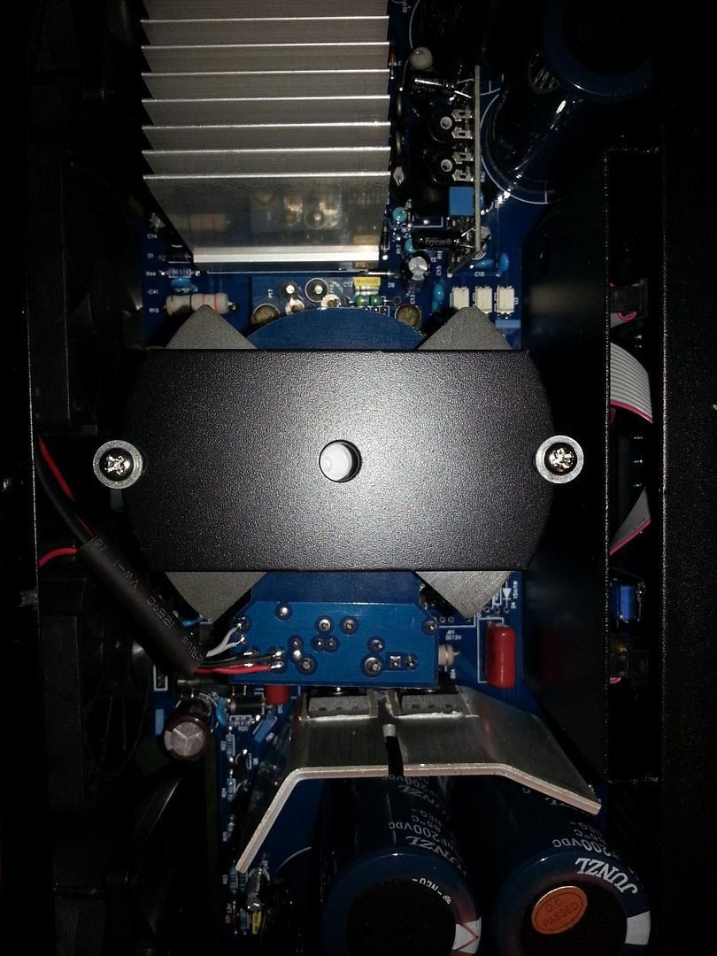

post #4884 of 6831 Old 01-17-2015, 10:23 AM
Join Date: Dec 2014
Location: Wisconsin
Posts: 273
Quoted: 130 Post(s)
Update. I just hooked up a sub in series and thought a amp channel was shot because only got sound out of 1. Did a bunch of switching xlr and rca cables for 10 min and found 1 of the xlr to rca doesn't work. Both channels on amp work so far. Was to the point I thought only 1 output was working on the minidsp. Finally found out after so much frustration. &lt;br /&gt;<br />
&lt;br /&gt;<br />
I emailed Anne about the burn mark on the bottom plate and the grey on the capacitor. So now I have to order another car to rca from parts express. Glad it wasn't a messed up channel though. But another set back. &lt;br /&gt;<br />
&lt;br /&gt;<br />
I tested the sub with bass Ballin' by bass mekanik on 32db gain on amp just to have movement. Guess I'll have to wait till Monday for a response back from Anne.
With the new fans it doesn't do the same thing at startup with the original fans by being louder then quiet down shortly after. Is that normal?
