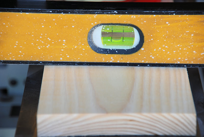

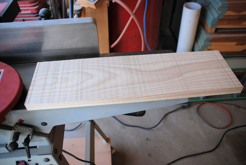

Getting set up.

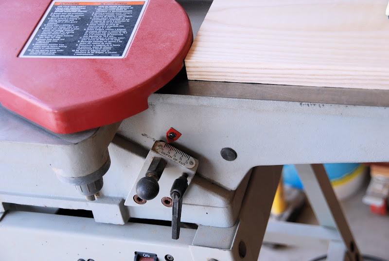

Here is a before shot. In a moment, I'll flip it over and joint a flat reference face on this board.
I haven't powered on yet--just wanted to show you the small amount of cupping I want to remove, to make this board flat. You can see a gap beneath the level at the outer edges and you can see a gap in the center at the table. The crown (peak) is up and that is how I will feed the board through the jointer.
I'm only taking off 1/32" with each pass, so it will probably take 2 or 3 passes to get a flat reference face.
After 2 passes, I am really close.
After the third pass, you can now clearly see that I have some cross-grain figure in the wood, which I can enhance later, with some honey-amber Trans-Tint dye, which will also give the wood some warmth in appearance.

Max--I'm undecided at this point about exactly what I will do to the port color, though I have a couple of ideas. I do know that they will not remain white. I'm open to suggestions.
MJAudio--Haha! My numerous mistakes keep me humble. And I wish I were faster.
Joe--A shop vac has better suction. A Dust Collector moves a larger volume of air. A planer, jointer, table saw and band saw and even a router produce a large volume of chips and dust very quickly and shop vacs are easily overwhelmed and unable to keep up. The only reason I can get away with using a shop vac (on occasion) on the DeWalt DW735 surface planer, is because the 735 has its own built-in blower, which blows air and chips out with enough CFM to inflate the bag on my small dust collector, if I have it connected, but turn on the planer before I turn on the DC. I don't use the shop vac on the planer often, because a DC is a much better match. I just get a little lazy sometimes when going back and forth between the planer and jointer.
Bill Pentz has a lot more very useful information about dust collection on his site. He even has some excellent DC DIY info.
