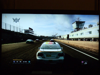

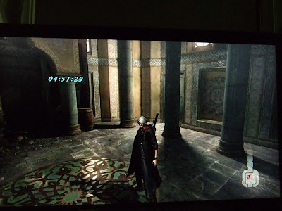

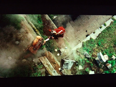

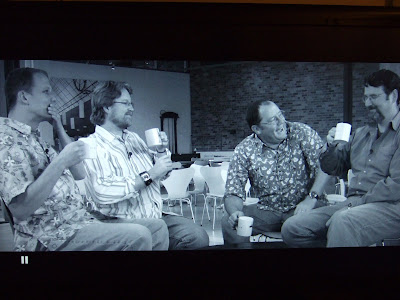

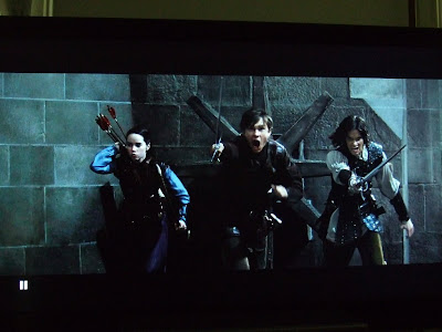

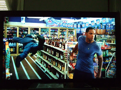

Sample Pictures
I took a few sample pictures to show roughly what the settings look like on my TV. You have to consider when looking at these pictures that my camera may not be that great, that the exposure probably changes between pictures, but I did fix white balance at "shade" on my camera because it most closely matched what I see. These pictures may not be exactly what you see in real life, but you can compare between them.
I've tried to capture a wide range of scenes. Some of the scenes you can tell a definite difference, some scenes you can't; this mirrors what you'd experience in real life.

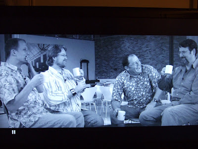

First image: b&w scene from Wall-E trailer on the Playstation Store:
First set of settings above
Second set of settings above
Second set of settings above, but using cool2 instead of normal

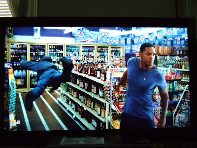

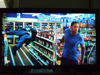

Second image: a scene from the 2nd Hancock trailer:
First set of settings above.
Second set of settings above.
Dynamic-based "Normal" color mode, without altering the white balance (I got this by changing the color tone in dynamic mode to normal and turning off as much processing as I could, so no DNIe and sharpness was set to 0, but detailed settings aren't available so there are likely some processing things still stuck on).

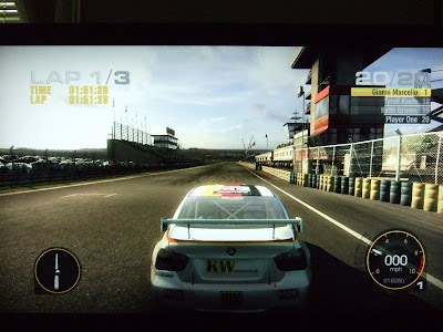

Third image: beginning of a race in the GRID demo. I actually have no idea what it's supposed to look like, for reference here's a screenshot: http://www.gamespot.com/pages/image_...d=939159&img=2
Dynamic-based "Normal" color mode, without altering the white balance.

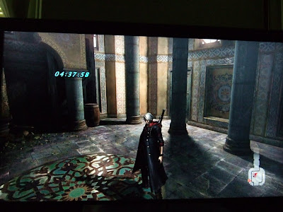

Fourth image: Scene from the Devil May Cry 4 demo on the PS3
Dynamic-based normal mode

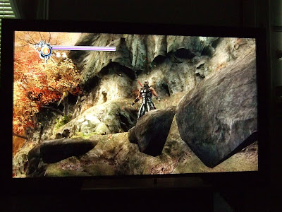

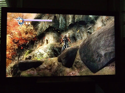

Fifth image: Ninja Gaiden Sigma demo on the PS3

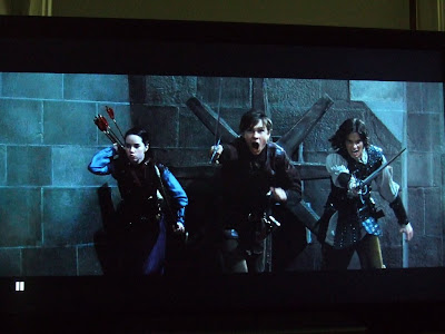

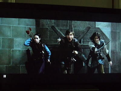

Sixth image: Scene from about the middle of the new Narnia trailer
Dynamic-based normal mode. I think dynamic is doing some weird processing to the grass; note how some of the grass looks neon green.
Seventh image: Near the end of the Narnia trailer
Dynamic-based normal.

Your first set of settings look really good. Now that I can see Warm 2 in action, it makes black and white material look the way it's supposed to. That's for sure. The second set of settings, are also decent!
The whites in the image for the second Hancock trailer don't really look 'warm' at all. That picture, at least by seeing it from your snapshot, looks very natural and 'movie theater' like.
It's in the video game where you can really see the 'warmth' of the picture and for games, the 'accurate' settings may be a little too warm for my blood Well, it seems clicq that you've had the best things to help us out with on this set so far. I'll probably be using either your first or second set of settings
Oh, btw, I'd be curious to see video game comparisons between your first and second set of settings, as opposed to first set of settings vs game mode.

Your wish is my command, I updated the post with a few additional pictures. Actually, judging from the screenshot (which I assume is captured without the use of a camera), the game is supposed to look a little warm.
I should also emphasize that these pictures, being taken by a camera, may not exactly reflect what we see. I could make all the pictures look closer, for example, if I had the camera use automatic white balance.
