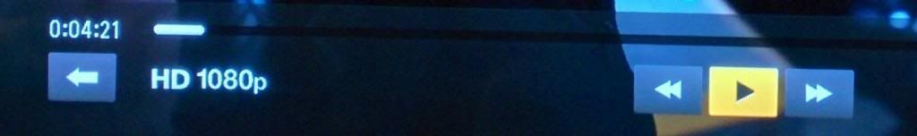

I think your streaming video issues are either a speed problem or some kind of defective firmware in your Smart TV apps.
I just looked at my my Amazon Prime, everything looks fine. I can't show you a picture because of reflections of the four windows in the living room. rolleyes.gif We normally watch TV at night, but I'm home today. And even when I do watch TV in the daytime, those reflections don't bother me. But there's no muddiness, no ghosting in the TV picture itself on Amazon Prime.
When you PAUSE the muddled looking Amazon Prime video, does it say "HD 1080p" down in the lower left hand corner?
Even though you did eventually run wired ethernet, it sure sounds like the streaming apps aren't getting enough speed. The "muddled looking" seems to exactly describe pixelation from low bandwidth or SD video resolution on a 1080p display. And this issue seems to be with the smartTV apps, not with regular channels or with DVD/Blu-ray playback? You say,
