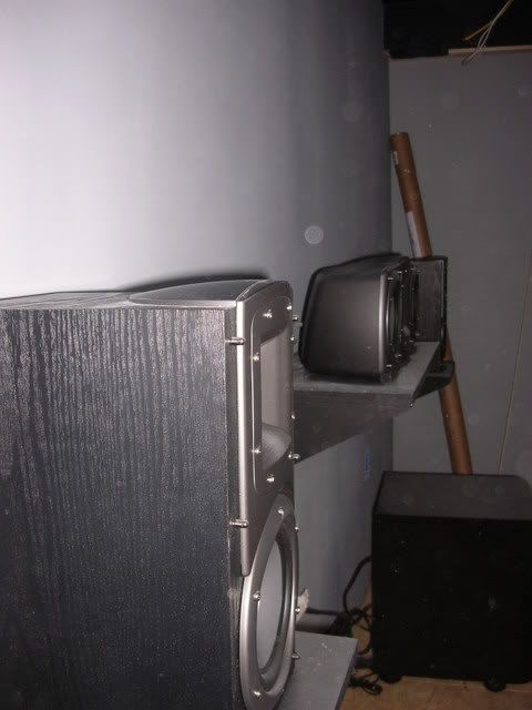

I actually bought phifer sheerweave material last year from Chris at SeymourAV.

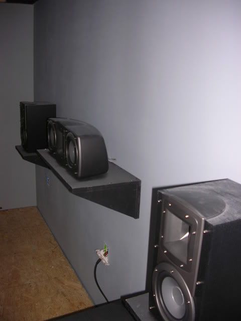

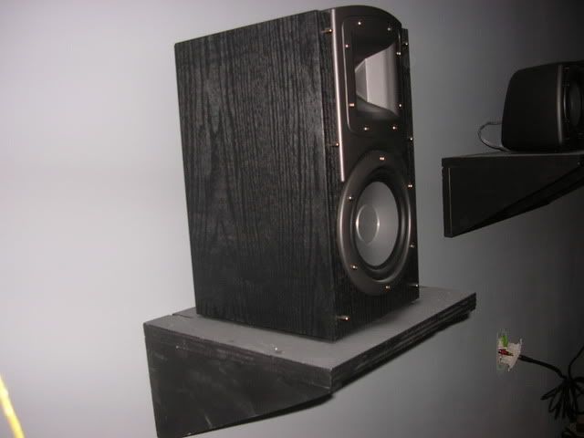

Im actually using Klipsch speakers available at Best Buy, good or bad I had a limited budget and these fit the bill. I have the C2, 4 S2's and a pair of B2's. To me they sound awesome, the surrounds have tweeters which angle off to each side. They feature WDST which envelopes the whole listening area.
The front speakers sit on shelves attached to the wall. The left and right speakers are about 11" deep and are about an 1.5" away from the wall and the screen sits at about 18" so about 5-6 inches space away from the screen. Here are a couple shots showing the speakers and the shelves they sit on taken early in my build.
BTW, the subwoofer is a JBL 12" sub.

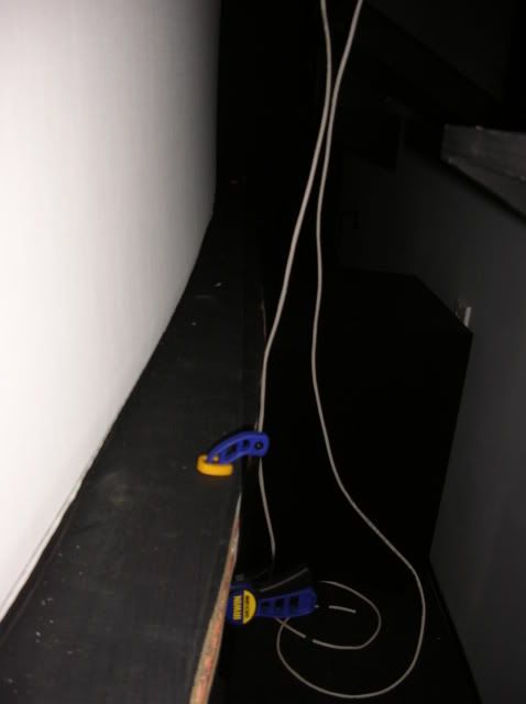

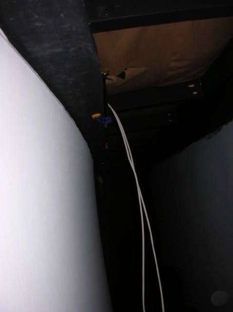

Looks great. Do you have any pics of how you mounted the screen to the wall? I am especially interested to see how managed to get tension in the middle of the screen to pull out the wrinkles. I would think the weight of the upper horizontal support would tend to make the screen sag. Also, is the screen easily removed to get to the speakers in the back?

I'll snap some pics for you tonight. I simply used some mini clamps, works like a charm. Very easy to remove if need be.

WannaTheater,
Here are the pics showing the screen secured with the clamps. The top clamps are closer to the center to help support that area. All the sags from the weight of the frame are removed when clamped.
The bottom clamps are closer to the left and right speakers
Basically the screen sits on top of the false wall. The border sticks out about 1/4" all around on the outside edges, this way when the screen is placed on the false wall it wont go past the edge due to the 1'4" lip.
oman321 is offline

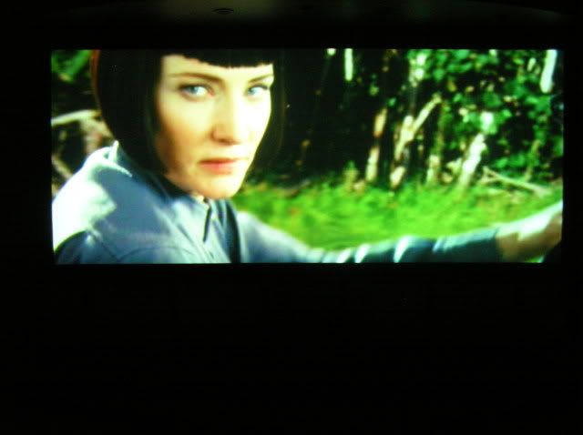

Ah, I posted a few in my build thread, but they were just some quick shots that I took of upconverted dvd's. Tonight I will try to get some new shots with the PS3 and post them later on.

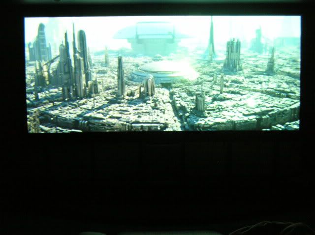

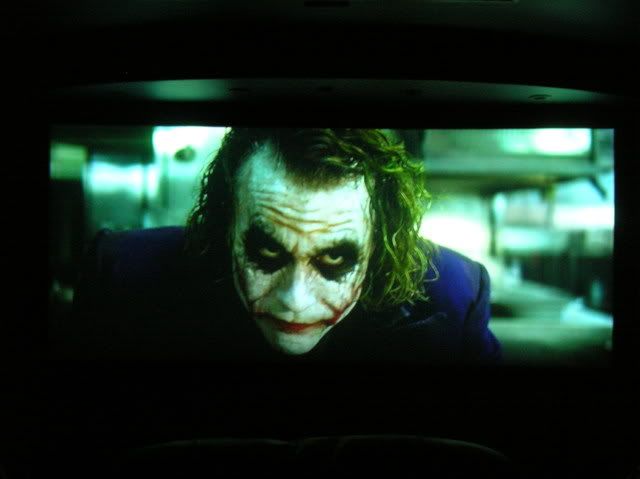

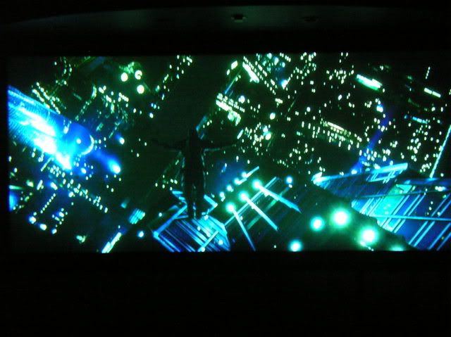

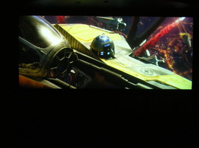

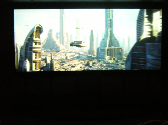

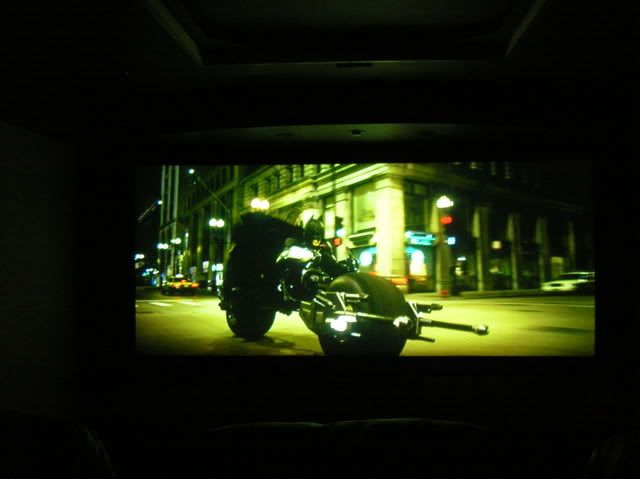

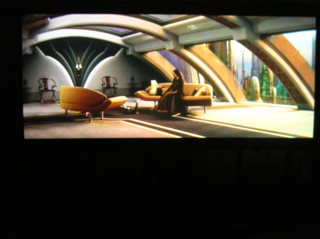

Ok I managed to get some newer pics off of my PS3 with Blu Ray. Like before I had to take these pics under not so ideal conditions. I used to have a tripod but it's broken and I didn't have an easy way to set the camera, so I sat in the second row and held the camera with both hands (my elbows supported by my legs), no flash and on most shots I allowed the timer to take the pic.
Stargate:
Dark Knight:
I love this shot, no hint of CA from from my DIY Anamorphic Lens
Any hint of blurriness is either because of me or the camera.

Aussiebob was kind enough to foward me his excel calculator via email which allowed me to put in all sorts of info to determine the proper radius. Throw, size, seating distance, etc.
I believe the result was about 3.5 inches, but I went with 3" and it has worked out fine.

Would a person be better off going with a flat screen, if doing the zoom method for 2.40 scope movies ?
John
HDGTX is offline
post #26 of 71 Old 01-03-2009, 11:27 AM - Thread Starter
oman321's Avatar
Location: MASS
Posts: 4,939
Quoted: 127 Post(s)
Liked: 117
Yes, When I was projecting on my screen before I put the lens in place, it had the opposite effect of pincushion due to the curved screen.
oman321 is offline
