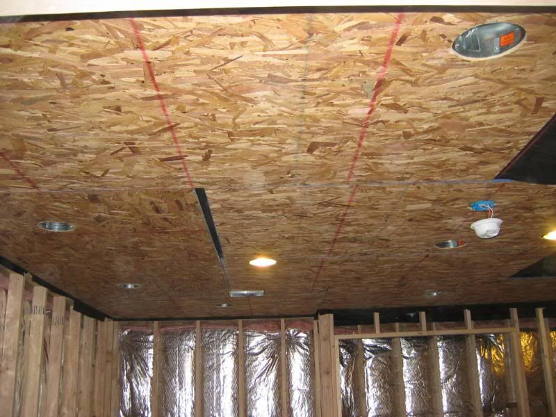

Actually, for the ceiling instead of DD, I did 7/16th OSB, and than ½ DW.
I hear the OSB is equivalent to ½ DW in weight / mass.
I regret doing this, as OSB is much harder to work with, but at the time OSB was less than ½ cost of DW and I wasn't thinking.
So, don't copy this part. PIA.
Also, no Clips or any necessary sound isolation steps, as I did not know about that prior to finishing framing and some DW. So too late for that. I just found out about GG not too long ago so I ordered that prior to putting up the 2nd layer of DW.

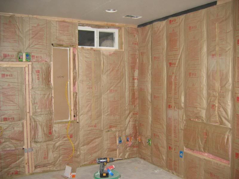

Also use acoustical caulk to seal the gaps around the outlets, edges of the walls, etc. Got this from the soundproof company as well.
We do have Dual Zone HVAC, so sounds from HVAC will not reach bedroom floor. I wrapped duct insulation wrap around the vents anyway.

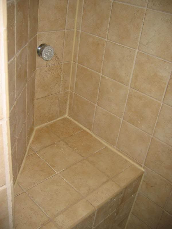

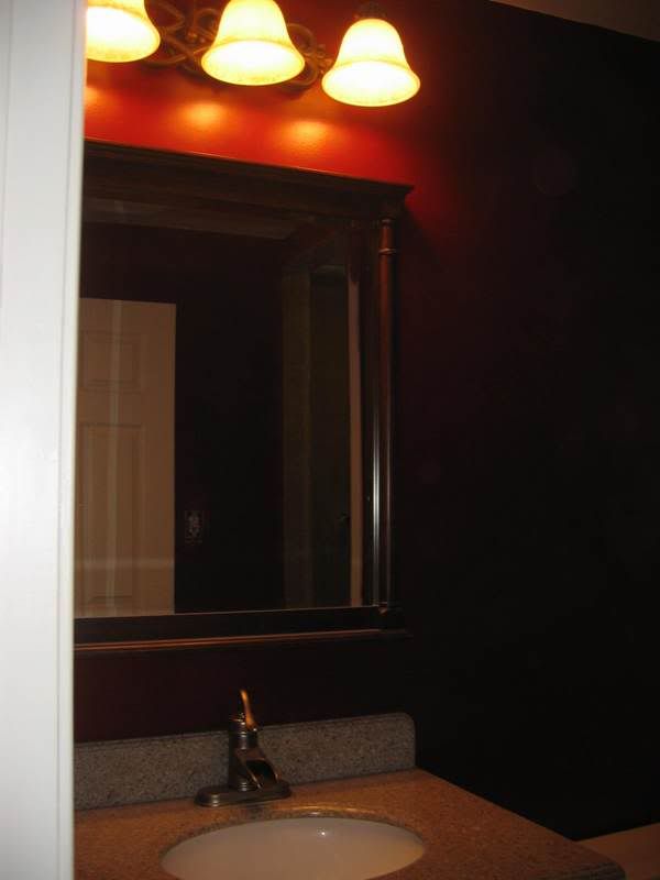

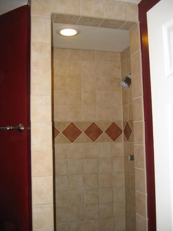

Anyhow, so I don't bore you with the details of the bathroom or bedroom, here are just a few finished pics:
Shower has dual jets. I love these btw. It's like getting massage when they're on. I need to redo my master bedroom showers to add these!

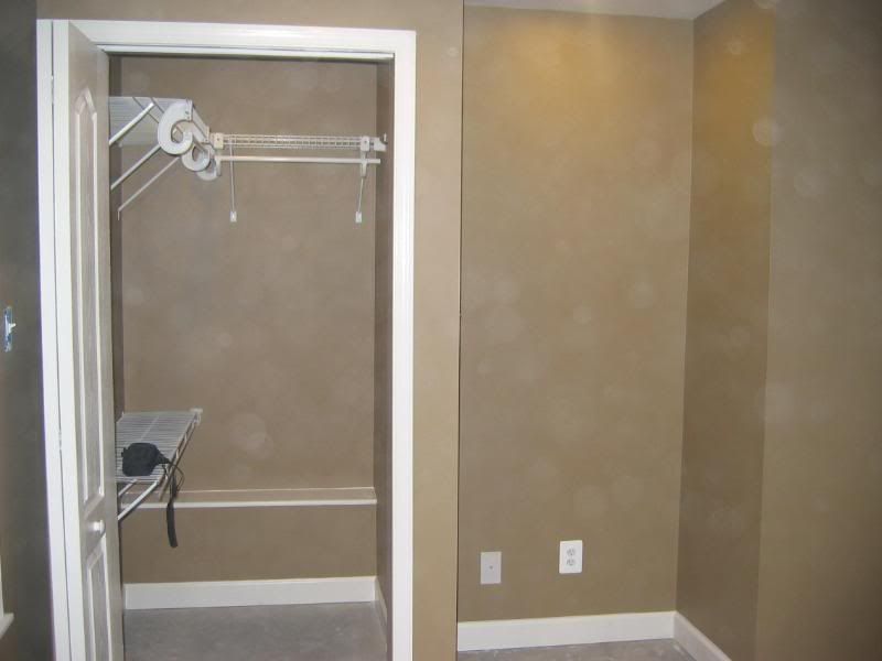

Here is the room where the shuffle board will be. Added 2 huge closets. It's actually 1 big closet with 2 sets of double doors.
3rd door is for the water pipe. And some storage space.
4 zone lighting in this room.
One is for stairs, one is for when the main basement light is turned on, this will rarely be used, 1 for shuffle board, when in use, and one for that room.
Understairs will also be a storage closet. Can't have too much storage.

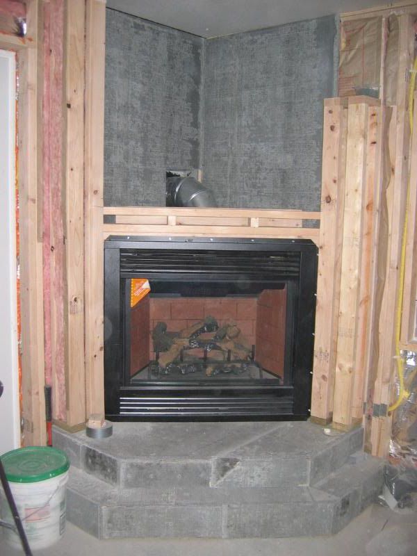

Fireplace TV room.
I bought a 36 natural gas FP.

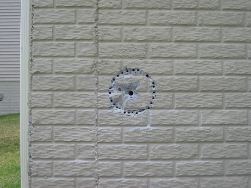

Bought some CSST and ran the lines from the manifold to the FP. Had the pros do the connection, as you need to be trained and certified to do this. After watching the guy hook it up, it didn't see hard at all, but better to not play with gas yah know.

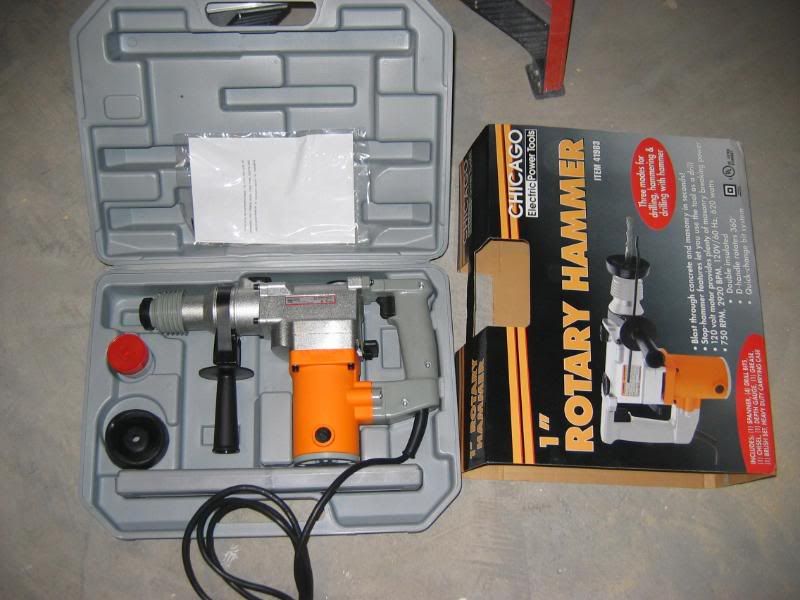

Called up a guy to give me a quote on cutting a hole through the poured concrete for the exhaust and he wanted $200. that sound reasonable to me, but instead I decided to do it myself.
I bought a cheap concrete drill from harbor freight tools. There is one near my house and I never buy tools from there, except for the use it one time only type tools. This thing drilled through 8 poured concrete like nothing! Amazing.
That is one of 2 tools that I purchased for the basement build.
Drilled a bunch of holes and pounded it out.
I used my old air hammer/chisel to clean it up and it broke about 1/2 the way through! Argghhh. Oh well, it's about 10 yrs old anyway. Good thing this new drill has a chisel feature, so I used that.
FP is in, tested it, it works, fan blows serious heat, etc, all is good.

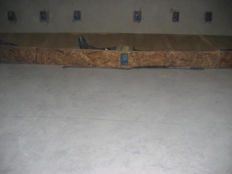

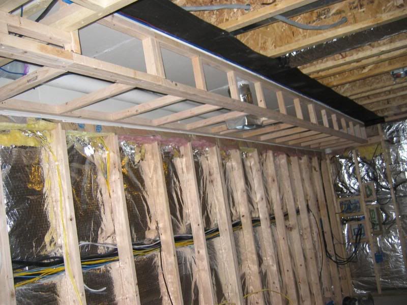

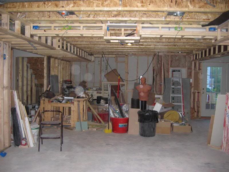

Now, the theater room.

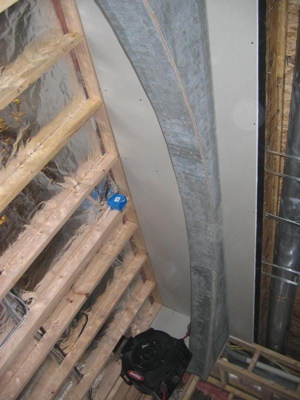

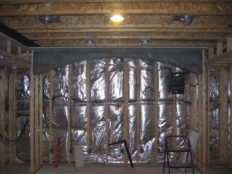

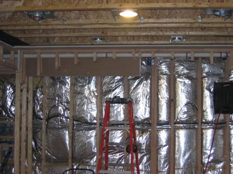

I added a bulk head to one side to mirror the other side that houses the HVAC trunk.
But in this one, will hide a 3 conduit pipe that will go to the projector. I have a built in projector housing, instead of using a mount. Figure it's easier this way.
Will use a Panamax inwall outlet surge thingy.
Btw, All Can lights in the basement are IC Air Tight.
4 - 6 cans in this room and 6 - 4 cans. I put 2 4 can in each left/right soffit and 2 up front to aim at the screen wall.
5 zone lighting in this room.
1 for main ceiling lights.
1 for screen wall lights
1 for soffit lights
1 is hooked up to the outlets in the soffit for future star ceiling
1 is hooked up to out let on screen wall incase I run some light back there.

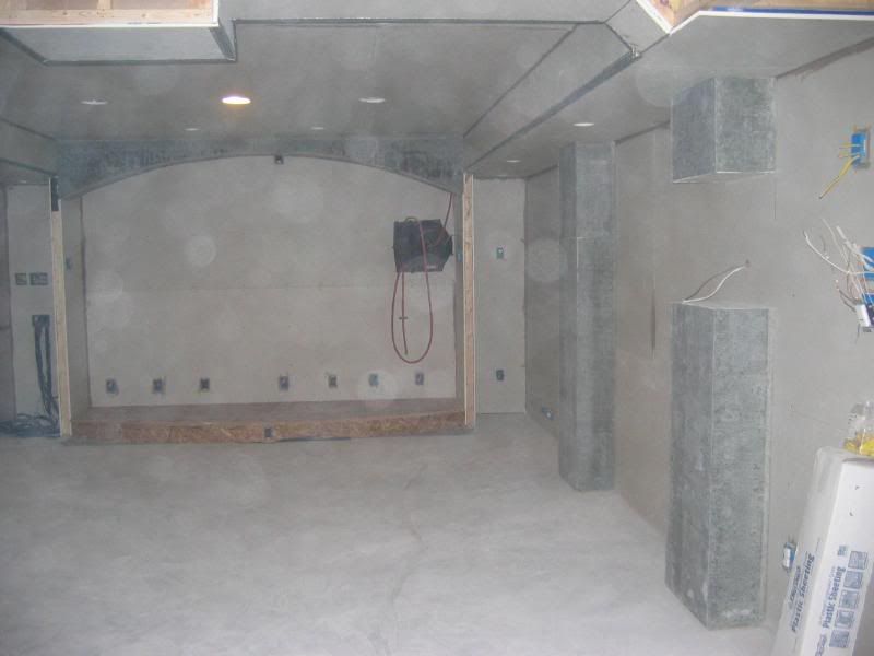

The curved soffit will have veneer stone on it as well. This soffit is to hide the tension screen housing behind it. It also hides a 2 conduit that runs to the bar TV.
I will also put base traps on this screen wall. Only about 2' wide and 6 thick, from stage floor to ceiling on each left/right side.
I have purchased 3 cases of 1 2x4' OC703 for the wall treatments for the rest of this room. The wall will be covered in GOM fabric. Purchased the 703 from a Bryan Pape of Sensible Sound Solutions, good guy, very knowledgable.
This room is wired with 12-2 inwall speaker for 8.2 setup, if there ever will be such a thing.
I also included various speaker/sub outlets in various locations just incase I want to put something somewhere or hook up future butt shakers, etc.
I would like to do star ceiling panels one day, so I wired a couple outlets in the projector housing soffit.
These are the columns, I will put stone veneer on the columns. The back ones will hide a set of Dipoles I have.
Here is a small stage. I filled with sand and put double OSB and routed the edge round.
The two closets to the left/right measure about 24 x 26. The one on left will house the AV and the right is to mirror the look. Will probably house various equipment, boxes, etc.
I plan to build stone veneer doors to complete the dungeon look in this room.

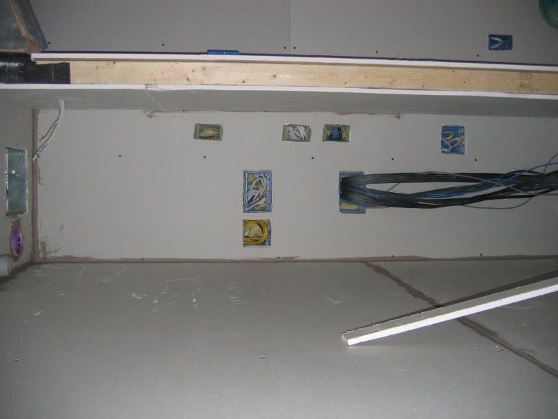

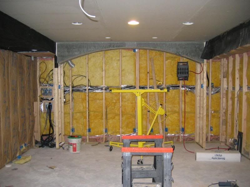

This is where I'm at for now. I am finished drywalling this room, so now I will move on to the bar / pool table area.

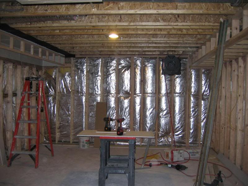

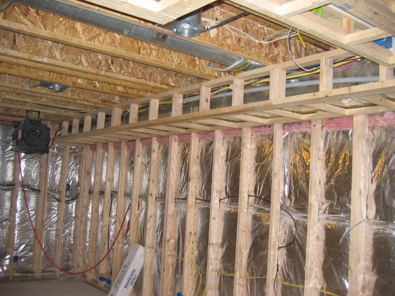

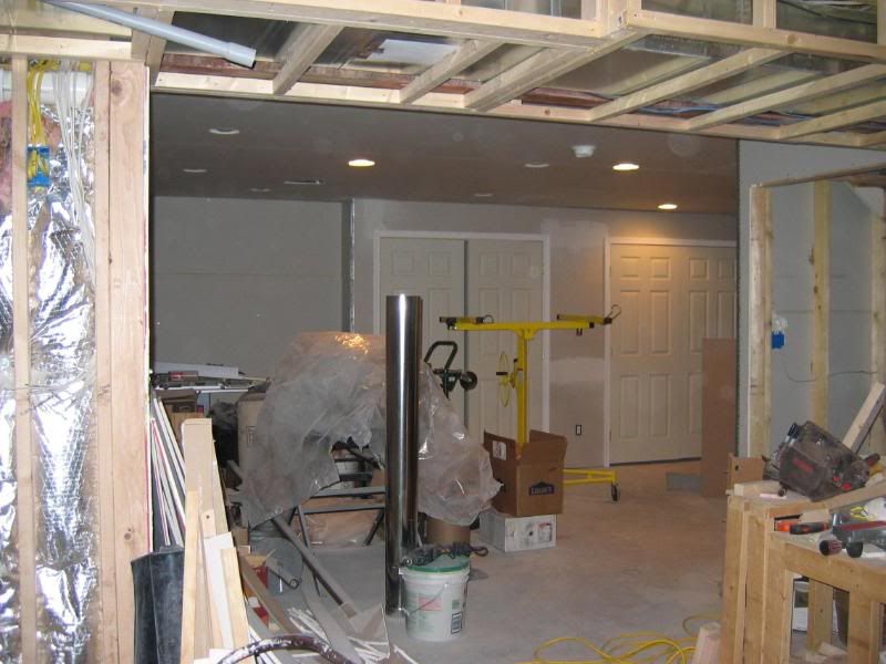

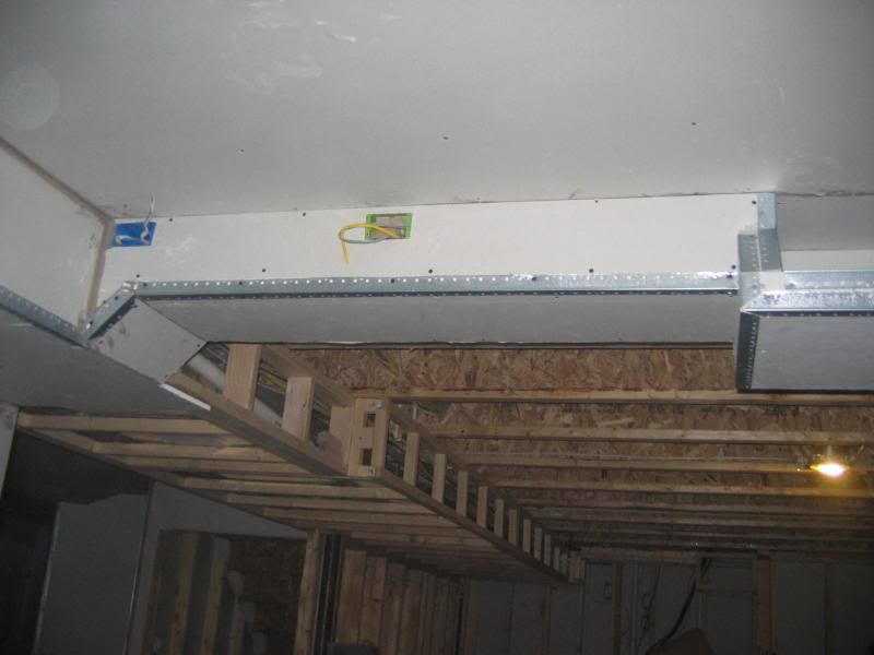

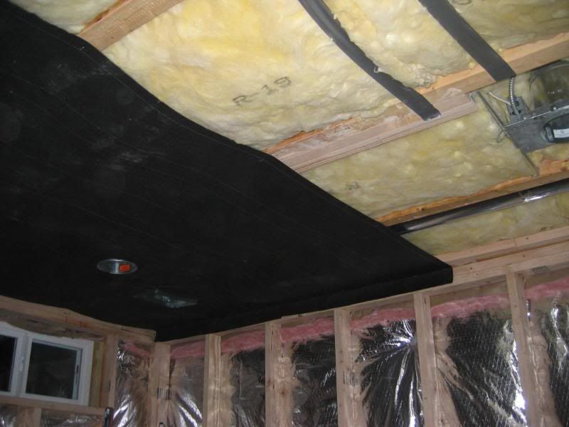

Moving on, working on the bar side.

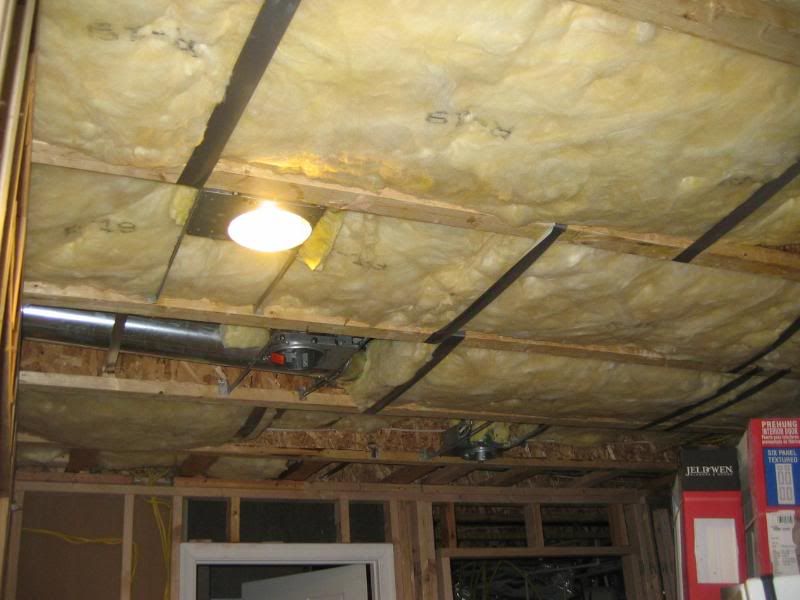

Hung the can lights in their location, extended two 6" HVAC vents, stuffed r19 in the joist, and installed the Microwave vent to exhaust to the exterior of the home.
should be able to start drywalling the ceiling soon...

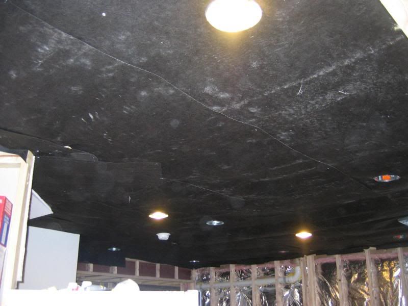

Great looking build. Couple of questions.
The tar-paper, Purpose?
Did you really run compressed air lines into your house? First time I've seen that.
post #8 of 94 Old 06-25-2008, 08:37 AM - Thread Starter
Old
Old's Avatar
Location: Maryland
Posts: 311
Hi Big, Thanks.
Also, i want to mention that your basement theater/bar, etc, is absolutely gorgeous!! I am very impressed.
Tar paper is b/c a while back when I was researching sound proofing techniques, I read that the poormans method was to use a couple of layers of 30lb roof paper. As I mentioned, I bought a lot of materials ahead of time and that was one of them. (I had a 10% off coupon from Lowes and HD and bought most of the materials with when using it)
I figure it can't hurt. it's not too difficult to do and cheap, so I went with it.
If it provides absolutely no help, than Dammit!
Yes to the compressed air.
I have a large Ingersol Rand AC in the garage.
I have a reel in the garage, basement and also future shed/workshop area under the future deck (what I mean by that is I have the copper line extended to where the workshop will be already to go).
Basically what I is did is was made some copper tubing runs the location and and attached a shut off valve at the end (and also one in the garage).
There is a quick release coupling at the end as well.
When done, I will put one of those Oatey's Access Panel in place incase I need to get to it again.

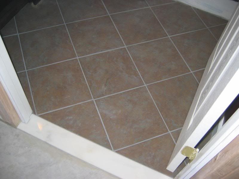

thought I would throw an update.

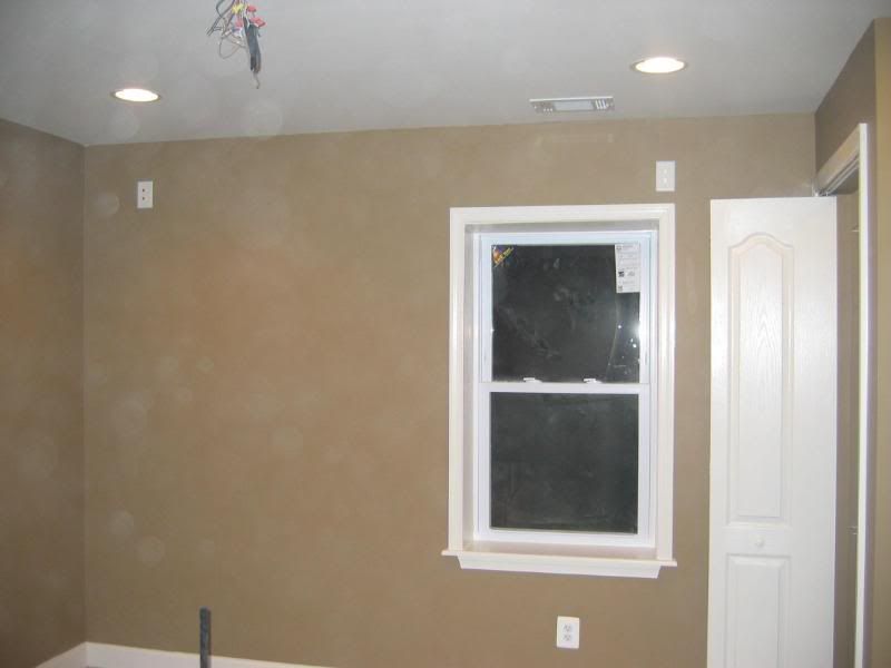

since last post, I have finished the Drywall, painted, layed Tile in the bar area and back door area, setup the bar cabinets.
I had my wife, mother in law, and 3 yr old son help out with the painting, so it went quick.
here are a few pics:

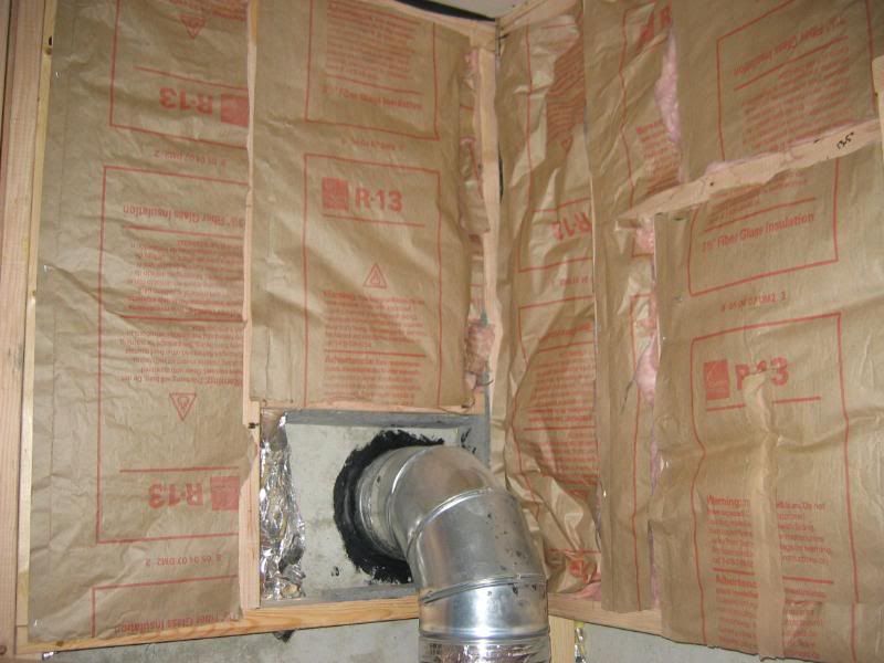

here is the equipment closet vent and conduits. the big one (3") goes to the projector and the little one (2") goes to the bar TV.

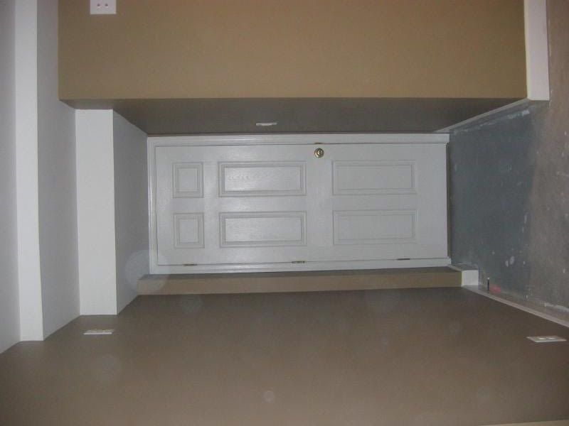

here are pics of the bar area:
I just realized I have not uploaded the pics of the completed bar area with all the cabinets in place, etc. I'll have to get that in and will post later.
Tiled entrance door area:

Originally Posted by javadoc View Post
Looks really good, and you have great fabrication skills. Kudos on the tile work too, it looks GREAT!
When ppl are using GG and double drywall, how do you account for the added thickness? Do you space out the outlet boxes and ceiling cans or what?
Thank you.
for the DD and GG, for the outlets, I used an adjustable one for Carlon. you can find these at HD. they're about double the cost of the regular, but makes it easier.
or you can get a regular box and pound it in an extra "x" amount you need for the added thickness.
for the cans, I did not space them out. I put them normally. The trim has springs that will adjust to the added height.

Taking the night off from working on the basement, so thought I update this thread. Lots happen since last time.
It was time to hang the GOM and linacoustic in the theater room. I was checking out fabric frames from fabric mate and the price for them was just way out of my range. I decided to use strips of MDF.
I had 4 - 4x8' sheets of 1/2" MDF that I bought a year ago and was going to use it for soffits and roll wood veneer, etc. I scrapped that idea many months ago. So I decided to use them to build my fabric frames. I cut them 2.75" strips by 8' long. I stacked all 4 sheets and ripped them with a circular saw at the same time. MDF cuts easy so the saw had no issues. I cut 15 strips equaling 45 total 1/2 strips.
I then glued and stapled two of them together. Since the strips were cut at the same time, they mated well.
putting them together, I used my old biscuit jointer and glued them together clamped them down overnight.
then painted them a dark color.
Painted the walls the same dark color so the frame won't bleed through.
A couple fo them would butt up togther, so I routed the edges 45degrees to give it a better look when butted up together
And wrapped them in GOM fabric. I tell yah, this GOM FR701 stuff is pretty stretchy. this part was a 2 man operation. I wanted it tight as possible, so my bro pulled as hard as he could and I stapled them down. this worked out well, ended up being super tight.
I hung the linacoustic in place. i lightly screwed them in place using drywall screws. (only 2 per sheet).
(I had to remove the top cotton batting b/c the white just blead through. I figured it served very little purpose anyway)
then placed the GOM framed over it and nailed them in place with a finish nailer.

Now I need to get ready for the veneer stone.
I placed an order for some Eldorado Stone, about 2000 lbs worth! It should be here by this Monday.
so to prepare for it, I applied a scratch coat over the wonderboard of the fireplace, columns doors and soffit.
Now I'm ready to apply the stones. Can't wait.

The veneer stones arrived a few days before my daughter was born, so I started applying the stones. I went with Eldorado Stone, Country Rubble in Capri color with Earth tone accents.
I ordered about 30more sq/ft of stone b/c I decided to stone the bar area as well.
Also decided to go with solid granite countertops for the bar. You guys will be amazed at the deals you can get in today's economy. Not too much more if I did myself with granite tiles with the profiled edges.
Anyhow, here are some pics.
loaded up the stones in the garage. each box hold about 10sqft.
veneer stone weighs between 10 to 15lbs a sqft.
Fireplace:
the mantel is a solid 12" x 48" x 2" concrete with rebar, that I had to custom cut down to size to fit the opening. This thing weighed atleast 100lbs. Extremely tough to balance and cut on the wet saw.
The Heatherstone were solid 20" x 20" x 2" concrete that I cut down to size to fit the steps. Easier to cut than the Mantel, b/c of the size, but still weighs a ton.
Not completely done with the stone. still a few stones to add and also grout. Will go with an overgrout technique to give it more of the "old world" look.
Columns, doors and arch:
Still not done here either. Have a few stones to add and also grout.
The doors, when closed, looks like it's just part of the support post holding up the arch and not doors at all. These doors probably weight between 150lb to 200lb? I used 3 heavy duty hinges per door. They open and close extremely smooth.
I will build a false wall with a DIY 2.35CIH 117.5" x 50" AT screen under the arch.
