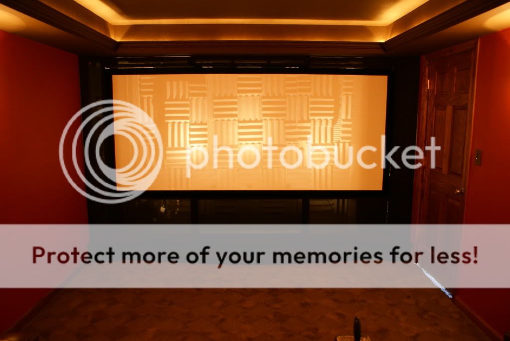

A lot has happened since my last update. We made our DIY scope screen using Seymour AV's AT fabric and the staple method. Final viewable width is 111.5. I took lots of pictures to document the process.
I began with 1x3 poplar mitered at the corners.
Added a bevel to the inside edge
Laid the pieces out in the garage for a test fit
Then wrapped and stapled them in velveteen from Hancock fabrics
My stapler worked just okay. The hammer was needed to finish up
I used metal brackets to secure the corners
Here is the finished frame
Building the frame was a fun family project that turned out well.

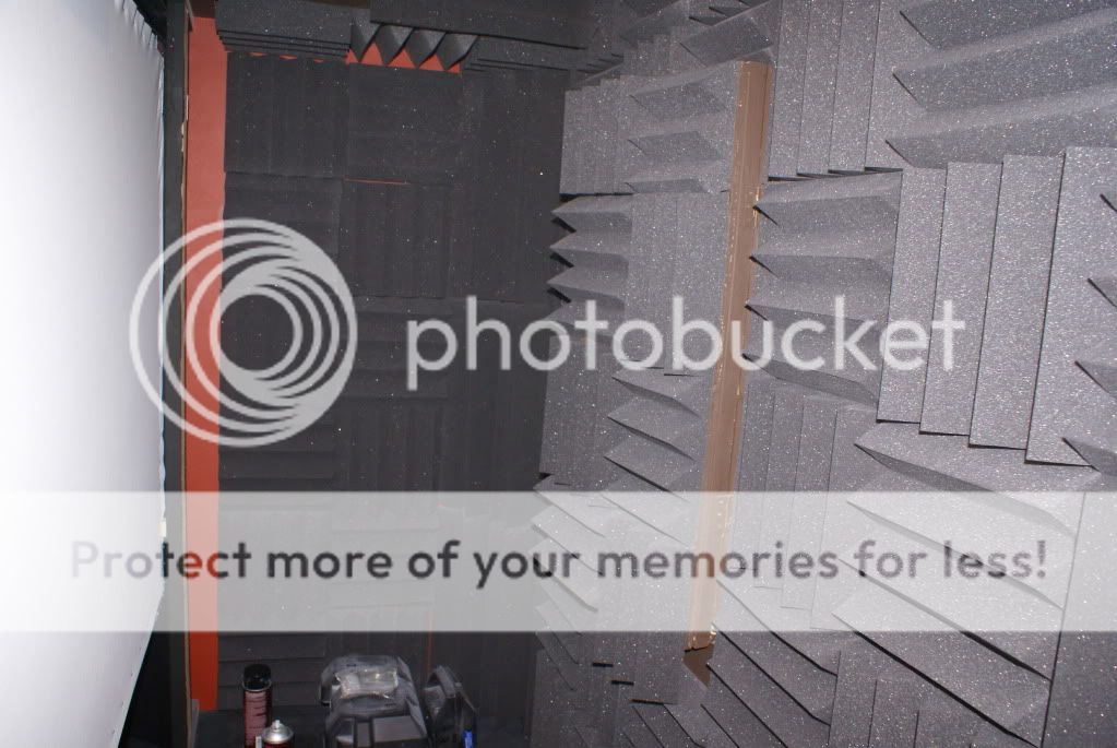

While waiting for my screen material, my low voltage wiring bits for the riser I/O panels arrived so I finished that install up. Didn't get a pic of the subwoofer outlets or the CAT6, VGA, USB panel. I plan to paint the outlet covers dark brown, but with the 1st row chairs in front of them, I may leave them like this:
Maybe not - those covers look really bright in the pic

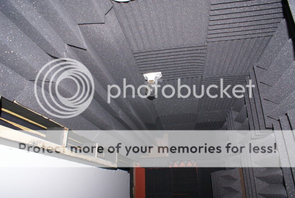

Chris at Seymour AV was very helpful and suggested that I beef up the screen frame as much as possible (since I'd planned to use lift supports - more on the past tense in a bit). Back to the hardware store and I added these:
Subsequently, I replaced the 4 outer brackets with 6 brackets to add more support

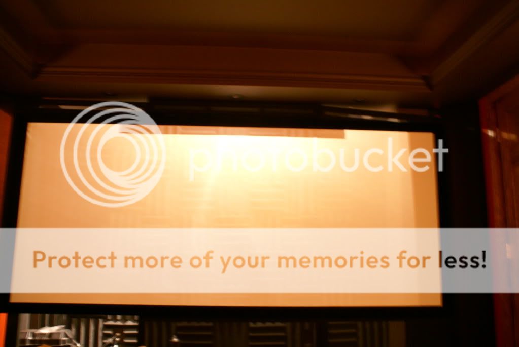

Confident the frame would hold, we added the screen material. After wrapping the frame with velvet went so smoothly, I thought the screen material install would be easy as well. It took considerably more patience to install the material without any ripples. We redid the stapling four times to get it right and got this:
So, we added two hinges to the minimalist screen wall and new screen
And got this:
Level, centered, light weight with free movement. I was pumped.

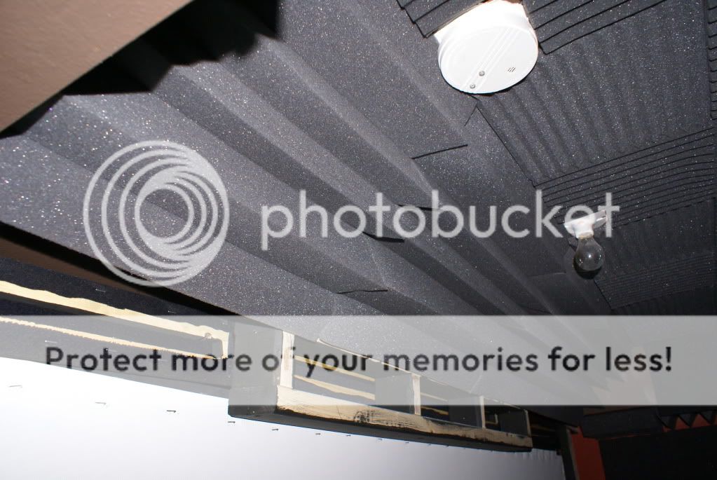

With the screen in place, I anxiously installed my lift supports bits. I don't have any pictures of the next series of events but the lift support plan did not work. As explained here in post #61 https://www.avsforum.com/avs-vb/showt...1139467&page=2 I made a number of construction mistakes that I feel compromised the lift idea. But, it seems the hinge selection and the DIY 1x3 frame were weak points as well as the span bowed and twisted when I connected the lift supports. I still think a more robust frame with a piano hinge would be successful. I may revisit the lift support idea at some point as I planned for my screen wall to work with or without them.

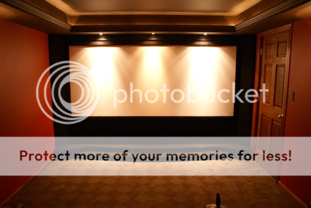

With my screen undamaged I decided to work on my false wall panels. Picked up some pine 1x2s and 1x4s. I couldn't find enough straight 1x2s so my son and I ripped the 1x4s.
I made the side framing first.
Then, I cut and laid out the top and bottom panels in the garage.
Here is a panel being made.
Test fitting in the HT
Everything sanded and ready for paint
My wood shop is now a paint shop. All pieces ready for speaker fabric from JoAnn's. The clerk's name was Ann. I thought of a few jokes but kept them to myself.
I do not have any pics of the fabric install as my wife finished them all while I was on grill dutyYes. A few dabs of Velcro later and we had this:
The screen wall just disappears. If I look hard enough in full light, I can see the seams. But, in movie lighting, the screen just floats. Yes!

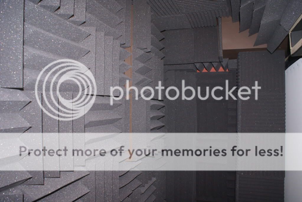

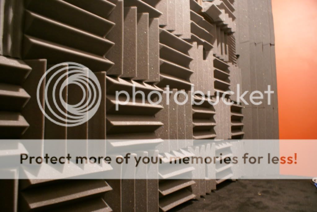

Since I've put my screen lift project on hold and after not being satisfied with my first attempt at a DIY rack, I decided to spend some time on my screen wall acoustic treatments. Originally, like many others, I'd planned to use OC703 and fabric as it is the best combination of affordability and acoustic performance that I could find. But, mindful of the need for ongoing access with the frequently running sump pump and the electrical panel, I decided to use something that wouldn't likely stir up a bunch of nasties when I started rustling around back there. After reading about it in Jamis' build, I thought that acoustic cotton would fit my needs as it practically matches OC703 for acoustic performance and needs no fabric covering. But, it is quite a bit more expensive than I'd hoped.
I chose acoustic foam as it had the right compromise of acoustic performance, aesthetics, and price for me. Though it is not the same material, I got the idea from Sandman's thread. Each wedge panel is 12x12x3 (12x12x1 on the ceiling) and the bass traps are stacked 12x12x24 pieces. I used 3M spray adhesive on all but the lower left bass trap. It is friction fitted above the corner of the sump pump access. Enough words, here are pics for reference.
A shot from the lower left (facing the screen) along the rear wall to the right side bass trap
The right side with the pillar treated
The left side with the breaker panel, sump equipment and removable bass trap
The treated ceiling
The ceiling bass trap - got the tip from guam
Here is a pic of the false panels going back on. You can see the opening on the lower left side that I use for access when the screen doesn't need to be lifted.
With everything back in place, the finished screen wall looks like this
I installed some accent lighting for zone 5 on the GE and got this
No real acoustic impressions yet as I'm waiting for gear to start arriving, but I think it looks pretty cool. I'll add a little velvet to hide the panel gaps where the screen hinges. Aside from a few other finishing touches, the construction of the room is basically complete. I still need a rack and in-room acoustic treatments but I may live with the room for a while before deciding what to do. I also need to decide on a remote control system and a projector.
My To Do list now looks loosely like this:
