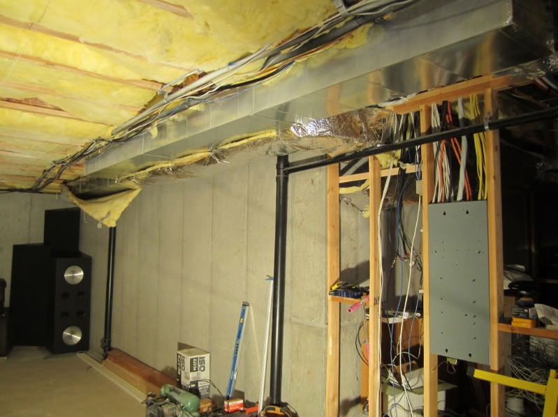

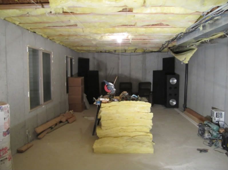

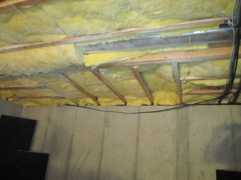

Here are some photos of the space I am working with.
This HVAC supplies the floor above - This will have to be removed.
I'm also going to have to work out some sort of access to the cleanouts on these drains.
equipment room will be where the electrical panel is. The panel only has a few slots left so I will be installing a 100A subpanel.

From the looks of it your panel looks to be a thirty-forty. What size is it? I highly doubt needing a subpanel for your theater. FWIW I am a electrician that lives in salt lake. Looks like fun

The panel is a 200A I believe. I only have one slot remaining in the panel. There are quite a few doubled up breakers already. I'm surprised at how inefficient they were when this house was built in regards to electrical. I have few things like my entry chandelier that are on their own circuit. The panel should have been more than sufficient, but many of the circuits are under utilized.

One other thing with the electrical that is strange is my entire 3 car garage only has 1-15 amp circuit with 2 outlets in the entire garage. I had some workers here grinding granite for a fireplace surround and they kept flipping the breaker - I had to run an extension cord from the laundry to give them power. Some of my sub-panel will go to the Garage for additional circuits and a 220 circuit.

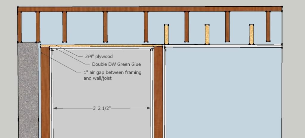

I'm planning out my framing and have a question - I am going to run 2x8 or 2x6 joists in between my current floor joists. However this is not possible for the last 4 feet of my room (the infinite baffle chamber) because some of the joists run perpendicular to the others and are hanging from a beam. The photo below shows what I am talking about.
I'm looking for ideas to isolate this portion of the room from the ceiling above. I know one option is to use rsic clips for this portion of the ceiling. What I was thinking I could do is have 3/4" plywood - 1" below the ceiling resting on the walls - I would mount the drywall to the ply - This would give me an additional damped layer which give even more low frequency sound isolation and the drywall should have plenty of support with only a little over 3' of span. I tried to show what I was thinking in the diagram below the picture. Is there a better option I am not seeing or problems with this approach? (other thicknesses of materials for flex etc?)
Here is the diagram showing what I'm currently thinking.

That's a nice space, looking forward to seeing the outcome. Is there anything special above that 4ft IB section that would have caused them to run the joists differently?

Not that I am aware of - I think they ordered 20 foot joists for the basement, and I think this was a way of utilizing the 5 foot sections that were cut off.
There is no bearing wall or anything above the doubled up joists.

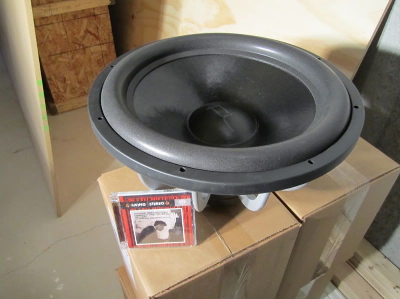

By the way here is a photo of one of the drivers I'm using for the Infinite baffle - the pictures really do not do a good job of showing how big these are - Those boxes that the woofer is sitting on each contain a 5 gallon bucket.
I would build the 3 walls for the chamber short and then use 2x4's for seperate joists and tie into the baffle wall to span the 3+ ft.
On a side note.....Since I didnt see anything in your drawing or in your pictures. If your in a cold climate, I would consider polystyrene for a vapor barrier on the exterior walls and if not done already I would treat my Rim Joist before I build and lost access.

Can you just use a lower ceiling in the IB chamber and drop the ceiling joists below the floor joists above? That funky floor framing must be there for a reason. Does the room above have a bay window or fireplace that's cantilevered out beyond the concrete basement wall?

I probably could get away with dropping the ceiling, but it will reduce the volume of the chamber. The larger the volume the better. Right now I am a bit smaller than the theoretical ideal volume. I figured 3/4 plywood would be plenty strong to support the ceiling and may even provide some flex to help with low frequency absorption. Either way I'm sure would be fine - I wouldn't mind the extra volume.

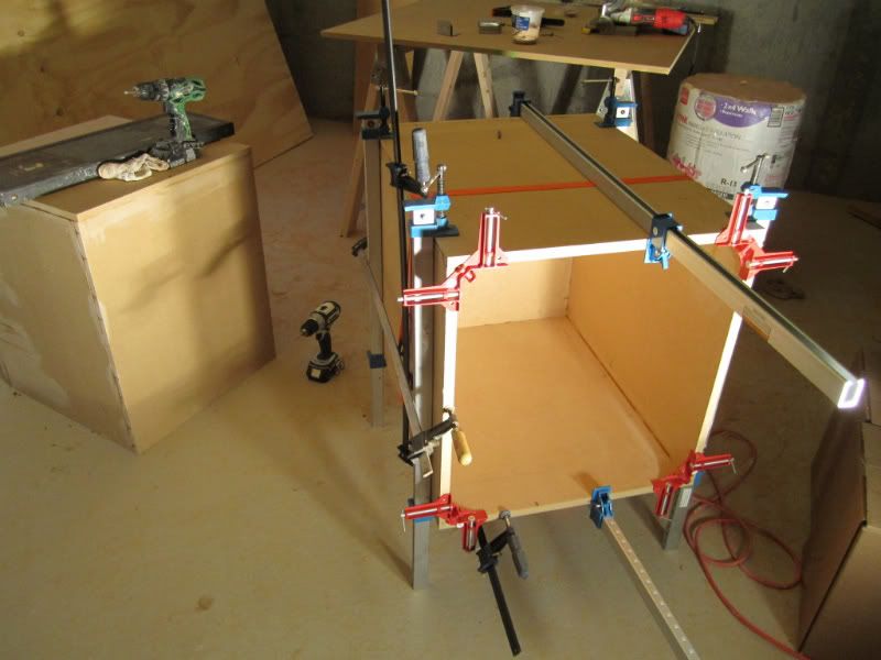

I also got started on the IB sub boxes. I needed to get these done early because I plan on finishing off the IB chamber first since the ceiling of the chamber will not tie in with the rest of the ceiling. I put together the boxes with a biscuit joiner. This is my first time using the joiner and it sure is a handy tool. Took me a while to get it right and I messed up on a few but it worked nicely.
stockmonkey2000 is offline

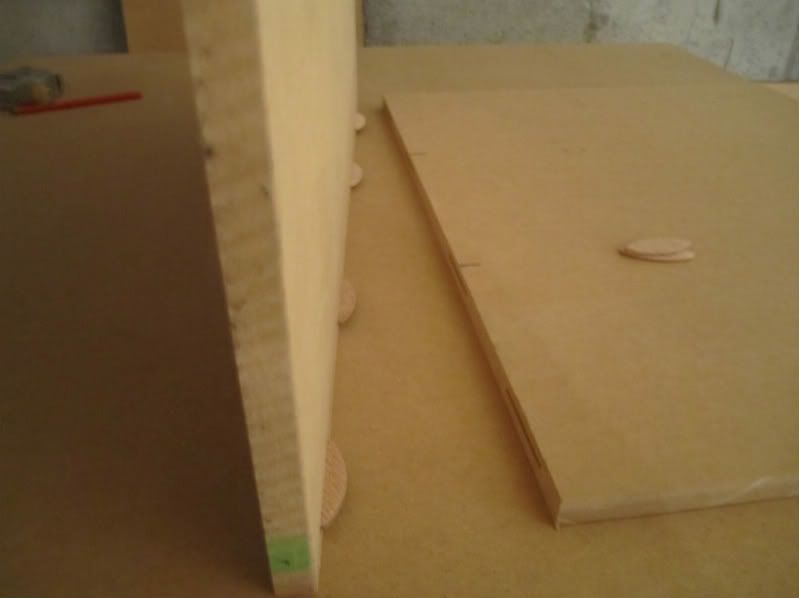

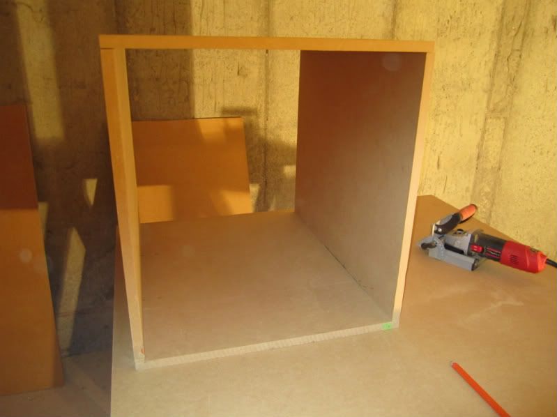

I made the IB boxes a bit larger than they needed to be. This is the first layer, and there will be another layer of ply on these. The final dimensions will be 25.5" by 24" by 28" with the driver on the 25" side. Rumor is that Fi is apparently working on a 22" IB driver and I wanted to make sure those would fit in case I want to upgrade later.
Here is the first box all glued up.
