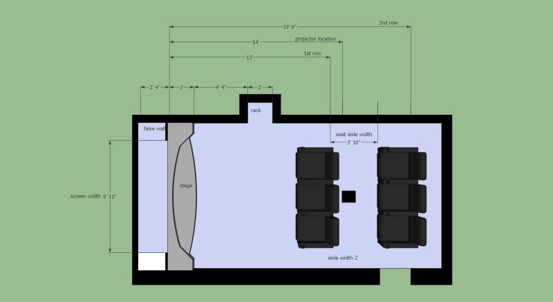

Overall, it's by no means fancy as what I've seen here, but I think it'll be nice. Here's a view of what's existing. I'll post pics shortly.

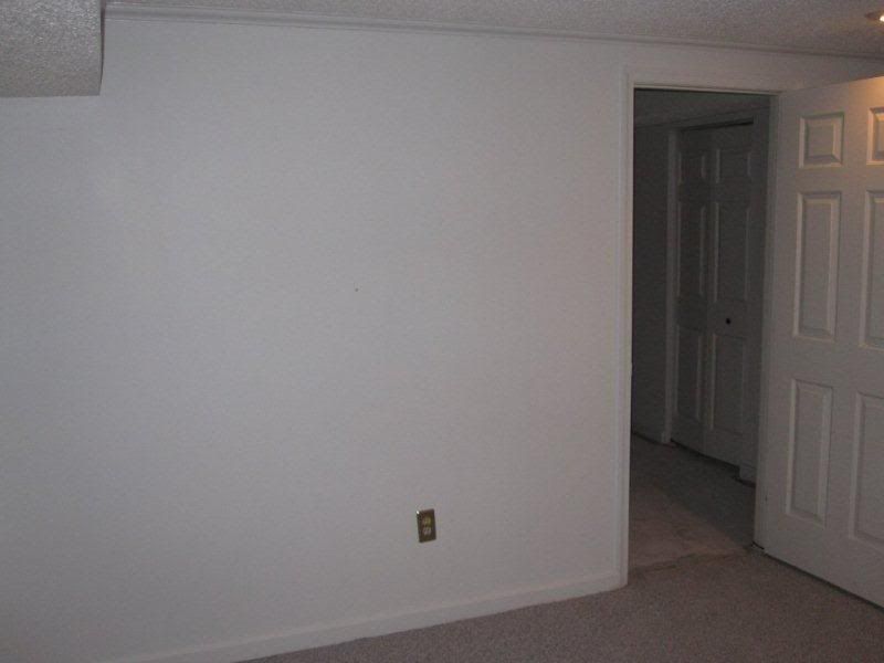

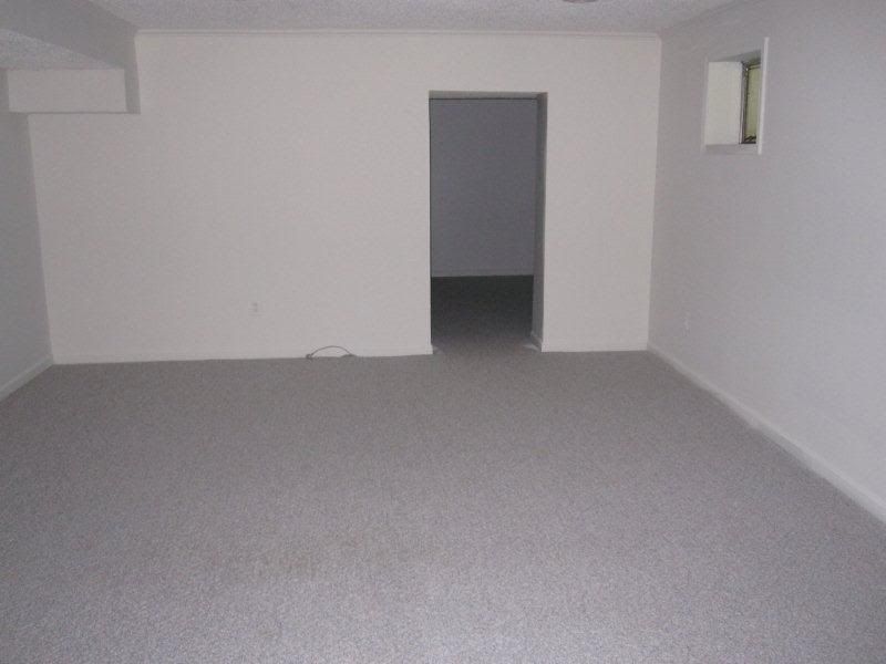

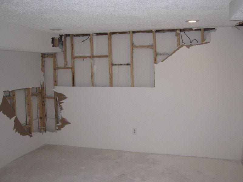

Here are some pics of the existing space.
Looking at the entry.
This is the wall between the 2 rooms that's coming down.
Future screen wall. You can see the main trunk in the upper left hand.
Back wall of the theater and exit.

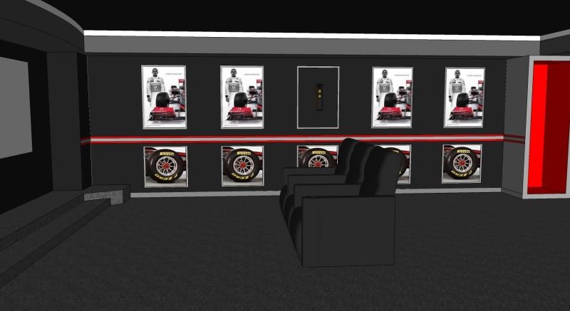

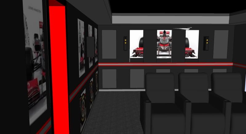

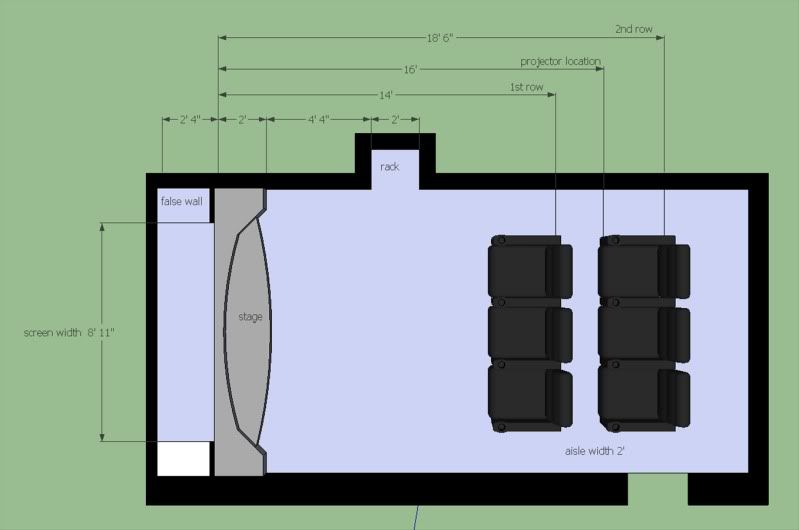

I tried a first draft on the room theme. It's ok, any thoughts? It's approx 14' from screen wall to seating and 16' to projector with 110" screen. I found a 5' rack with casters and glass door on Craigslist for $50, so I thought I paint the inside red. I think it looks cool, but in reality the glass is smoked and equipment/shelves will hide most of it, so we'll see how it turns out. The posters won't all be the same and I plan to try out some custom printed fabric from spoonflower to use as acoustical panels/posters.

I like the colors. Looks like you'll have a nice space when you're done.
Let me preface my next comment with I'm completely interior decorating illiterate, so take this with a grain of salt. I feel like you need more than just those two accent stripes in red. Once you get the rest of the posters up, it may take care of it. The other thing I thought of was a faux coffered ceiling using just trim (see BIG's thread) and use the accent color for the trim? It might be too much red, but it wouldn't hurt to put it in Sketchup and see how it looks.
Thanks JPA. I do like the idea of doing something to the ceiling. Maybe I'll do some racing stripes, ha! I'll model up the coffered ceiling ala BIG's thread too, see how it looks. The stripes are a chair rail, the posters are in frames, and I'll put in crown molding too, so there's places to add some more red.
Thanks trek. For some reason I'm more nervous doing the theater than I was doing the kitchen, maybe it's because there was no choice, the kitchen had to be redone.

Looks promising! If you plan on sitting 14 feet back, you'd probably prefer a bigger screen. That PJ at that throw distance can handle it.
gsearles is offline
I'll definitely go as big as I can manage. I get headaches if I sit too close, so I'll test it out on the wall first.

Well, it certainly looks as though you are looking at the right things in your design. Using the Panny 4000, you are looking at 13FL on the screen. That's a good number (but near the lower limit of 12). If you I am pushing the same in my theater and it looks great. When I visit other theaters that are pushing much more, they look so bright!

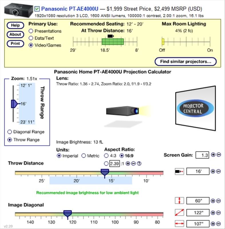

In any event, take a look at the Panny 7000 that was just released. It has more lumens available and your number will push to 16 or so...the extra brightness will be welcome. If you already have the projector, that's OK.
The isle between rows looks to be way too close. You are showing 2'! I have 5' and one can just barely get by someone sitting in a full recline. I think you can push your front row closer (if the angle does not bother you). In my setup, the front row's eyeballs are 11'6" from the 130" (horizontal width) 2.39:1 screen. A lot of folks like sitting that close. Others prefer the back row. YMMV

Yeah, thanks Carb. 2' isn't going to work. Ha, didn't really put much thought into it because I won't be getting a 2nd row for awhile, but still I need to make the space anyway. I originally thought to have the 1st row at 13' and the PJ at around 14' to get the brightness up to 14-16fl. I can't sit too close to the screen, so it's something I'll have to test out before installation. I haven't bought the projector yet. I'd love to get the 7000, but, I'll have to see if I can stretch the budget.

The 7000 is currently $2499. I think it will stay there for some time. The 4000 is around $1999. Methinks the $500 is worth it if you can swing it.
Buy the projector last. It may very well drop in price, or a new model released between now and the time when you get the room done.
I too thought about hanging the projector in the isle between the two rows. If you do a riser in the back, you'll need to factor in how low the projector is relative to the height of the people that will visit the theater. I ended up putting mine over the second row to keep it out of the way.

Would french doors work with the back row? Do you have the ability to widen the door frame?
French door wouldn't work, all the walls are 8" thick concrete and the doorway is just an opening in the wall, so I can't change it without a lot of work.
Speaking of doors, the door opening is almost 20" deep. As far as acoustics are concerned, should I put the door flush with the theater side, or flush with the basement side?
If you want to maximize the soundproofedness of the room you would put a door on each side creating an airlock effect.
