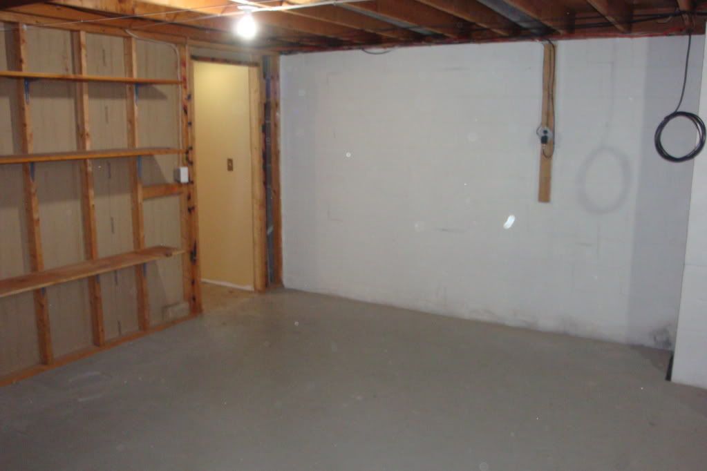

Here's some pictures of the before.
The screen will be on the wall which currently has empty studs from previous construction.
[IMG][/IMG]
The back wall will protrude out from where the concrete block comes out.
The doorway on the screen wall will be sealed and the entrance will be through a door underneath the HVAC trunk in a small hallway.
[IMG][/IMG]

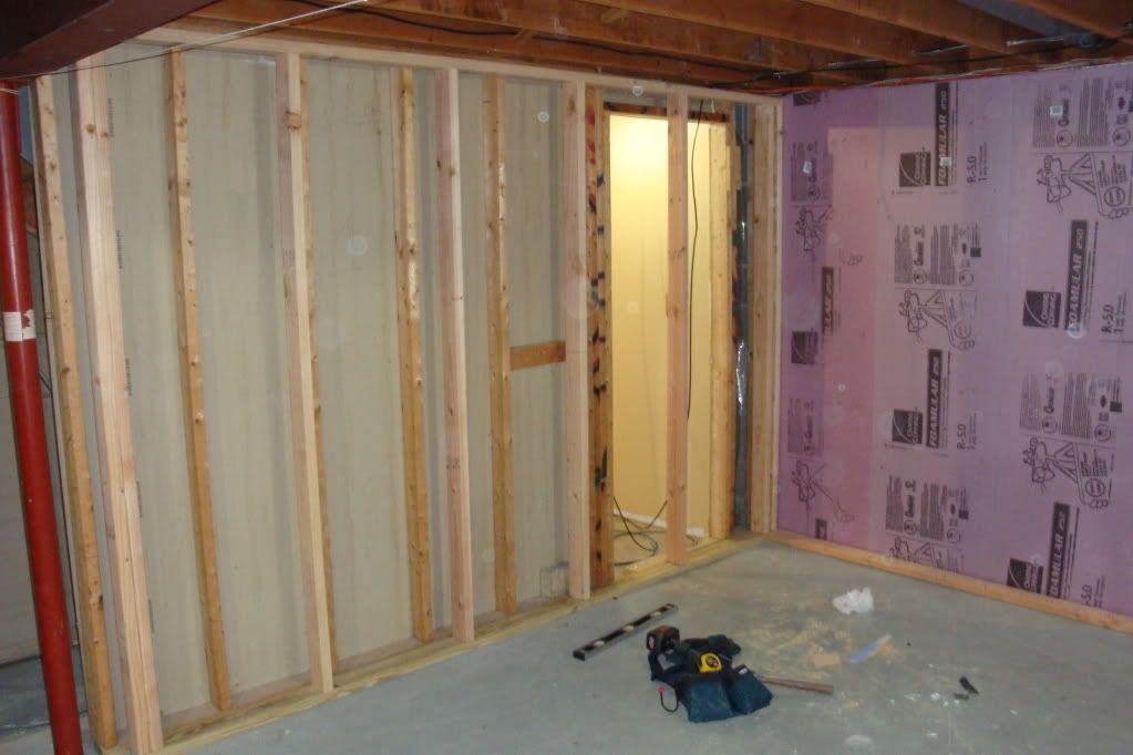

post #3 of 409 Old 11-07-2011, 06:41 PM - Thread Starter
aaustin's Avatar
Location: Upstate NY
Posts: 1,227
Liked: 36

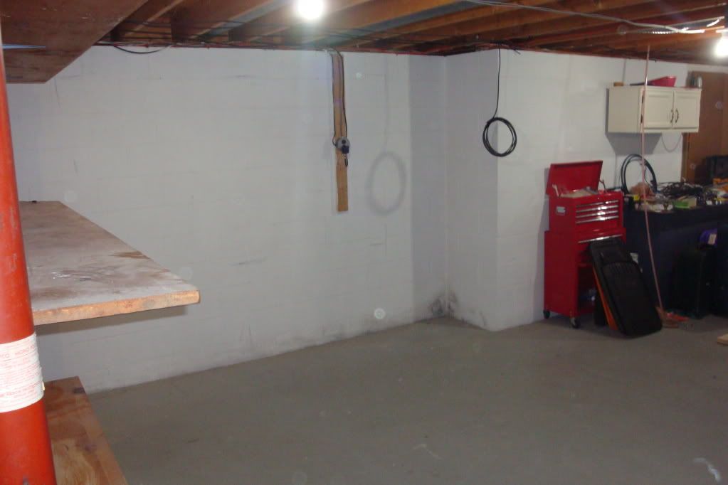

And here's what is done so far:
The outlet on the concrete block wall was moved to the workbench area of the basement and I put up the rigid foam insulation on the wall.
[IMG][/IMG]

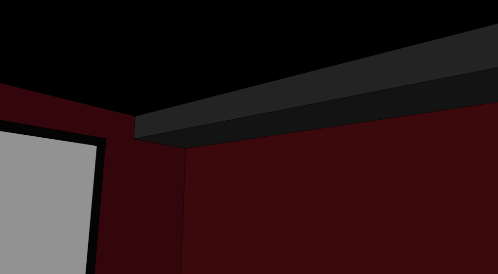

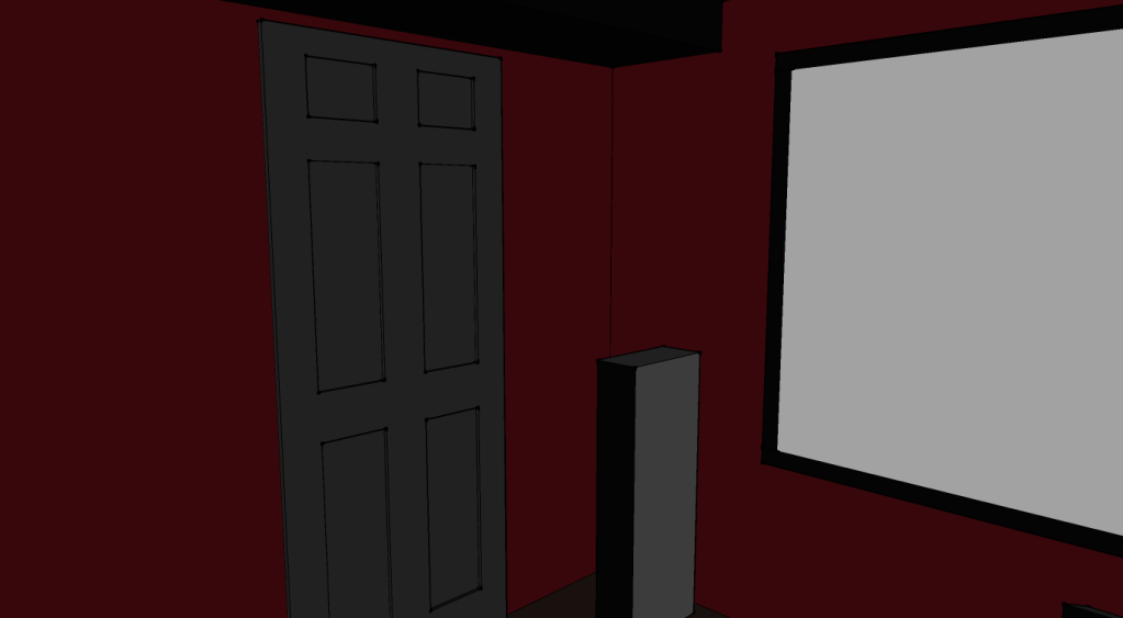

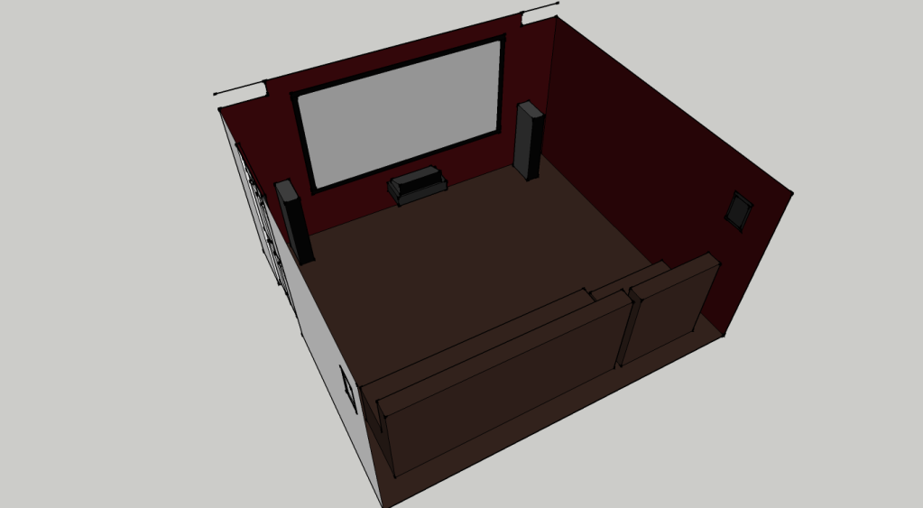

And here's some Sketchup models that I put together:
Room:
[IMG][/IMG]
Door:
[IMG][/IMG]
Soffit:
[IMG][/IMG]

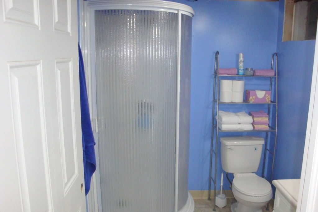

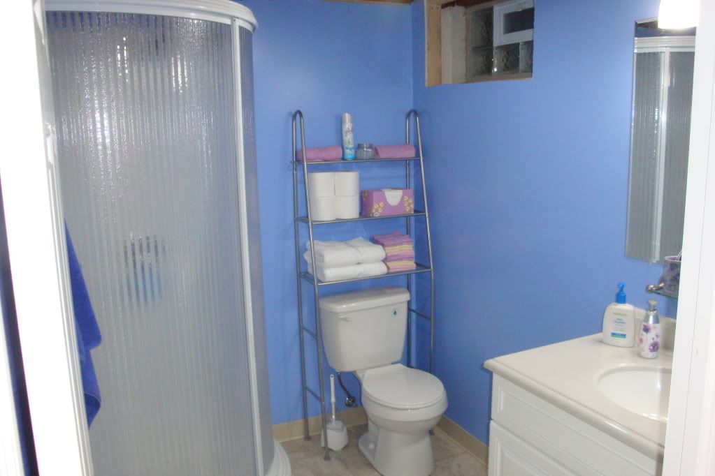

Ok so here is a weekend update. I didn't get as much work on the theater as I would have liked this weekend but the basement bathroom was finished and it turned out very nice. In the theater I rearranged the lights and moved the switch for the unfinished storage area and framed the screen wall. My current goal is to have the room framed, wired, and drywall hung by the end of Thanksgiving break. Keeping my fingers crossed as that will keep me on schedule. Pictures follow.
The framed wall:
[IMG][/IMG]
Some pictures of the basement bathroom:
[IMG][/IMG]
[IMG][/IMG]

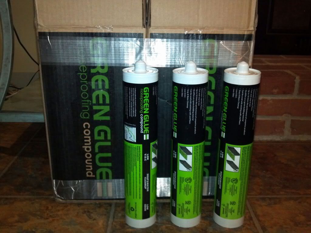

[IMG][/IMG]
Nothing like a shipment of Green Glue to get you excited!!!
After reading about this stuff for the last few months it feels surreal to actually have it in my own house. Time to throw the builder in me into high gear so I can get to installing it. Now to find a contractor size caulk gun...
I have to thank everyone at The Soundproofing Company one more time. You gave me the greatest advice I could ask for and allowed me to get the best sound isolation I could with a limited budget. Everyone should call you guys for everything relating to soundproofing!

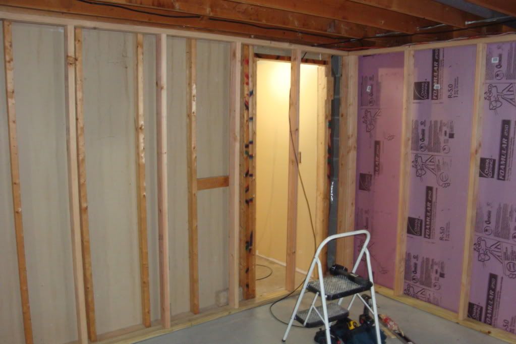

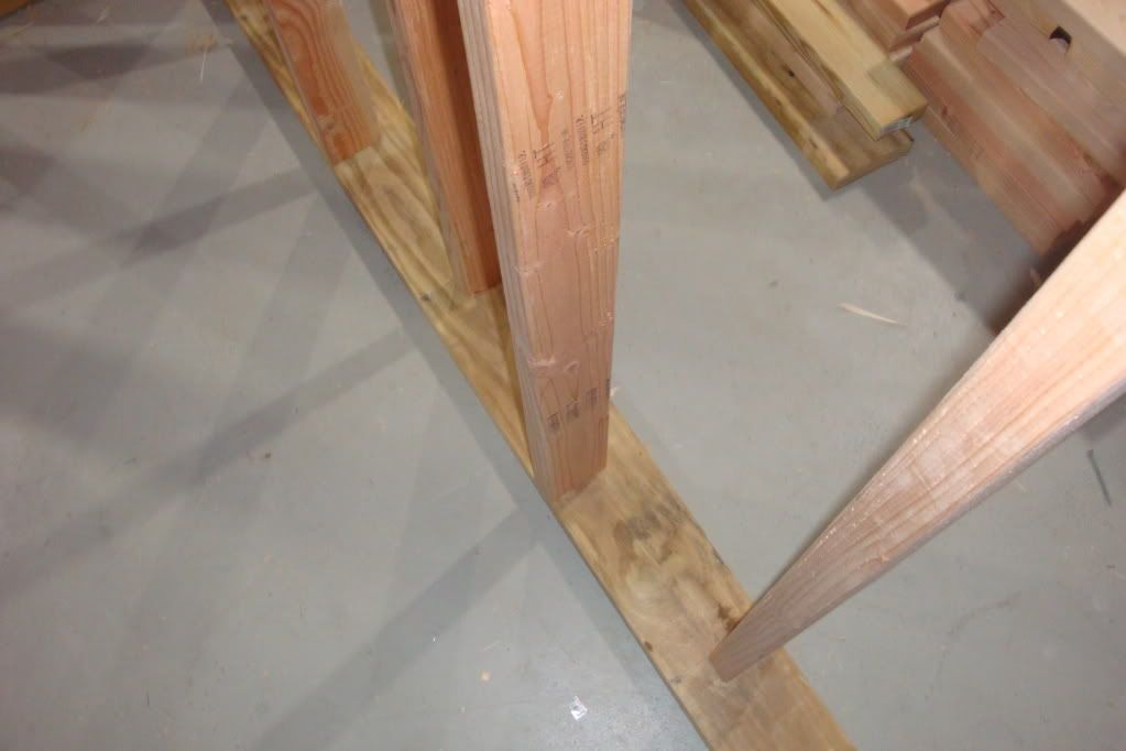

This weekend was very productive. I was able to frame all of the walls (The staggered stud ones are HEAVY). It's really starting to take shape and I can picture it now. The next step is the electrical rough in. Pictures of the completed framing will follow when I get home and I can post them.

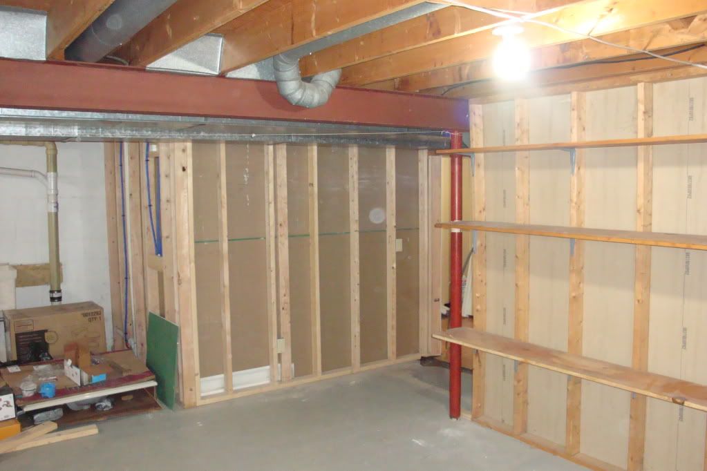

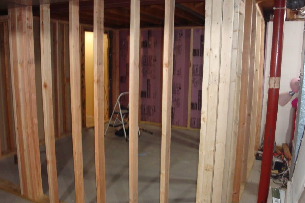

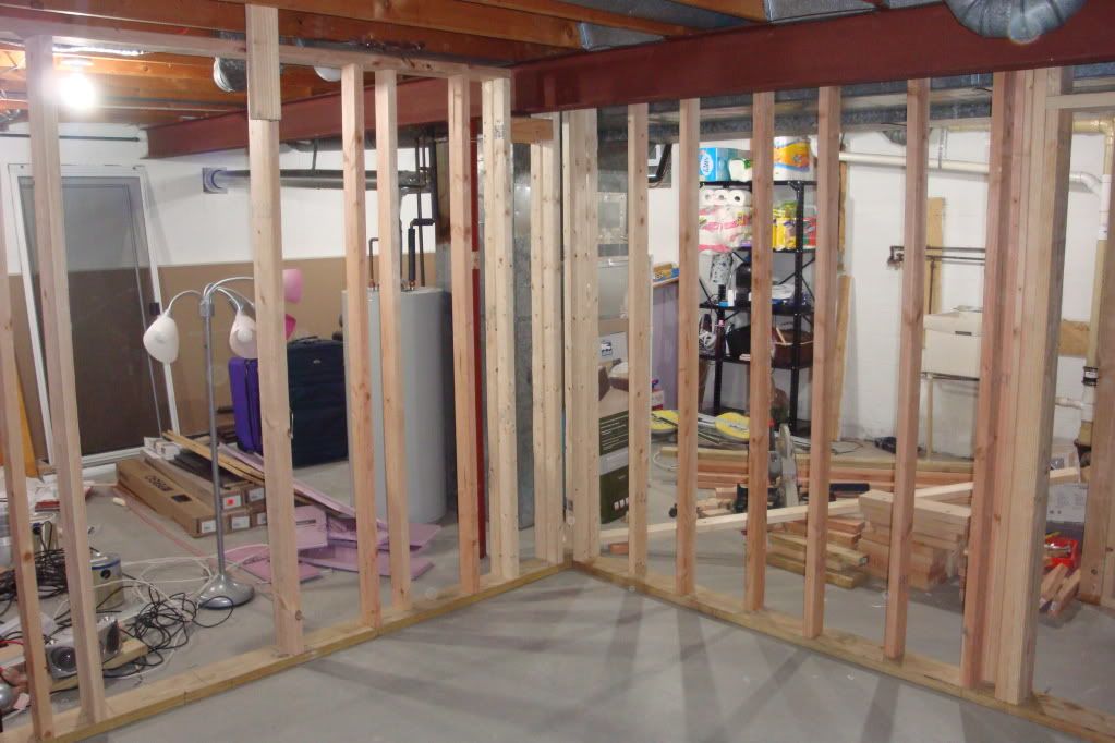

Here are some pictures of the finished framing:
The doorway from the entrance hallway:
[IMG][/IMG]
Screen Wall:
[IMG][/IMG]
Back and side wall:
[IMG][/IMG]
Looking in from the storage area:
[IMG][/IMG]
Staggered stud wall construction:
[IMG][/IMG]

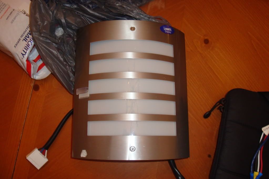

I also picked up two wall sconces for the "entrance hallway":
[IMG][/IMG]

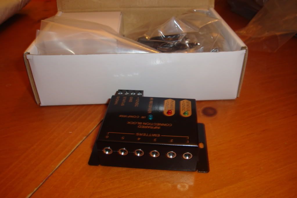

And the IR Repeater System came in the mail:
[IMG][/IMG]
