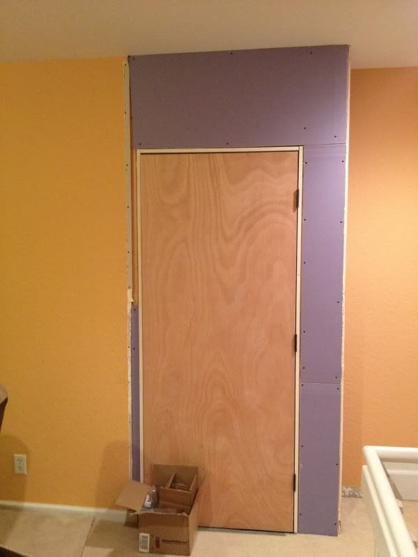

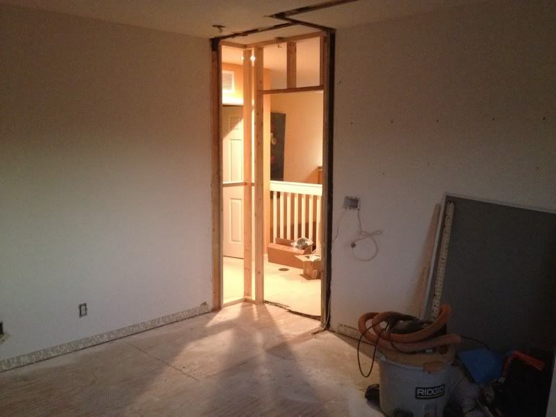

My brother and I wreaking havoc on the closet
Closet out, screen wall is the wall on the right
here is the recessed wall that needed to be squared with the rest of the room
the room squared off and carpet removed
Solid core door with exterior door frame and drywall installed (that door is frickin heavy, notice the three hinges!!)
Ran some speaker wire and the hdmi cable to where the projector will be, looking forward to tomorrow!
Next we need to drywall the cut out where the closet use to be. Upcoming will be a lot of GG and DD!!

Excellent progress. Looking forward to seeing your progress. Yes solid core doors are very heavy, but that is a very good thing.

Yeah I just picked up my solid core door today. I know what you mean about the weight but as RTROSE said, that is a very good thing.
By the way I like the Monoprice box! Did you get all of the wallplates?
