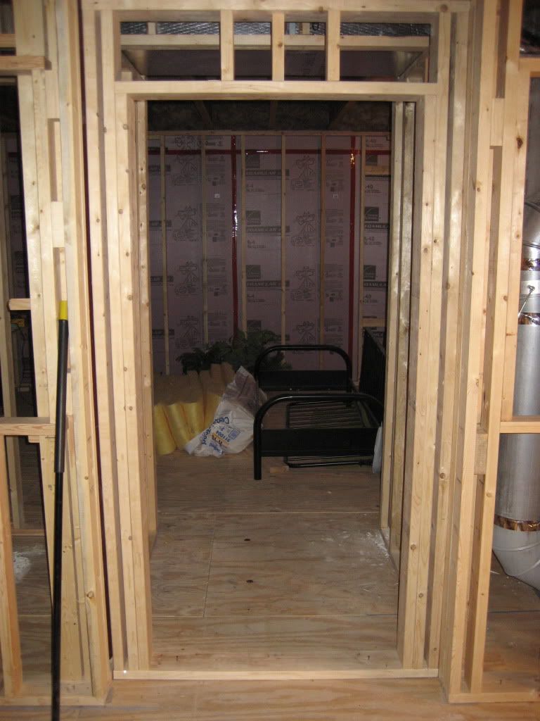

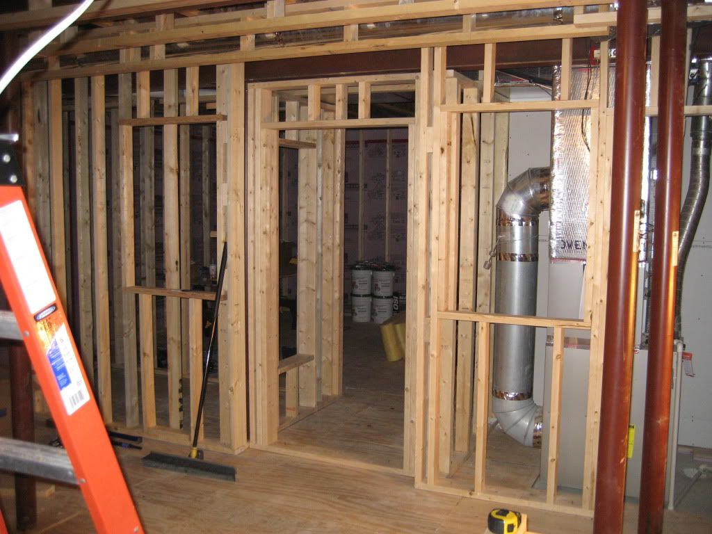

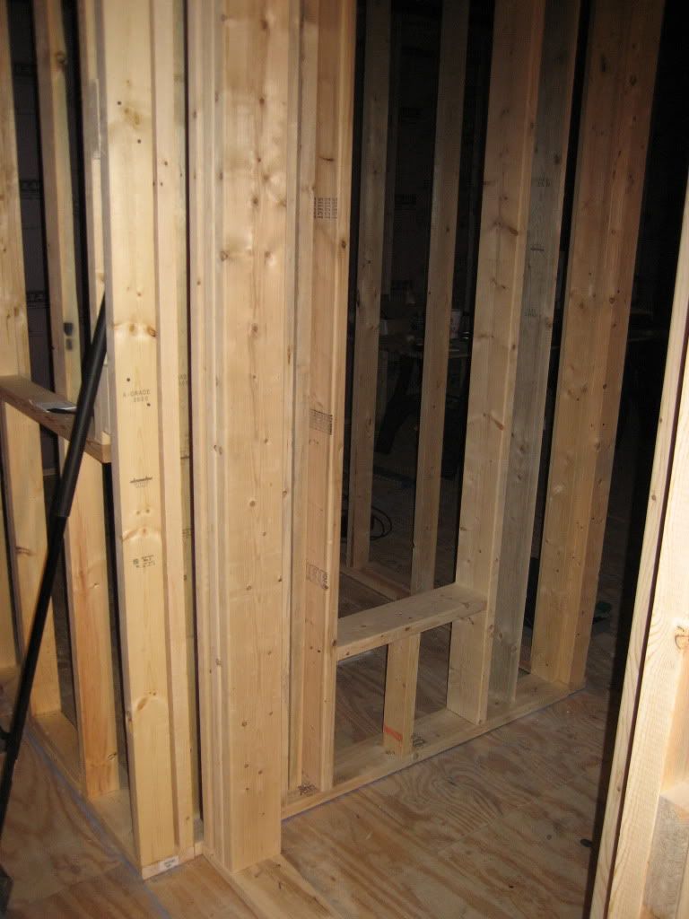

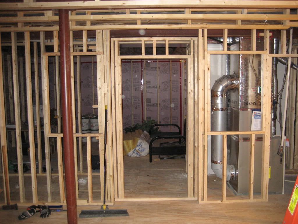

A few more pics. Getting close to finishing all the framing details for the theater.
Nearly complete entrance.
Rack location in the entryway.
Entrance view from inside the theater.
Also worked on the ceiling structure in the equipment room and entrance. One of these days I'll have something new to share other than framing pics.

Looks sweet! That is a lot of framing. Just wait until electrical.
Keep up the great work!

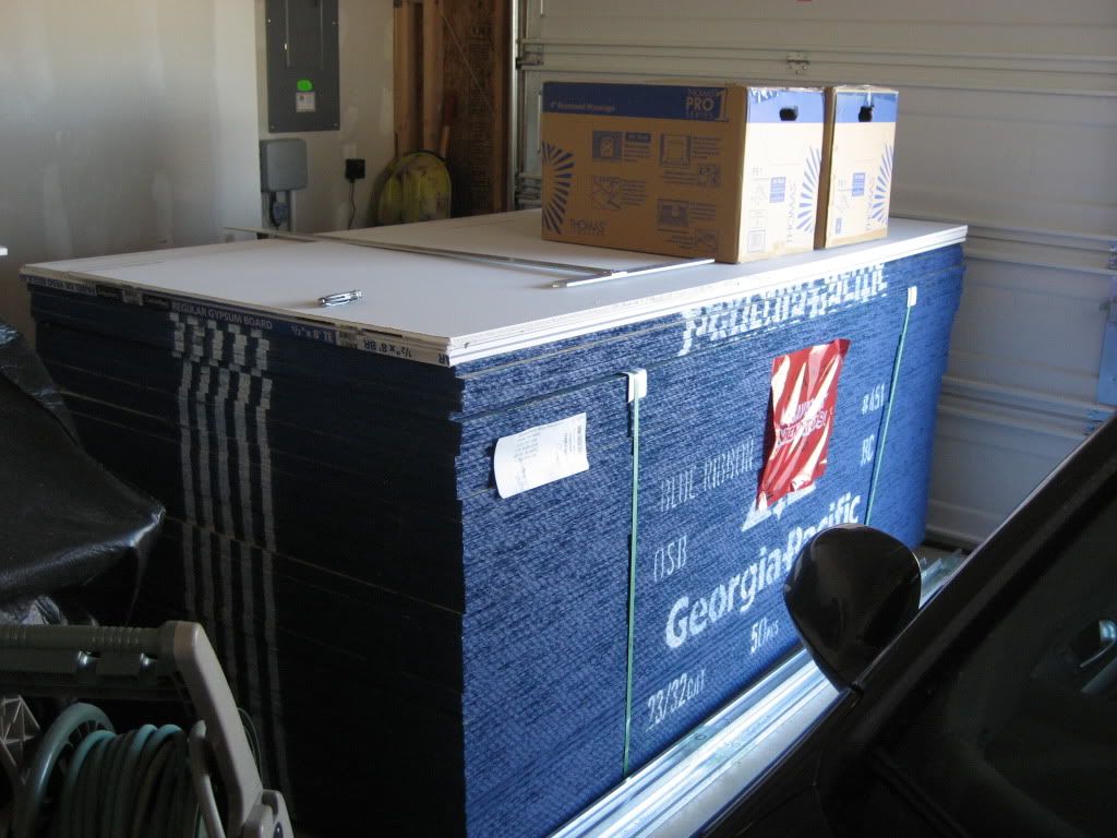

A few deliveries have shown up.
Bam!
Looking forward to putting this stuff to use. Quick shipping from the Soundproofing Company.
vanice is offline

Wow. That is a lot of OSB and Green Glue. Good choice on the OSI sealant. It is what I am using as well.

Tell me about it. Theater, equipment room, and IB enclosure all getting OSB. Hoping that the floor joists above can handle all of it.

Here are a few pics of progress.
The updated theater entrance.
And soon... let there be light!

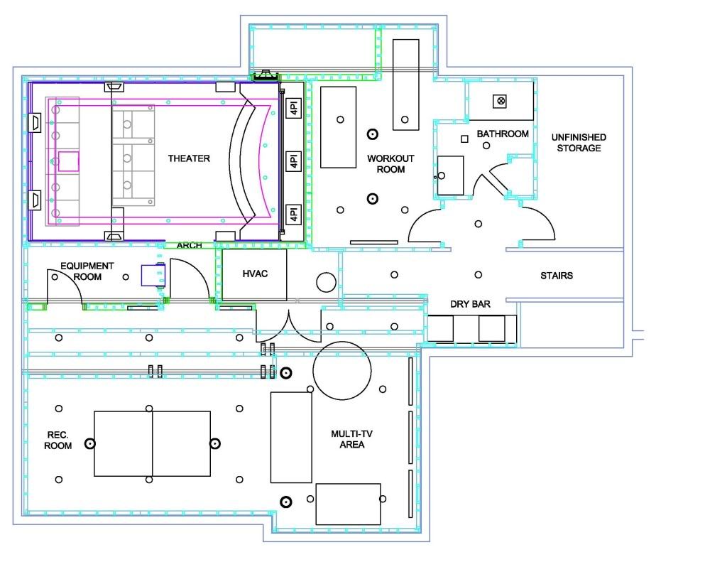

I'm going to be getting to the stage where I need to run all my low voltage throughout the basement and I am getting a little worried that I might forget something. My equipment room will house most (if not all) sources. I have four main areas in the basement that I will need to supply: theater, workout room, multi-TV area, and main req area. This does not include other rooms on the first and second floor that I will have to reach (though most will be a copy of what I do in the basement). The obvious answer is to run conduit to all locations so that I am covered. I plan to do that to an extent but I don't want to fill the conduit at this time. I would prefer it to be for future needs. So is there anything that people have looked back on after the fact and said, "man that would have been nice to add"? One example is have a place to plug in an iPod to play music over in-room speakers. Or have multiple LFE connections in a room so that you have flexibility in sub placement (or the ability to add more than one).
Here is a quick reminder of the floor plan:
Theater
1) Typical viewing on projector (video games, BR, DVD, cable, HTPC), 7.1 surround sound
Workout Room
1) TV (BR, DVD, cable, HTPC) w/ in-ceiling speakers that I would like to have iPod when desired.
Multi-TV Viewing Area
1) Three TVs viewing independant sources (video games, BR, DVD, cable, HTPC), 5.1 (or 5.2) surround sound
Main Rec Area
1) Really just in-ceiling speakers for music listening.
Any help you guys can give me would be greatly appreciated. I think this stage could paralyze me if I think I might be missing something.

If you will have all of your components housed in the closet then I would recommend doing some HDMI wallplates throughout to plug in other sources like cameras since it would be cumbersome to try to cycle through pictures or what not from the closet. I wired an HDMI, composite video, 3.5mm jack, and ethernet to a wallplate in the room for that very reason. The 3.5mm jack will also come in handy for the Audyssey setup.
Since you'll have so many displays and components have you thought about doing an HDMI matrix system? I'm no expert on them but it allows you to hook up all your sources so that they can be played on any combination of displays. They can get kind of expensive but I think monoprice has one for a reasonable price.

You are right about not wanting to have to run back and forth to the equipment room to plug in temporary things. I like the idea of having inputs in various locations.
I have looked into matrix switches some but am still learning. My guess is I will try it without for now but maybe look to add if I realize that I can't view something that I want to. Looking at doing a Ceton card with media center extenders (or multiple xboxs) to provide cable and gaming to all the TVs. The popcorn hour may need a matrix switch since I don't plan on having multiple PCHs.

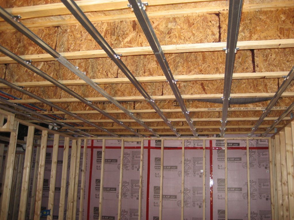

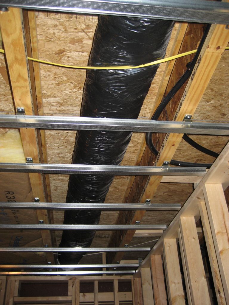

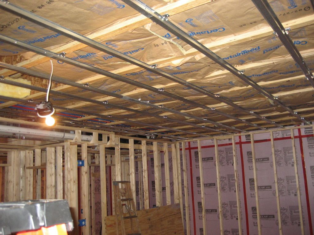

Finally some theater progress! Pics, pics, pics...
Channel is up on the ceiling.

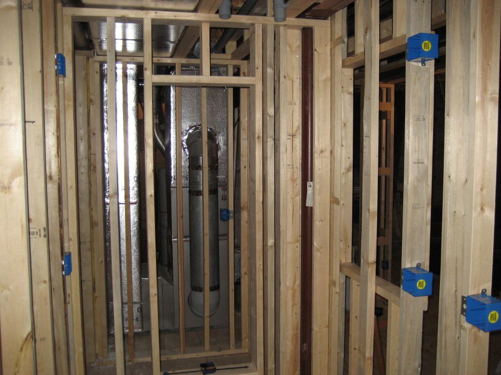

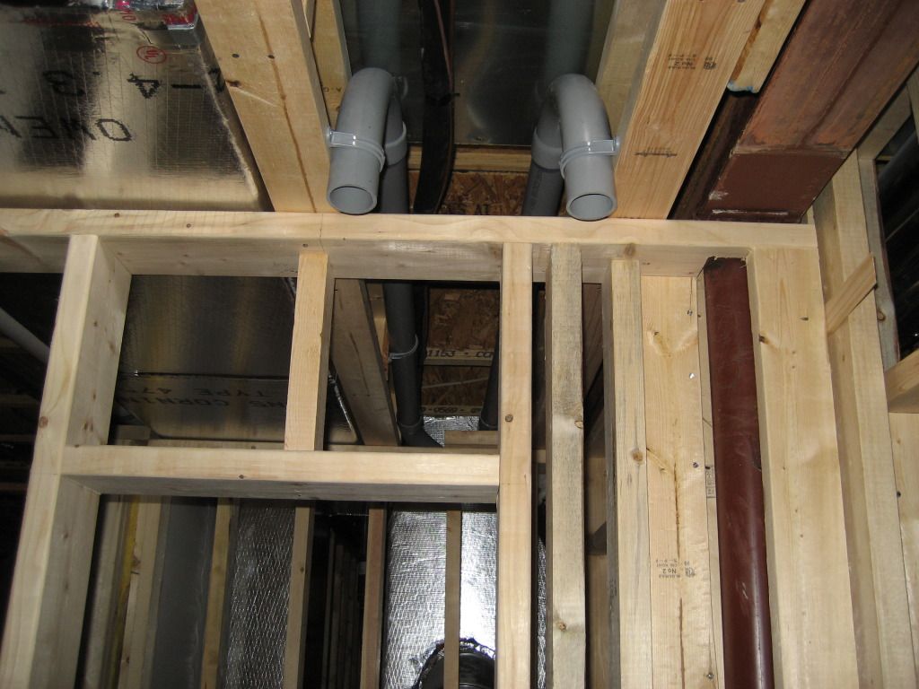

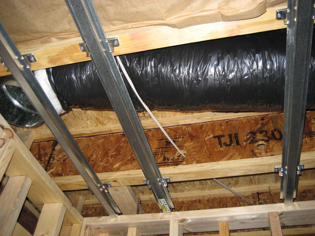

Conduit in the ceiling between the equipment room and the HVAC closet.

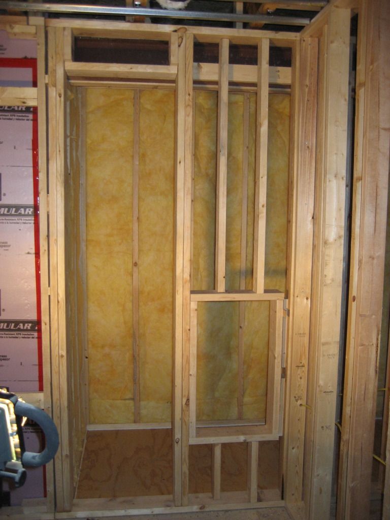

Framed a hole in the IB enclosure for access. This will be behind the screen.
Caulked the bottom of the IB enclosure.

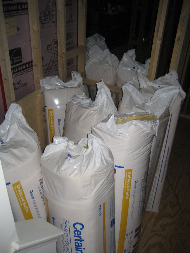

Lot's of insulation...

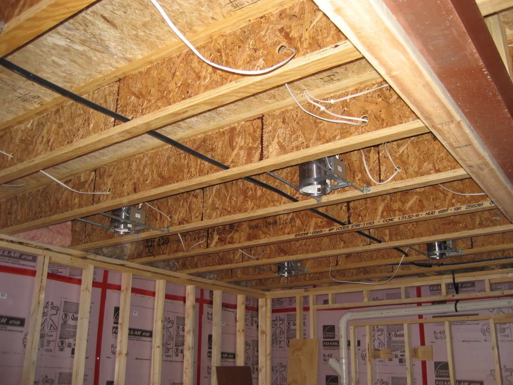

Outlet locations and conduit in relation to rack opening.
Got most of the insulation in the ceiling above the theater room. Have to pull down the ceiling in the IB enclosure to put the batt insulation up. Today was a long day. Started off with the plan of using blown-in insulation for all theater related areas but after wrestling the machine from the store to the house it was just logistically impossible to use. I really wanted to use blown-in but it just wasn't to be. Instead I am using kraft faced R-30. Hopefull it won't be too much of a concession.

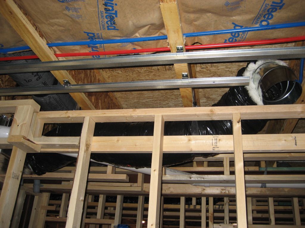

Return air vent. Will be located in the right side soffit.
Air supply. Will be located in the left side soffit.
This week I hope to get most of the insulation up so that I am ready to put up the OSB on the ceiling next weekend.
Question for those who have installed drywall/OSB on furring channels. It says to use fine thread drywall screws for attaching to the channels. Is there anything special about the screws? Other than them not being to long to interfere with the clip/channel connection. I'm worried that the fine thread screws won't have the holding power in the metal channel. Seems like they would be easy to strip out. Any thoughts would be appreciated.

So much progress!!
Looking really good. I know how nice it feels to move on from the framing stage.
I know it's too late now but the general consensus here is the use R-19 fiberglass batts in the ceiling and R-13 in the walls. Anything more and you're spending unnecessary money for little to no improvement. So if you haven't used all of the R-30 I'd return it and save yourself some cash.
Also be sure that the insulation isn't compressed or you will recouple the structure. When you install it in the staggered stud walls cut the batts to fit vertically between the studs on both sides. So if your framing is 16" on center each batt would be 8" wide to fit between the front and back studs. That way you won't have any compression through the wall.
Fine thread screws are made for metal. They are whats used in steel stud construction so they also work well in the metal furring channel. Don't be concerned about their holding strength, it's what they are designed for. Coarse thread is for wood so use those on the walls. I used 1 1/8" fine thread for the first layer and 2" fine thread for the second layer on the ceiling.

Had it not been for the insulation incident I would have probably had a lot of the OSB up on the ceiling already. I was mentally and physically drained after f'ing around with the insulation machine. That thing is not DYI friendly.
Unforturnately I have most of the insulation up and only like one package that hasn't been opened. Really wasn't too costly compared to the other options. Believe it or not I was going to try and get R38 for the ceiling! Had it not been for the nearly 50% premium I would have gone that route. Glad to hear I saved that money which is nice.
So when installing insulation in a staggered stud wall I only put 8" pieces in each cavity and not one full piece in each 15 1/4" cavity (effectively doubling my insulation)? It didn't seem like it was all that tight in the wall. If I can save some insulation that would be great but it seems like I will have a lot of voids created by the framing.
I was just worried that the fine thread screws I got didn't specifically call out metal usage. I may see if there is a different brand that says it can be used for metal. Otherwise I should be good to proceed with the ceiling.
Thanks for following along. Seems like you are about the only one watching... granted it is just now starting to get a little interesting.

Ok so in regards to the insulation:
Your staggered stud wall is 5.5 inches deep. In between each set of studs on the theater side there is a stud in the middle for the other side. That means that along that middle stud there is only 2 inches between the front of the bottom plate and that stud. R13 insulation is 3.5 inches deep so if you lay a batt across that stud it will be compressed and recouple your wall. To stop this you install two 8" batts in each cavity (one on each side if the back stud) so that it doesn't compress against the back stud.
I hope that makes sense now.
