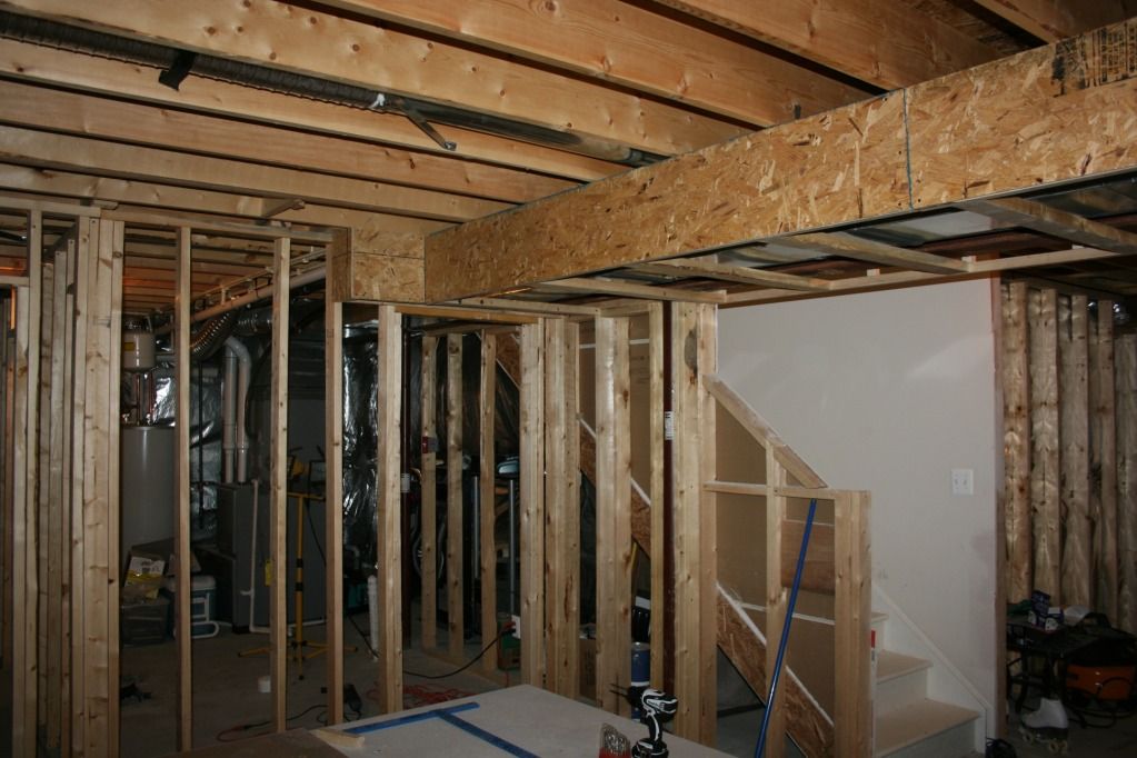

the hvac main trunk is now framed in ..... yes i know some will say i could of framed it tad closer to the have trunk line but even with new homes not every thing is build perfectly level and straight so i framed where i knew it would not hit at point and i did not 1by wood because the width of the box is over 40inches .....

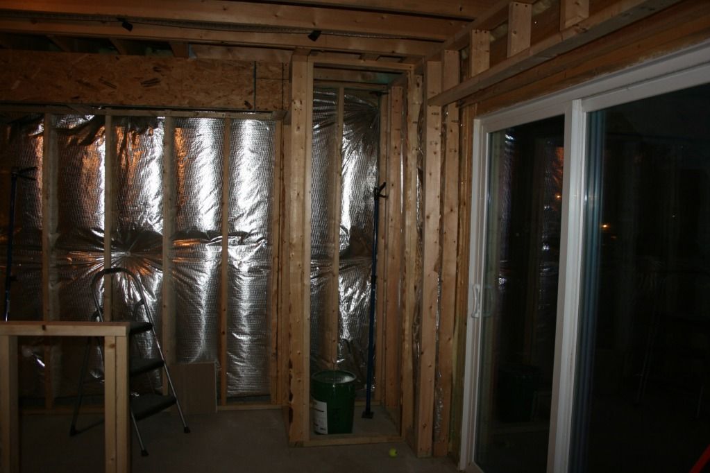

i will ut 2 two pot lights in this for above the back of the bar
also framed the equipment closet to the right of the bar this is the best spot imo , very easy access to vent it outside the house and in spot that will take no space away from the theater area

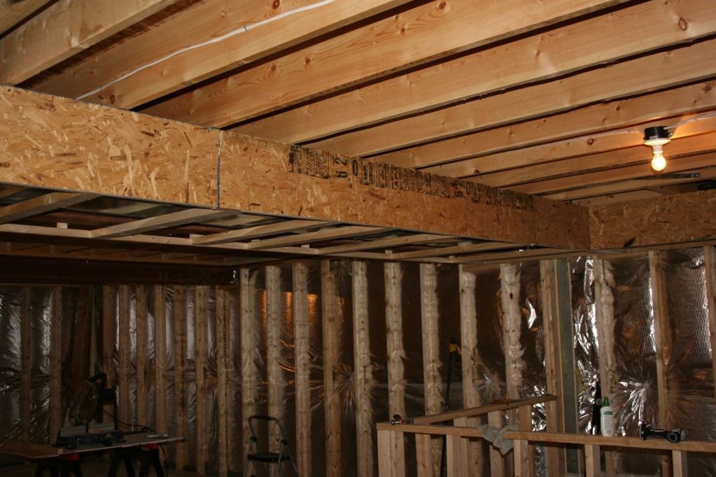

i have not updated in a while but last week had the HVAC guys out they installed 3 new vents/runs all which where quite duck and also a new return, also ihave installed the electrical distro panel and it now hocked up to the main breaker box in the garage. running 6/3 wire is not so much fun smile.gif
but it is all done. i have hocked up all the circuits except what will be going into the theater area.
getting very close to drywall time, all that is left before drywall is running speaker and RG6 and cat6 cabling , and hanging the hat channel on the ceiling so with that said i need some opinions of the soffet around the theater area
i have a set of stairs and two beams to contend with,
option 1 i was thinking of doing the soffet and pot lights inside back boxes in the ceiling and rope light in soffet
option 2 lights in soffet like bacon race and stair ceiling on either side of beam
open to any thought and any idea
