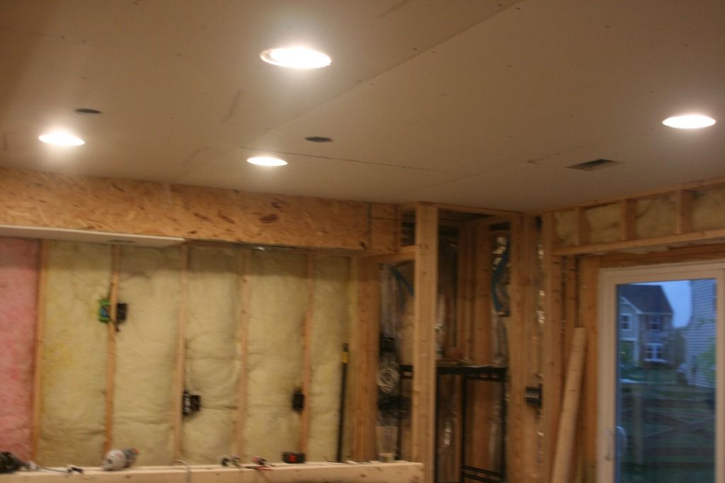

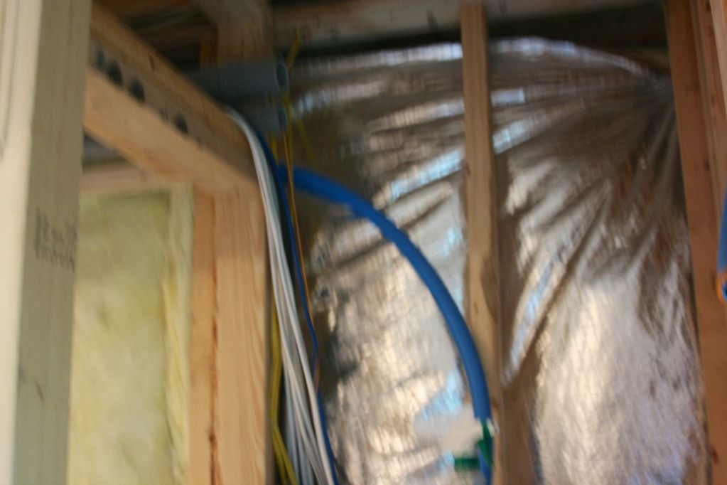

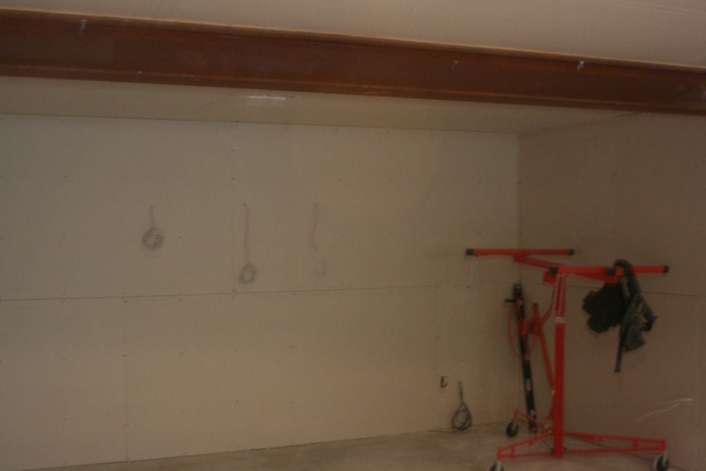

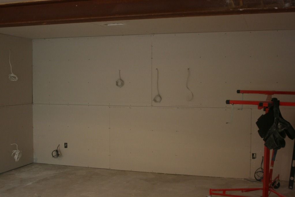

two conduits have been run one is for the hdmi and cat6 from the projector to the equipment closet and the other is from the network patch panel to the equipment room fro running network cabling
400
400
ping stuff going up .... used unfazed because my basement already has the silver stuff so no need for two vapor barriers
400
first layer of drywall going up
400

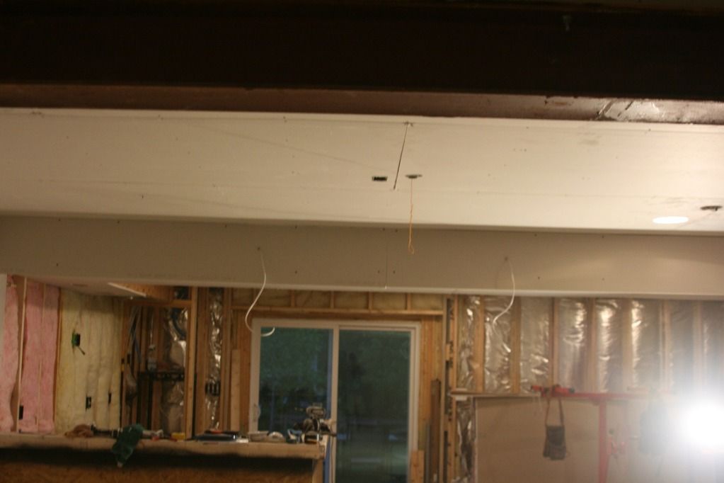

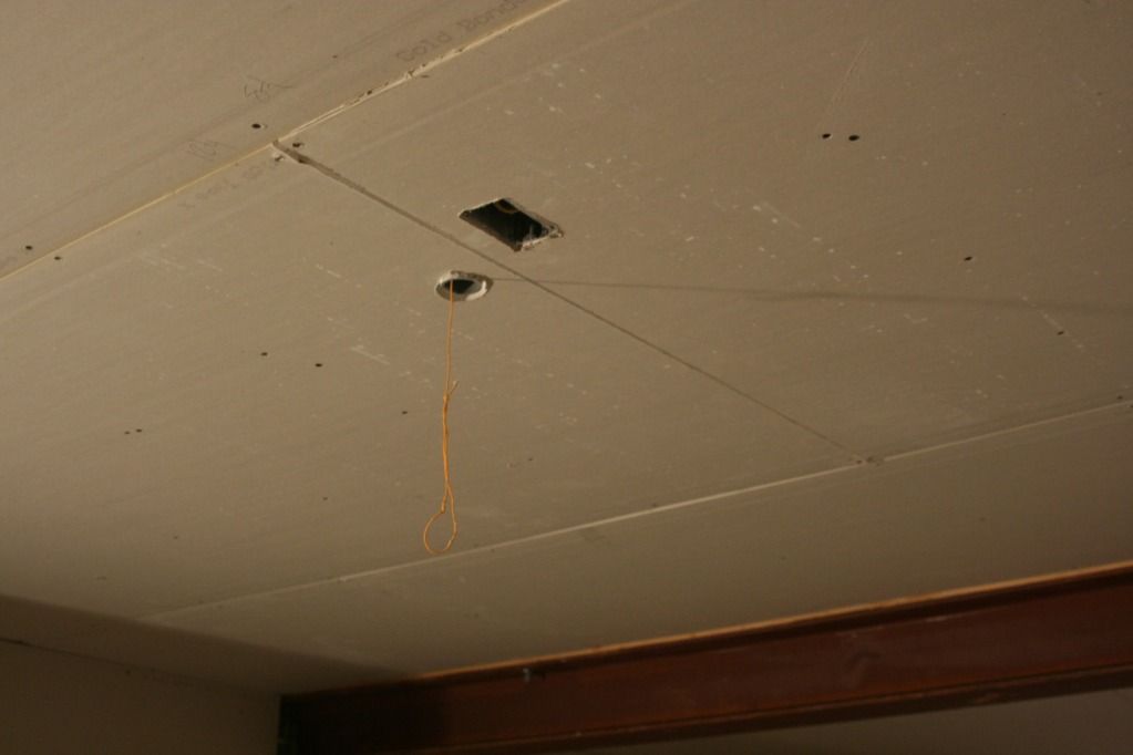

i have run into a slight problem with figure out how to setup the rear speakers
they will have to be in the ceiling and the prob is that i have HVAC ducts int he way and there is really no option of moving them in this situation
i can do it this way and was wondering if any one else has done this way ?
300
snickers1 is offline

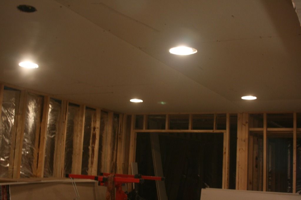

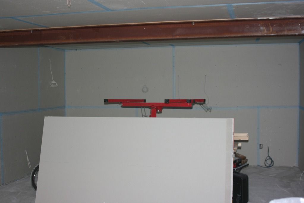

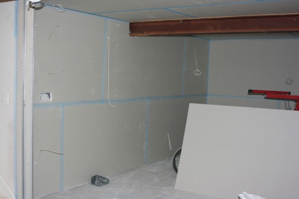

long day today ... me and my friend got the two layers and green glue on the ceiling in the theater area, also got the first layer of DW on the walls in theater area.
got the first layer of DW up in the bar area and also got some of the bulk head done.
And with this i have decided i will contracting out the mudding and taping and finishing of the drywall biggrin.gif
4AlexF likes this.

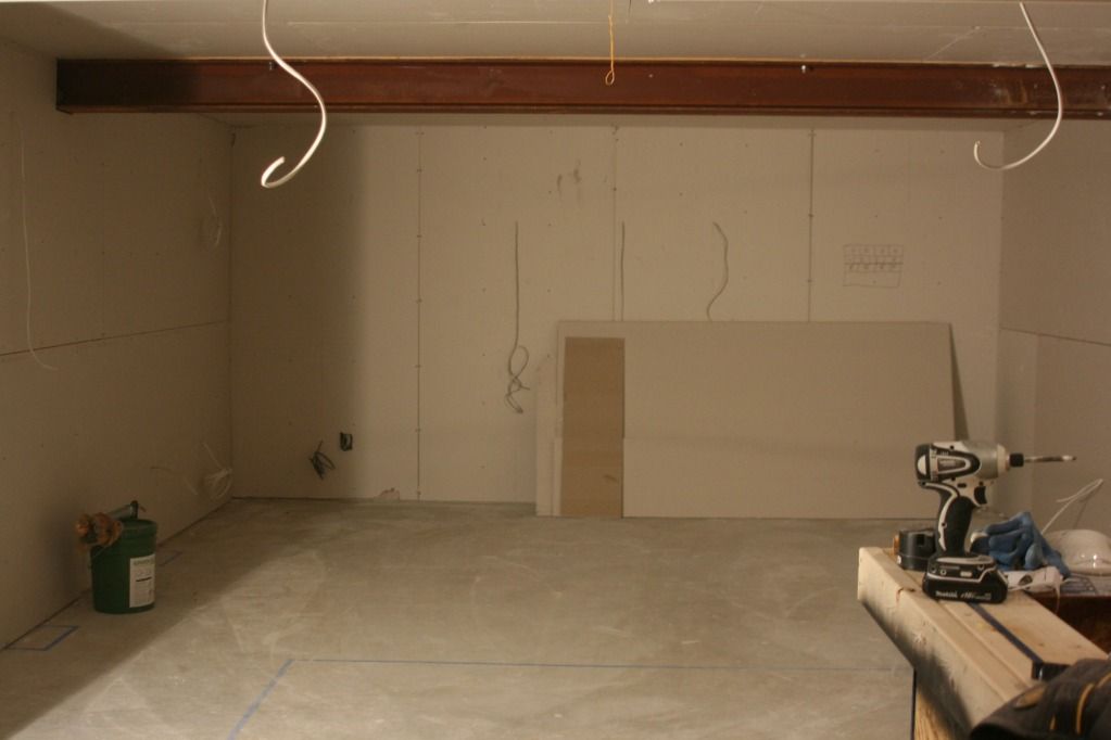

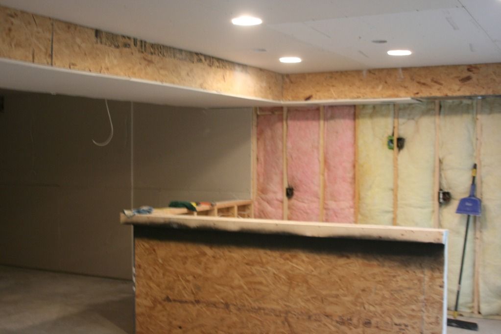

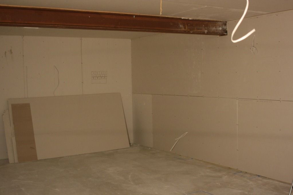

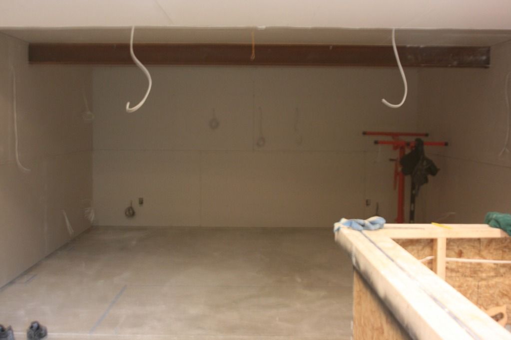

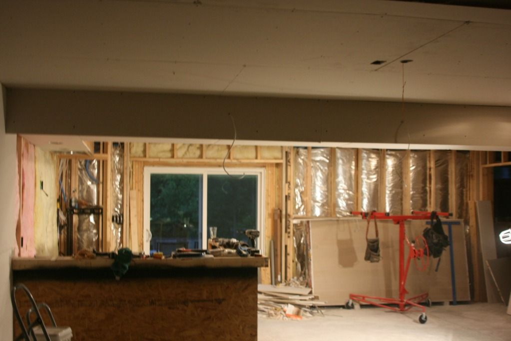

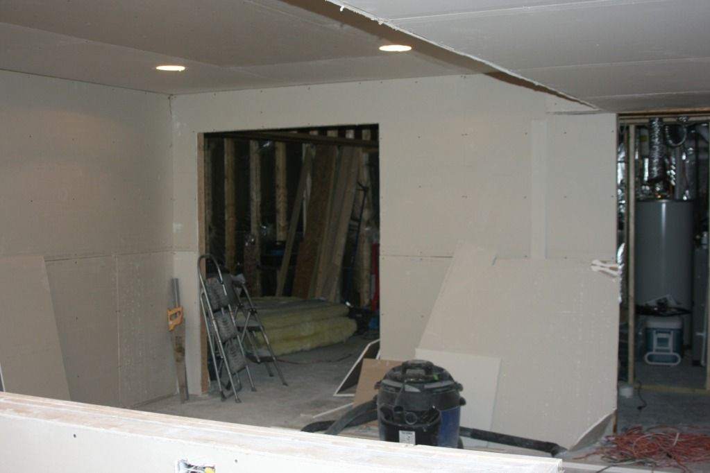

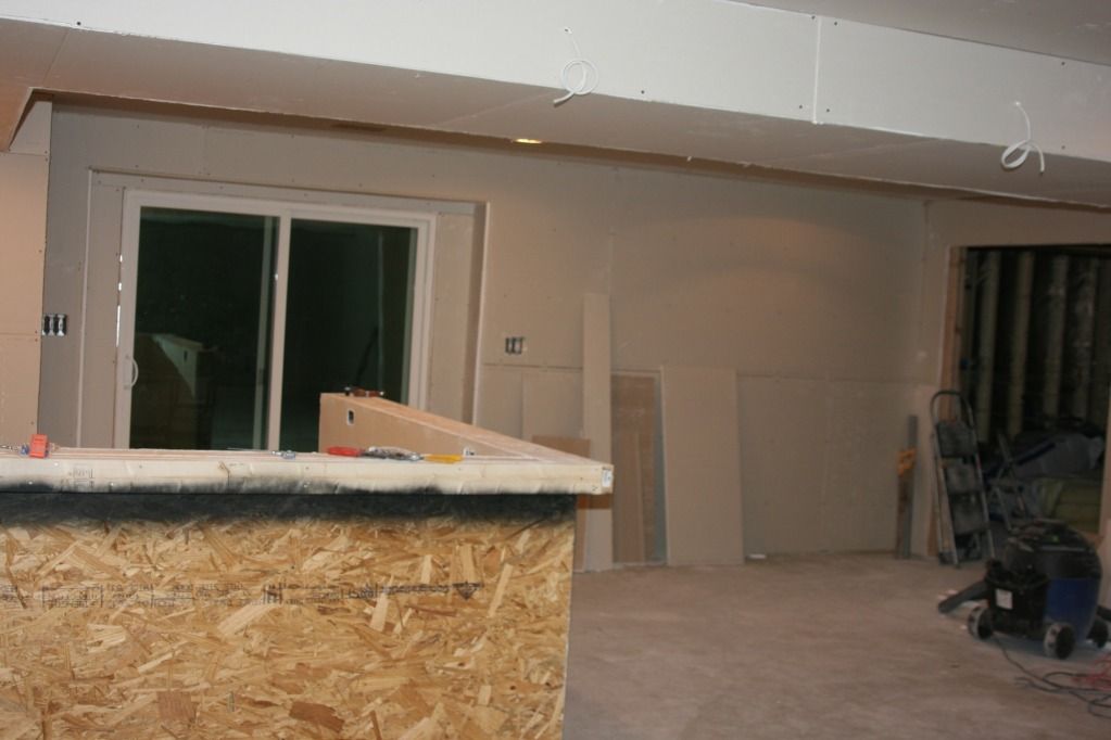

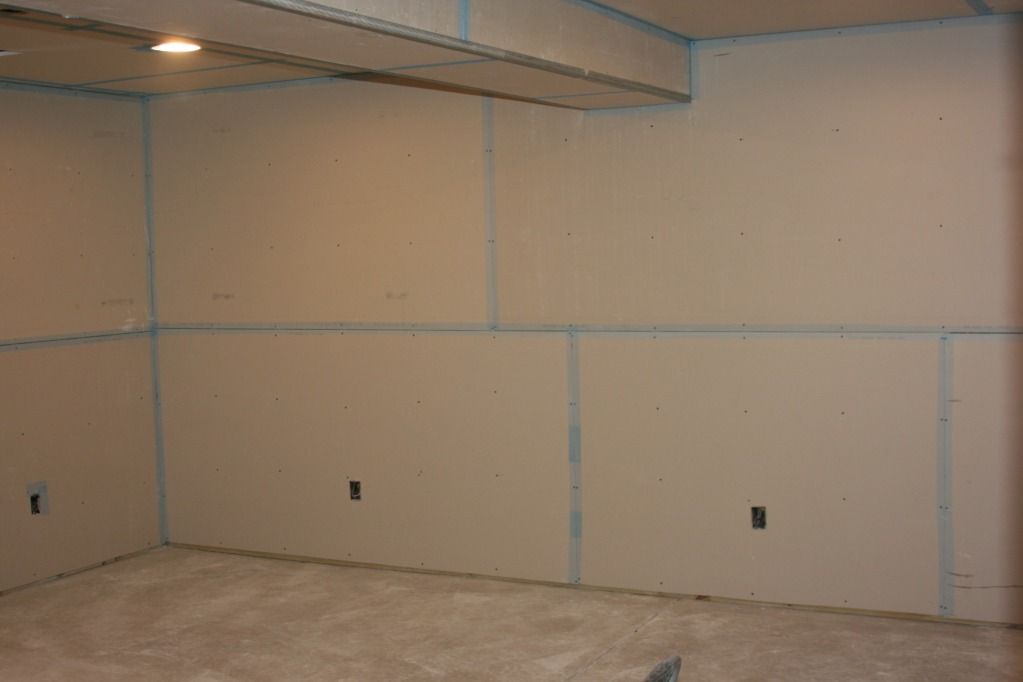

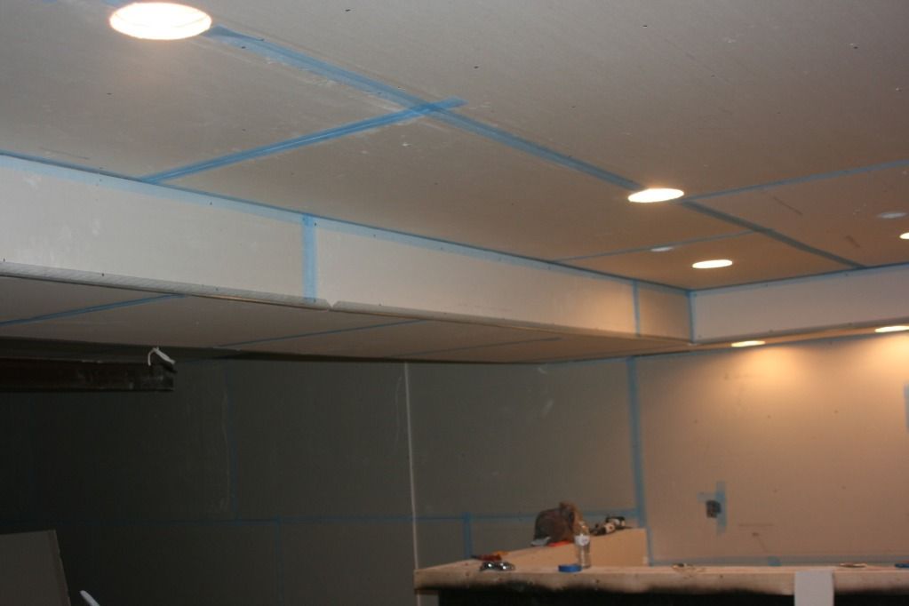

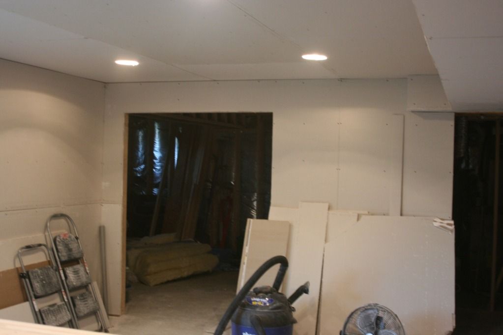

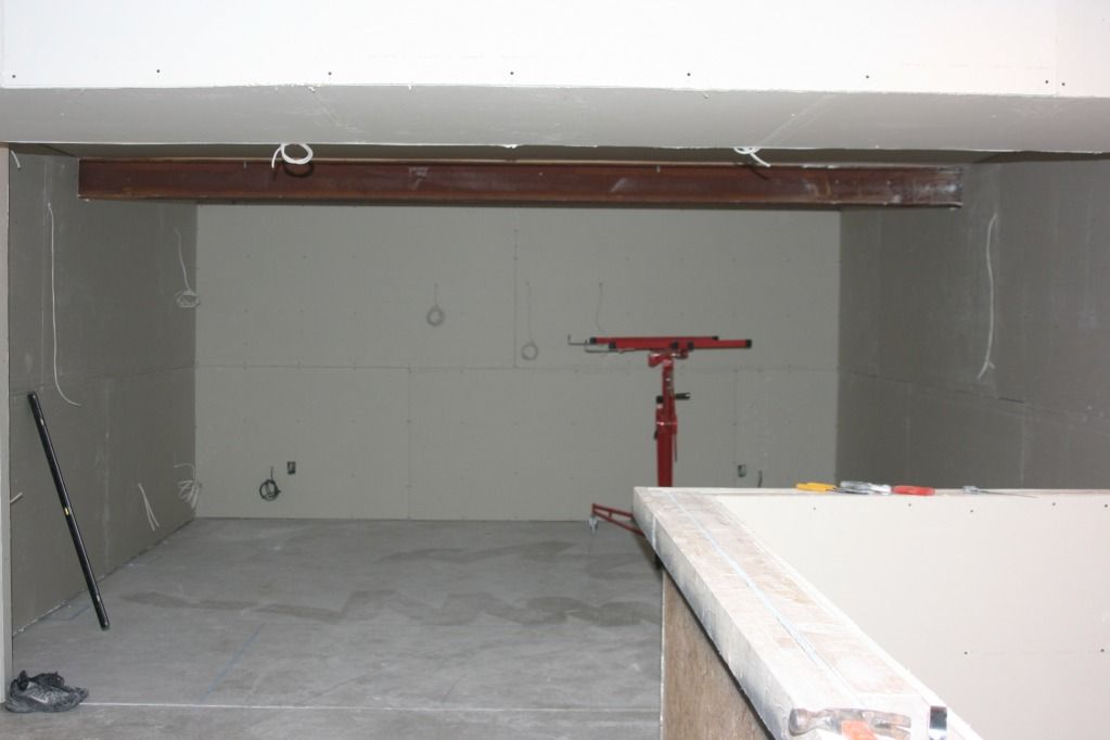

spent another eight hours working today ...... my body is hurting all over but it is well worth it
still need to finish behind the bar and the bulk head

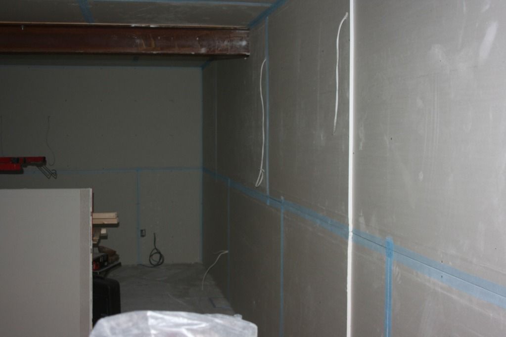

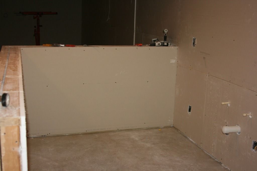

the theater are now has two layer of drywall on all walls and ceiling
shot looking from bar area into theater and i was two tired to do the infamous tape on wall for where the screen will be smile.gif
from the bar area looking towards the game room .... left the lights off there because it is the tool storage room at the moment
all the speaker wire and also can see the conduit running into the equipment closet

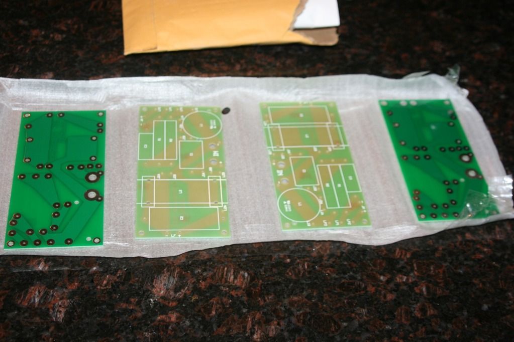

received crossover boards, will be building the econowave for my l/c/r's

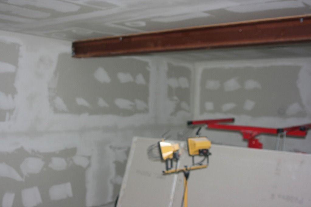

not much to report .... this weekend finished all the rest of the drywall, i have a drywall guy coming out tomorrow night to look at the job for mudding and taping...he came highly recommend from a contractor friend ... spoke with him a little today and he has been doing this for 30 years and seems very picky on the tools and supplies he uses like he only the blue mess tape because it is two inches wide and only likes a certain kind of corner bead ext....
also have hvac guys coming up out friday to finish there stuff bathroom fan they are using a quite fan and they also bringing out and extra one for the equipment room...
will post some pics soon right now everything is just drywall boring!!!
so glad to be done with the messy drywall ...... i feel like it has taken me forever to get to this point i think i have seen big finish two projects in the amount of time it has taken me to get to this stage...

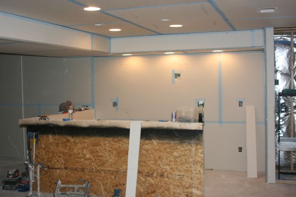

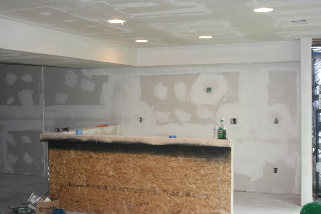

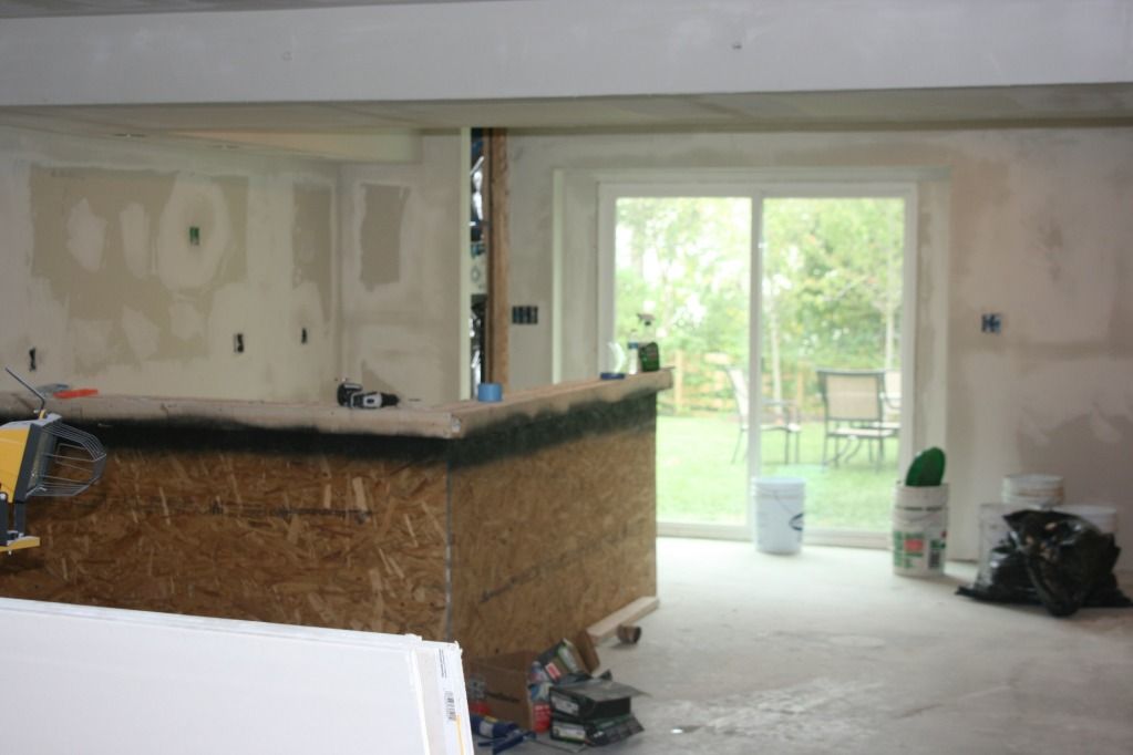

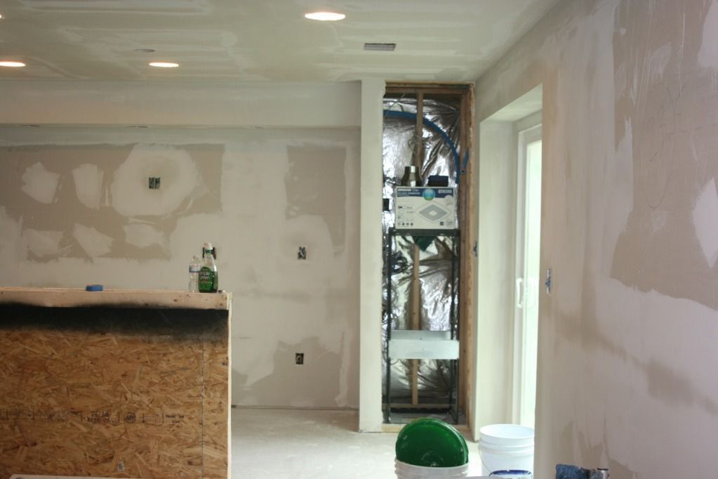

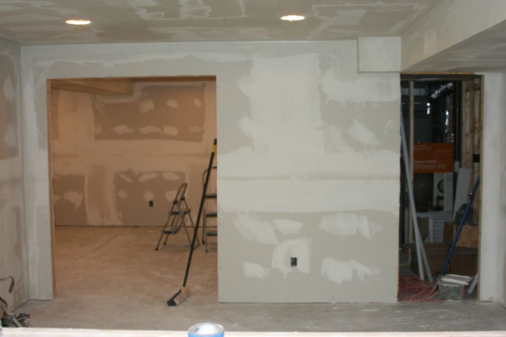

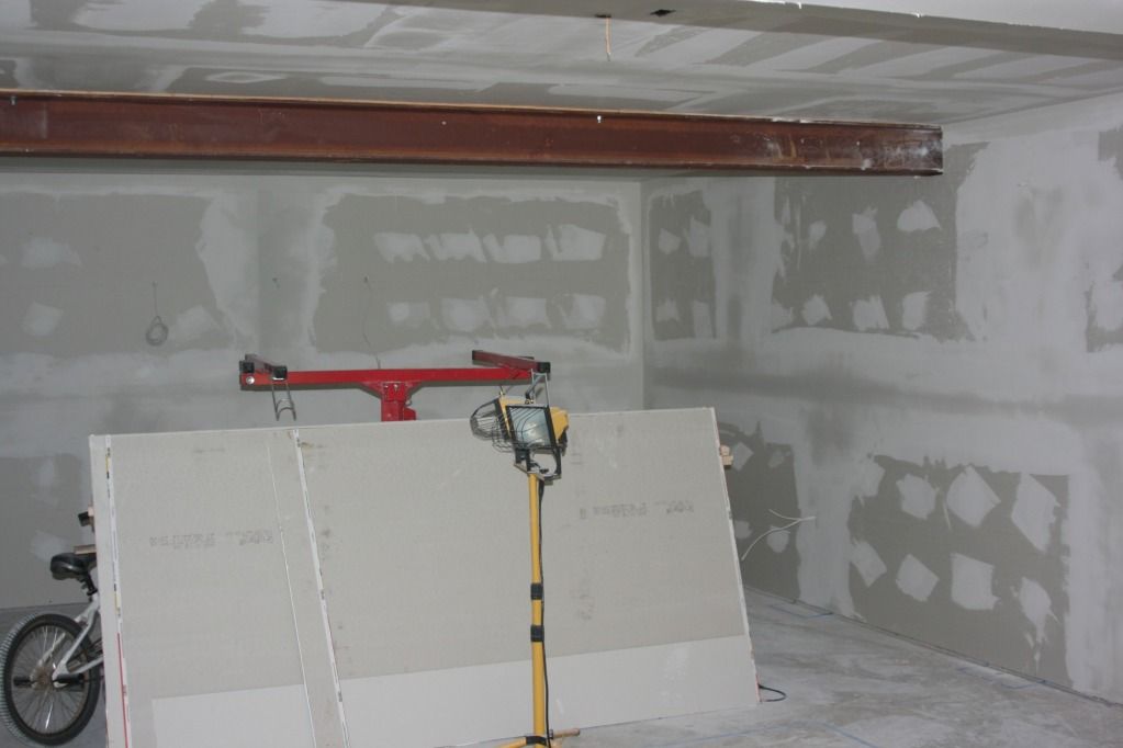

drywall guy started tonight
got the all corner beed and tapeing .... he uses the wire mesh corner beed says it makes a stronger corner
bar area and theater area to the left
looking into the theater area
looking into game room
bar area and equipment area
inside the game room

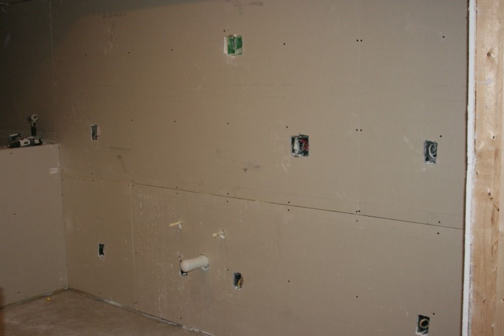

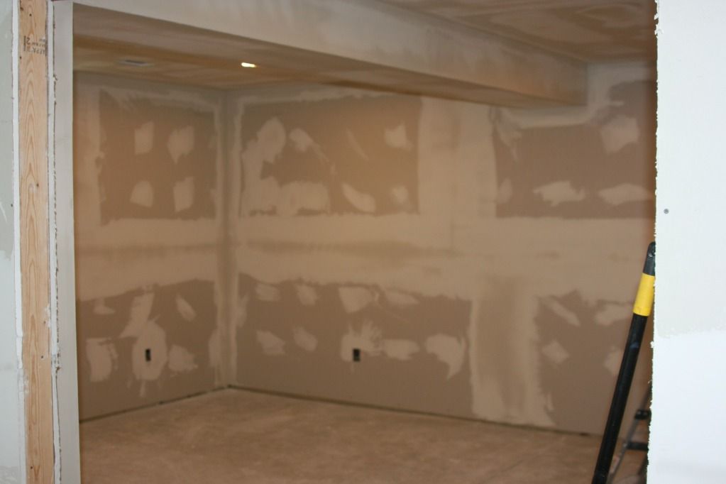

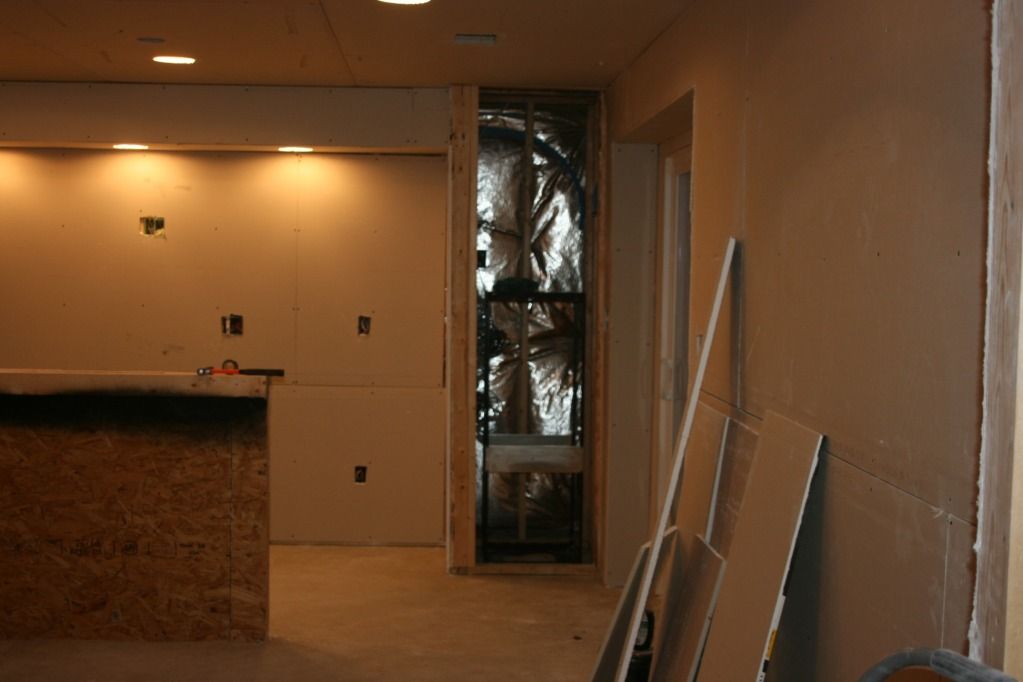

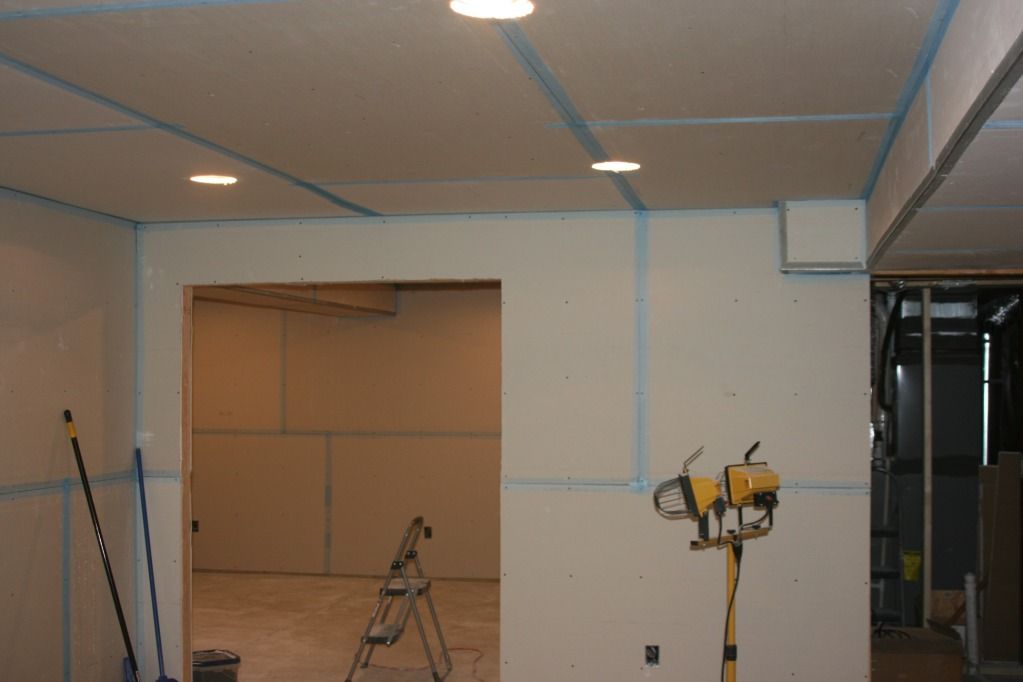

drywall are almost done just have to do a little sanding and then should be ready for primer
very happy with there work all the lines are so tight and crisp and very square they did not skimp any where
as in previous post they used the same corner beed you would normally use for plaster walls and blue mess tape because it is wider
theater area
bar area and equipment closet
game room

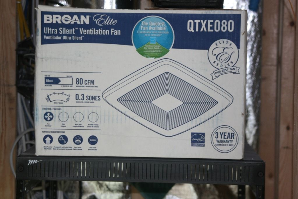

fan for equipment ...put one of these in the bathroom also ...turned it on and swear i had to put my hand up in to make sure it was on!!! .3 sones

Originally Posted by flyjpilot View Post
Looking good so far. Keep up the good work.
thanks
drywall guys showed up tonight and started sanding ....looks like a coke factory blew up ..... looks like this weekend will be serious clean up before priming the walls

When my basement was being sanded I put a big fan in a window blowing out and opened a window on the opposite side of the basement. It did a pretty good job of clearing the air. But I had to wash the screen.
if only i had a full size window ...we did put a fan at the sliding glass door that helped ..... i am curious what did you do to get the floor clean again so when finish work starts your not tracking white foot prints every where..... shop vac is not gonna get the job done
